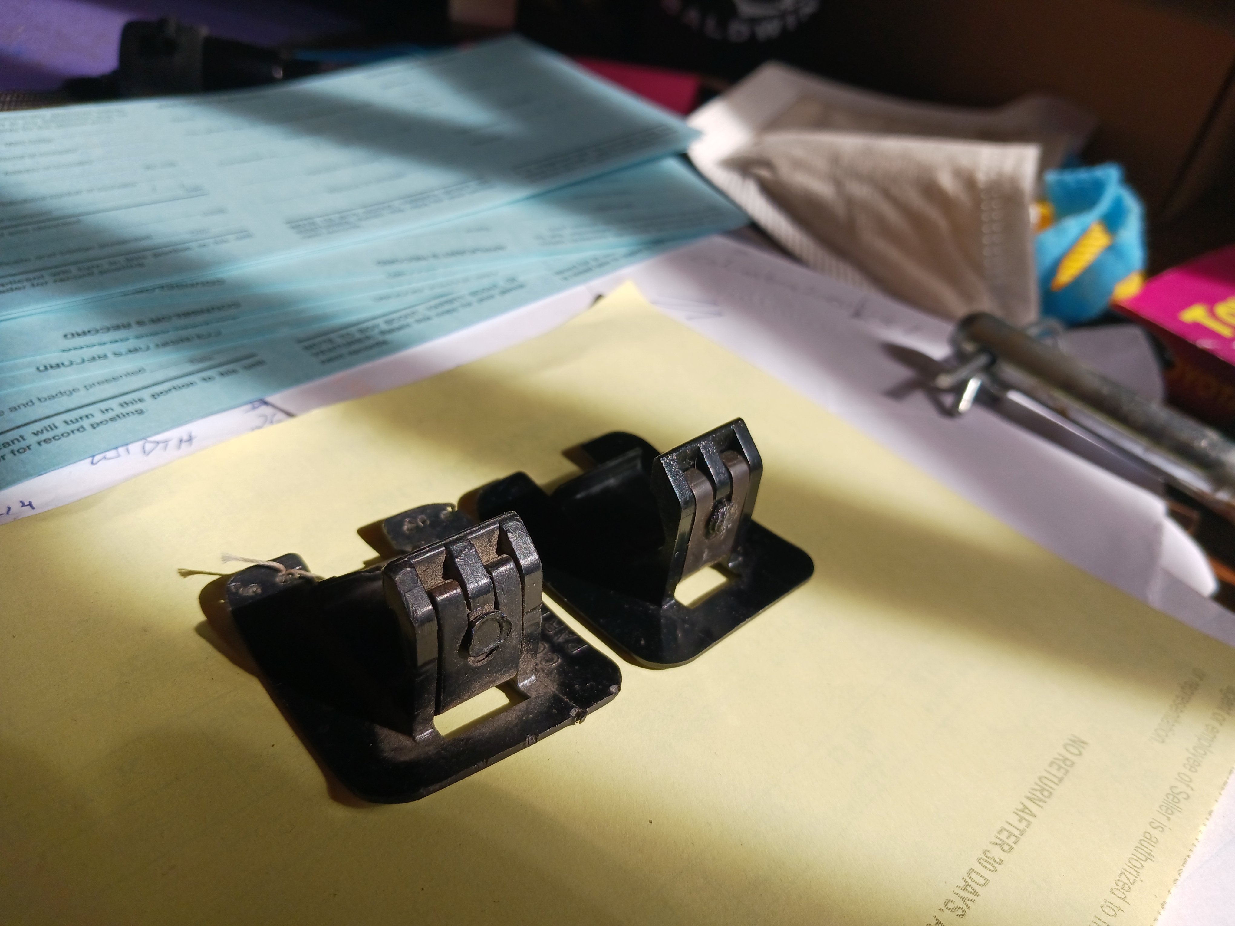

I too have found it nearly impossible to get the new style clips that come on the reproduced boots to clip on like the original clips. I also recently bought a repro Legendary boot. I've considered using some heat from a hair dryer but it has gone to the bottom of the list of things I have to do on my cars. I have a bunch of new clips like the originals (with the metal spring on back) and considered taking the new boot to an upholstery shop to have the original clips replace the plastic ones but again, not a rush item. Please keep us informed if you find an easy solution that works. In my photo, original clip on left and an exact repro on right - the clips in the Legendary cover does not have the metal spring and is thicker.

I have some original clips as well. I wanted to see if Legendary would make me a boot cover using my original clips. Like Terry - it is low on the list of things I need to do to the car at the moment.

I don't think there is an aftermarket clip with the metal springs. All of the aftermarket clips are just plastic
I haven’t found any original type clips either. Appears to be only plastic clips available and they do not fit as claimed.🌴
After reading @terrywalker ’s post of him having new clips, I assumed these were reproductions vs an NOS stash.

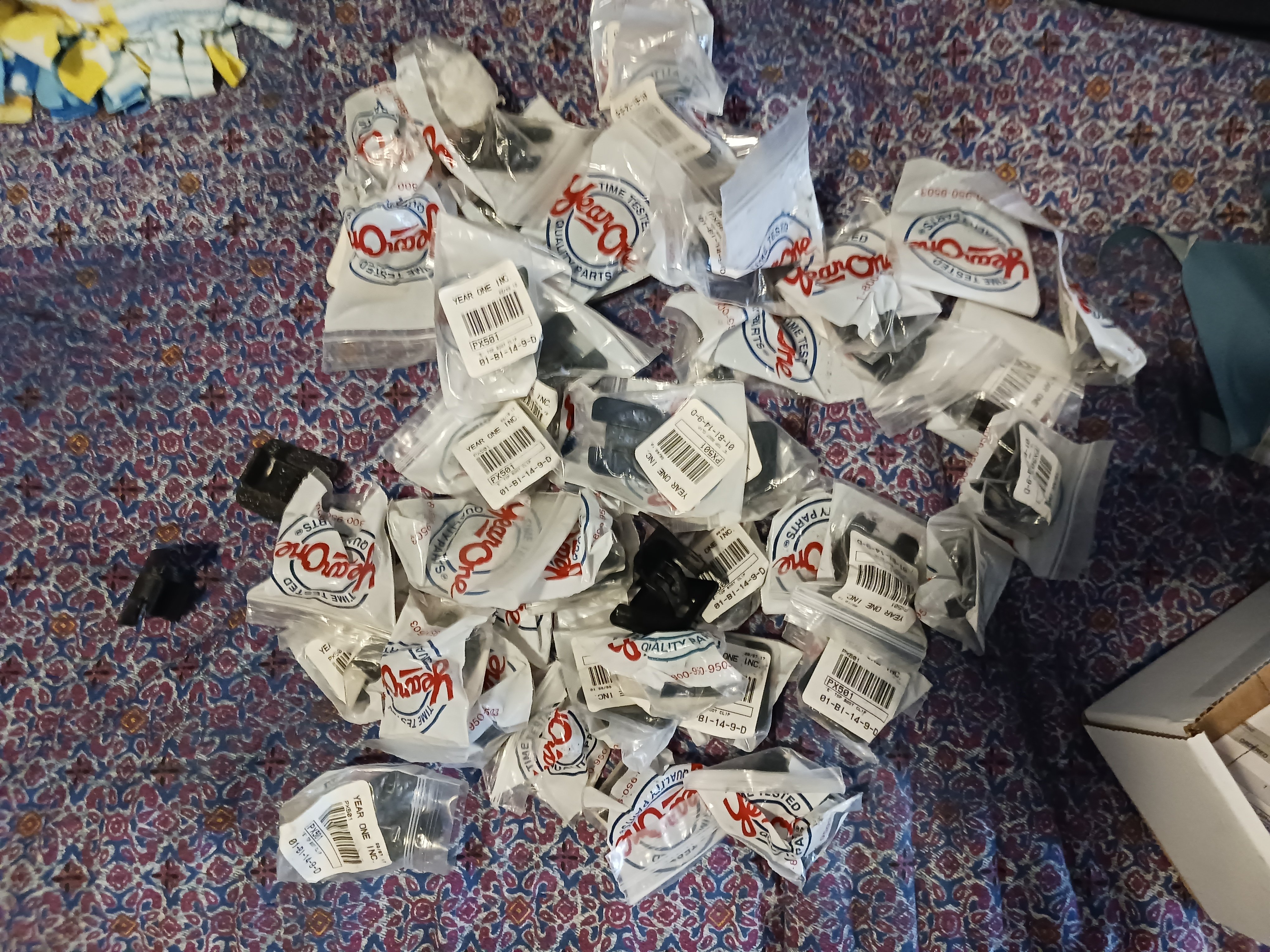

Sorry. I should have clarified that I bought those metal spring type clips at least 25+ years ago through Year One. I bought them to replace broken ones in my original boot and to have someone make and put them in a new boot. A friend use to do car and boat upholstery but he's retired. I was going to have him install them for me but I procrastinated.

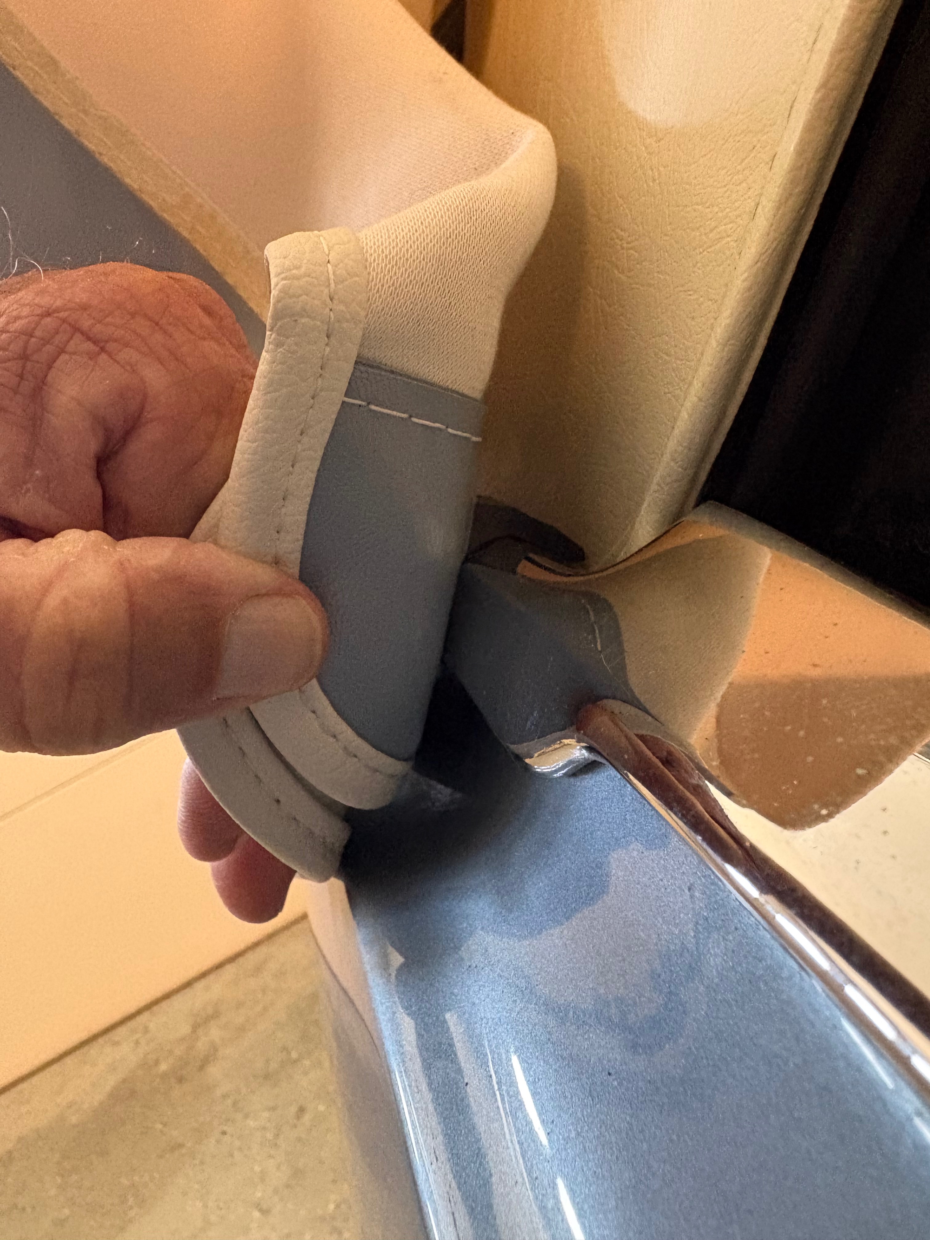

Okay, I broke out the heat gun and heated a clip up. I didn’t go overboard with the heat just enough where it felt hot to the touch. Pressed it on the molding it snapped into place. I’m very pleased that it worked. Now I’m going to leave the clip on for a few hours. Then remove and replace it a few times to ensure it functions properly. Then I will do the other 21 Clips. Again I will report back with final results.🌴

Nice stash!
Wish I had bought some back then.

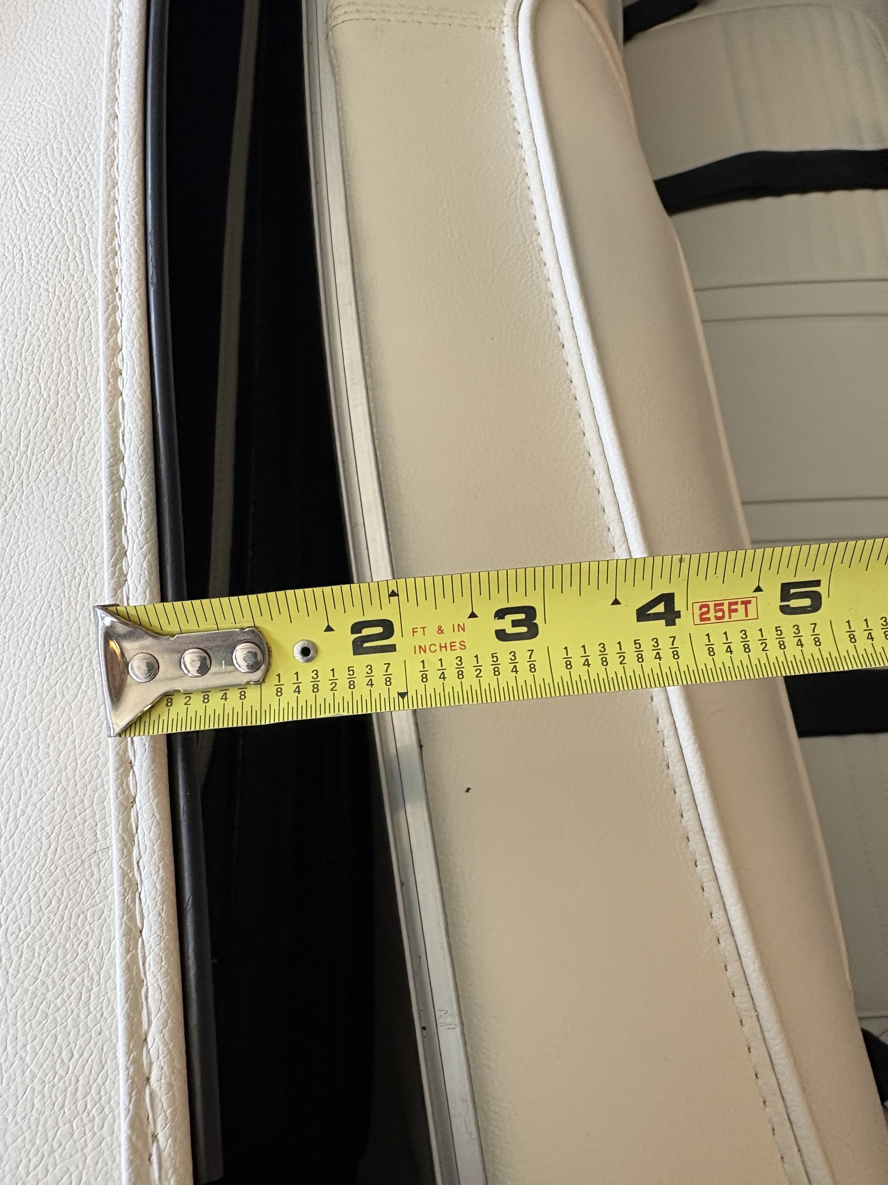

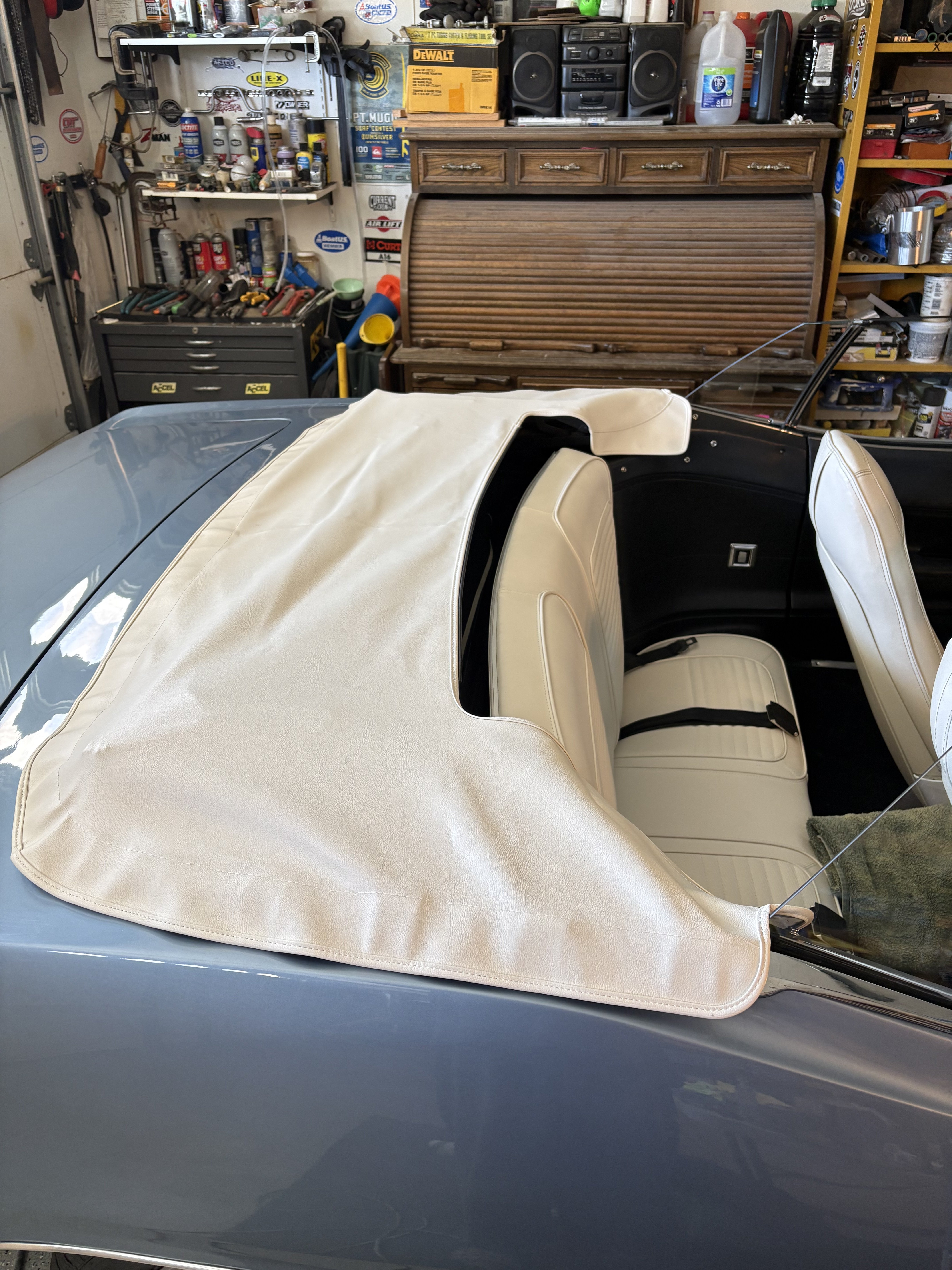

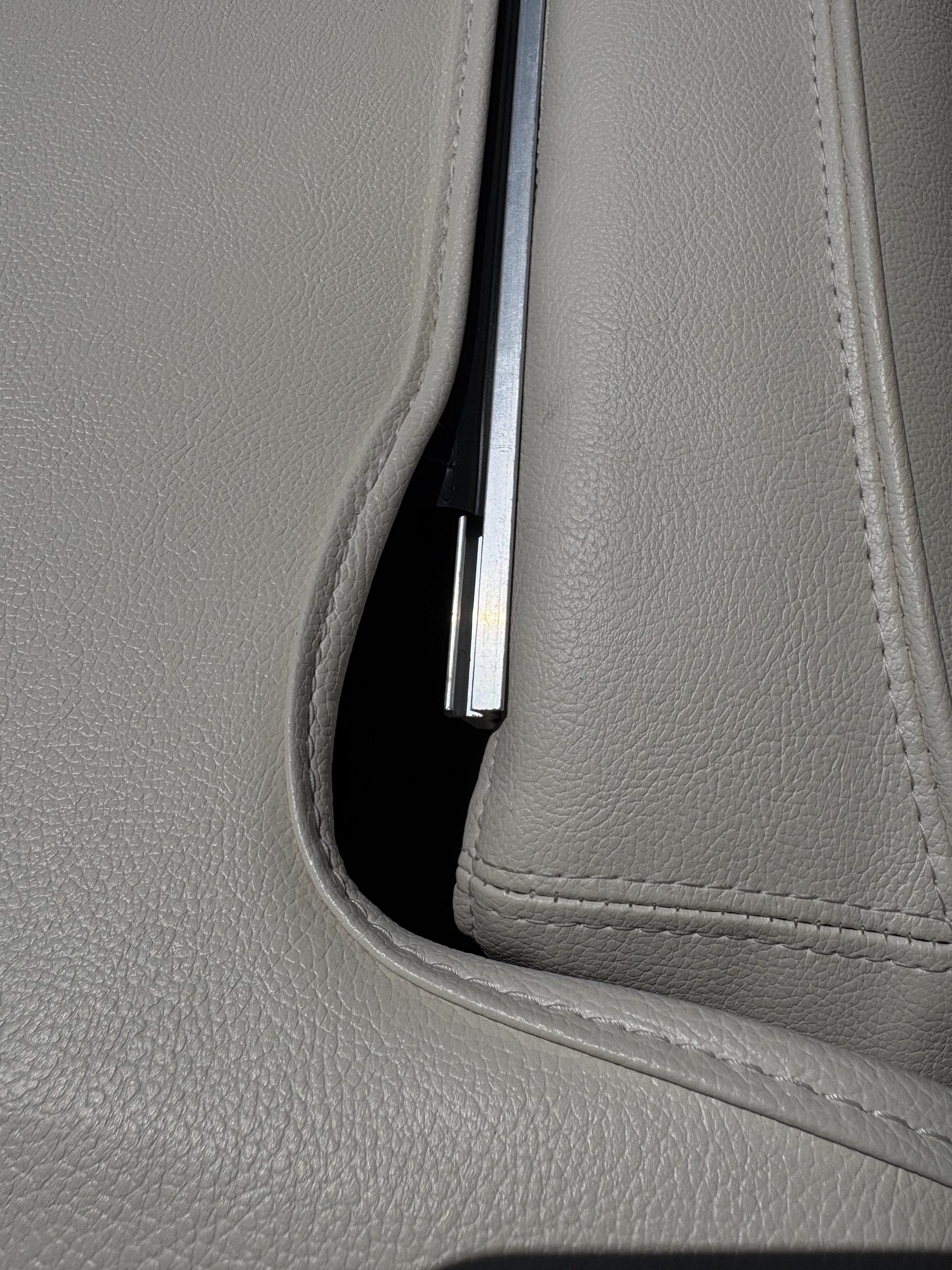

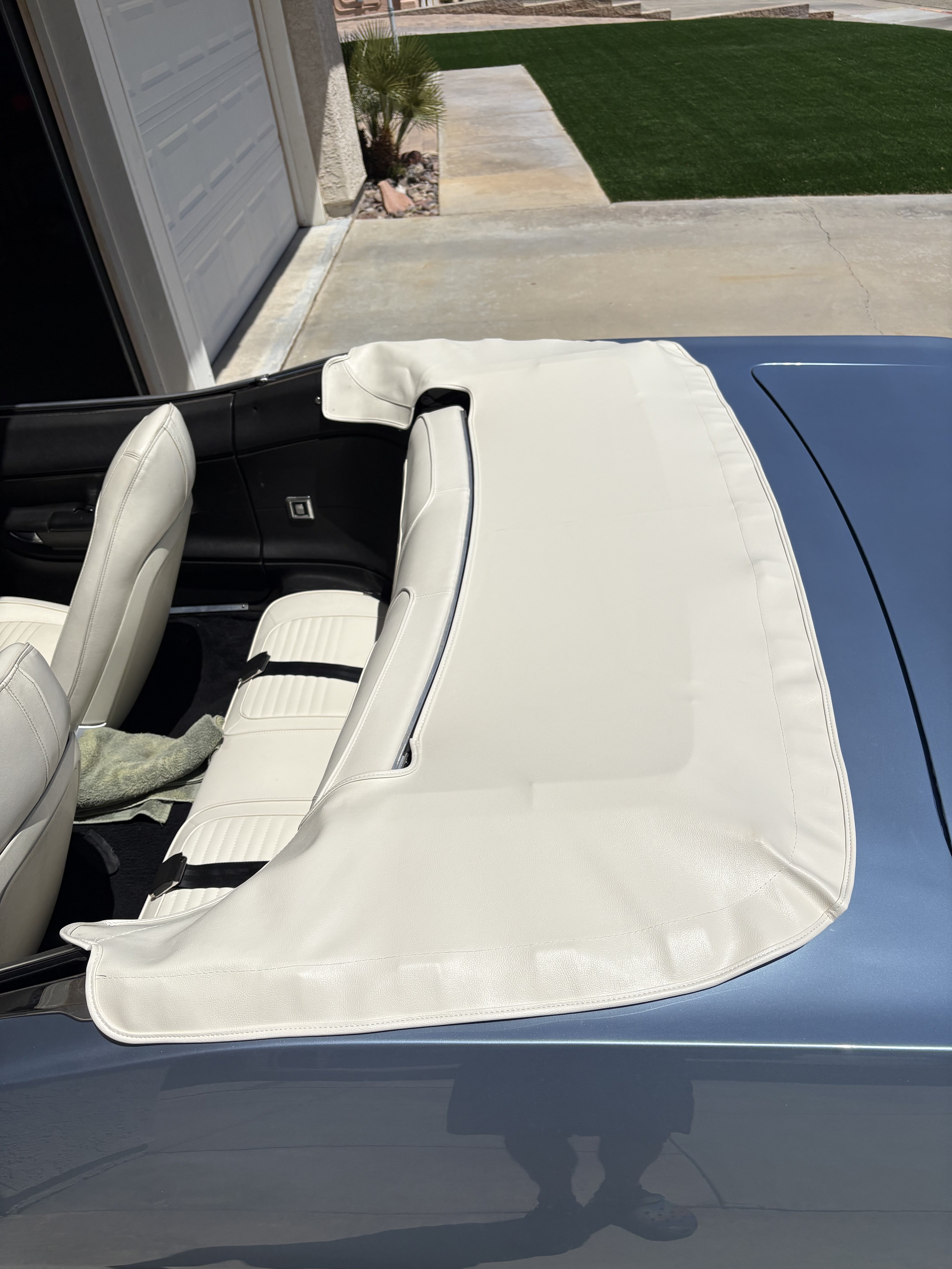

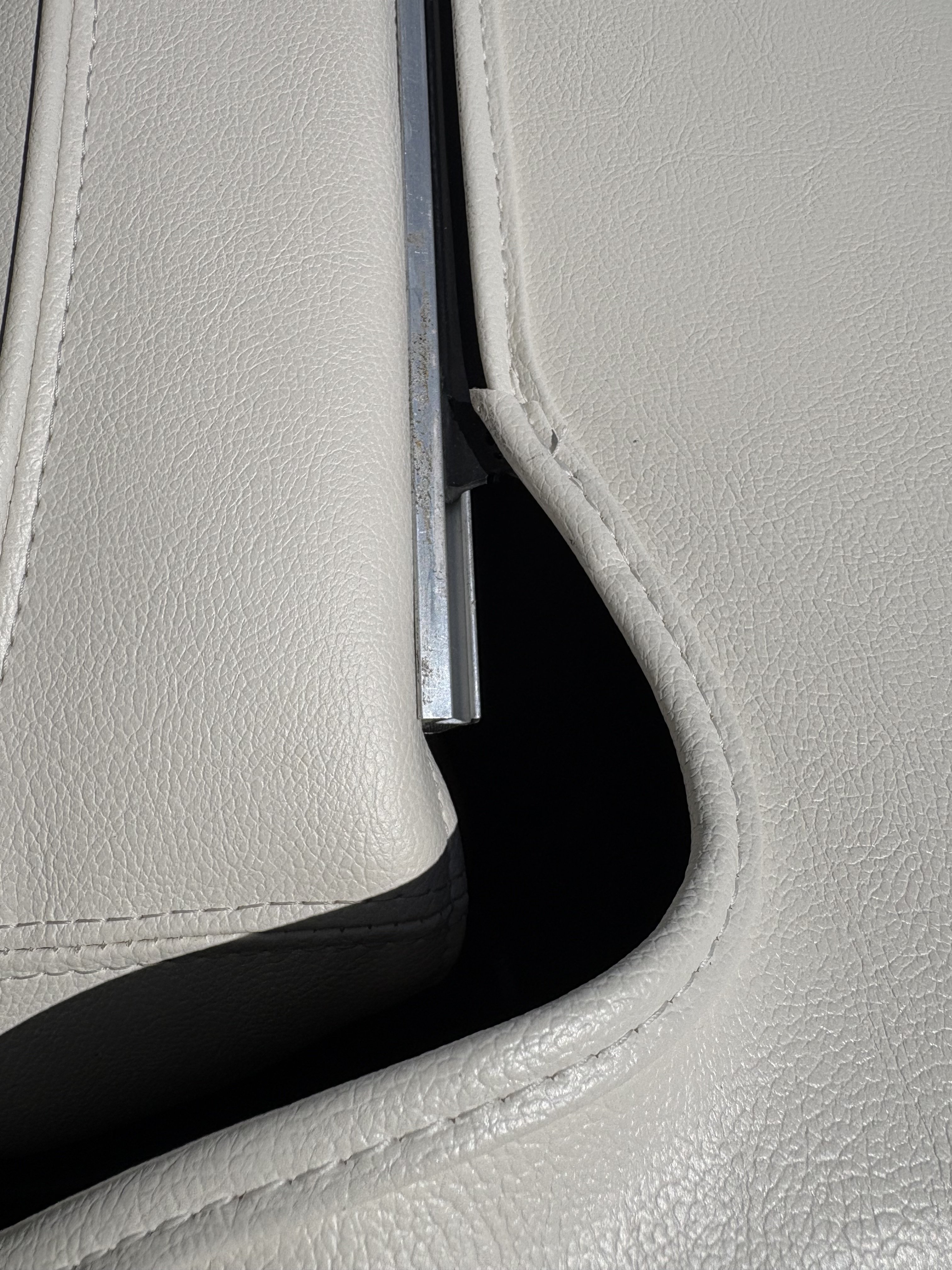

Okay, the Clip functioned. So I did another 21 Clips. When using the heat gun about 8 seconds of heat will do the job. Anymore the upholstery around the Clip heats up and the Clip will pop out from the boot itself (Don't ask me how I know). Now after getting all the boot Clips attached. The slide in attachment that goes across the back seat is about two inches short (“Come On Legendary, Really”?). So once again I’m stumped! Will the boot upholstery stretch? It’s drum tight as it is, another head scratcher. Any suggestions welcome🌴

Ok, that's the problem I had with the Legendary boot cover in my Challenger. If I put the clips on the well trim, the cover was way too tight to reach the slide in track for the welt. If I have the welt in the track, I can't stretch the boot enough to get the clips on the well trim. I'm waiting for a really hot sunny day to put the car out in the sun to see if the boot cover will stretch. Good to know that some heat on the clips helps. I'm nervous about using a heat gun, so I may first try a hair blow dryer. I still have the original boot cover that fits.

I tried to put the back of the seat attachment on first. There was not enough slack to get a clip anywhere near the molding. I’m going to let it stretch in place for a few days while I try to figure this issue out. Until then maybe someone can provide a trick to the trade to rectify this issue. 🌴

Exactly! However, I’m skeptical about the vinyl stretching 2 inches across the back seat. Fingers crossed that it will stretch out enough on a hot day. Keep me posted on your progress. 🌴
