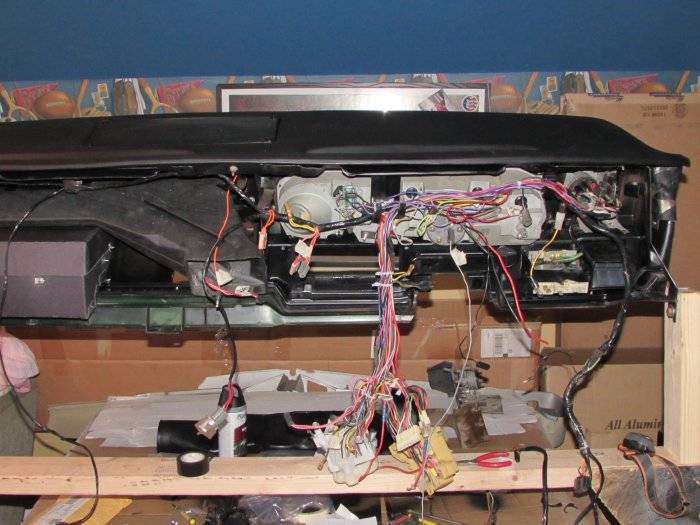

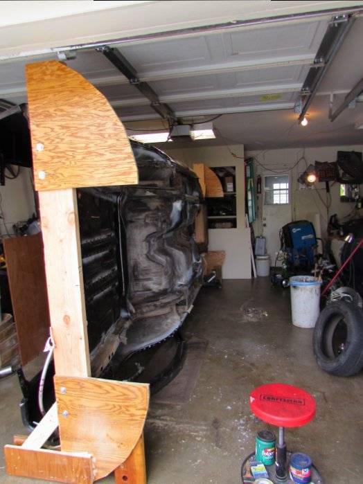

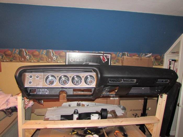

Couple of pics of my dash. It is a 72-74 rally dash into my 71 Barracuda.[/ATTACH]

This is great info guys. Thanks so much. I'm almost finished with my heater box and will be starting to tear down my dash, and steering column for repainting soon. Love your dash stand, that's a great idea. I'm sure I will have a few more questions along the way

Cool, yeah the dash stand is really helpful and it only took an hour to make with some lumber laying around. Trying to roll it around on a table is a pain in the rear. If you have any questions, let me know. Another good tip is print out the largest wiring diagram you can and put it on a piece of cardboard. I printed one that was 20x20.
Thought you might like my other wooden creation.
