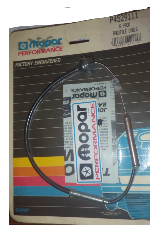

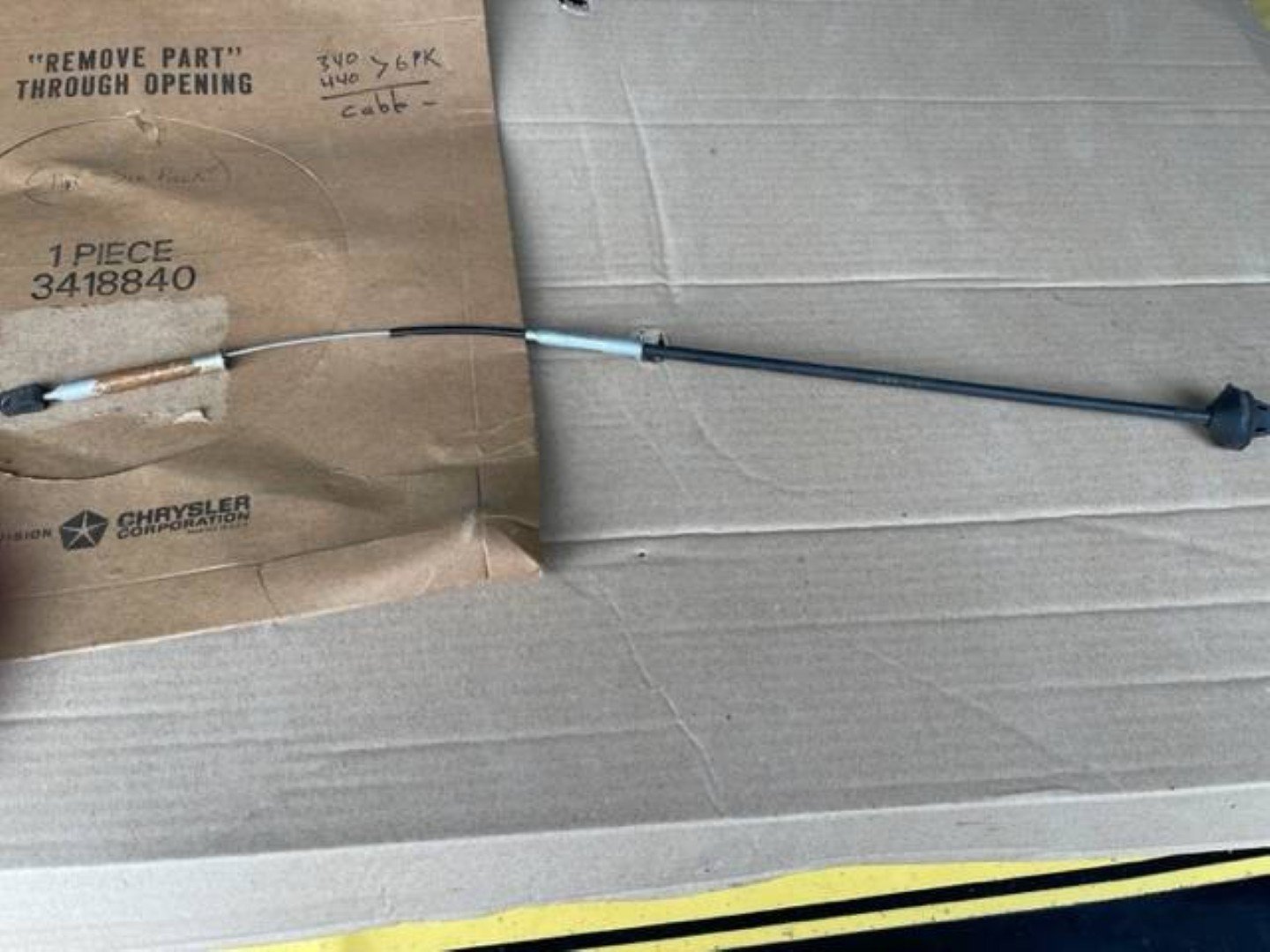

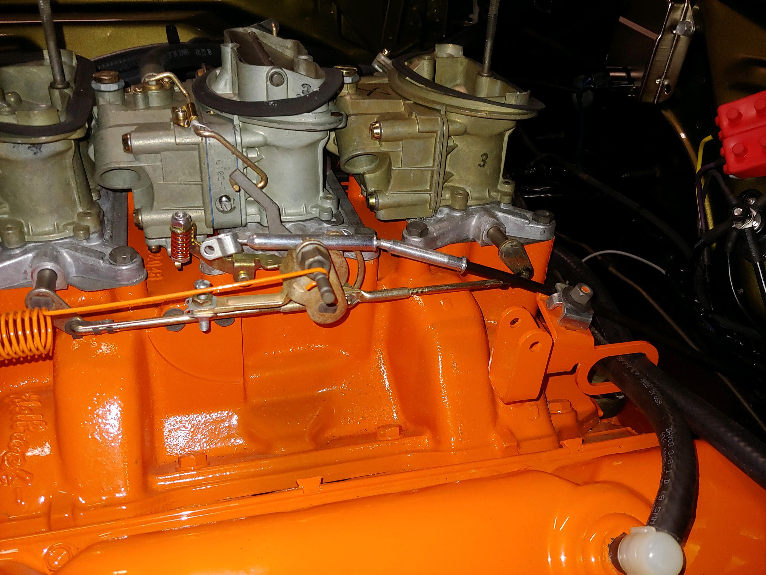

I'm finding different info (don't have a shop manual yet) on the length of throttle cable for 71 Chall 440-6. Does anyone know what the stock length should be? Also, a good source? I'm seeing as as much as $160!!! Some as low as $47. Thanks in advance for any suggestions!

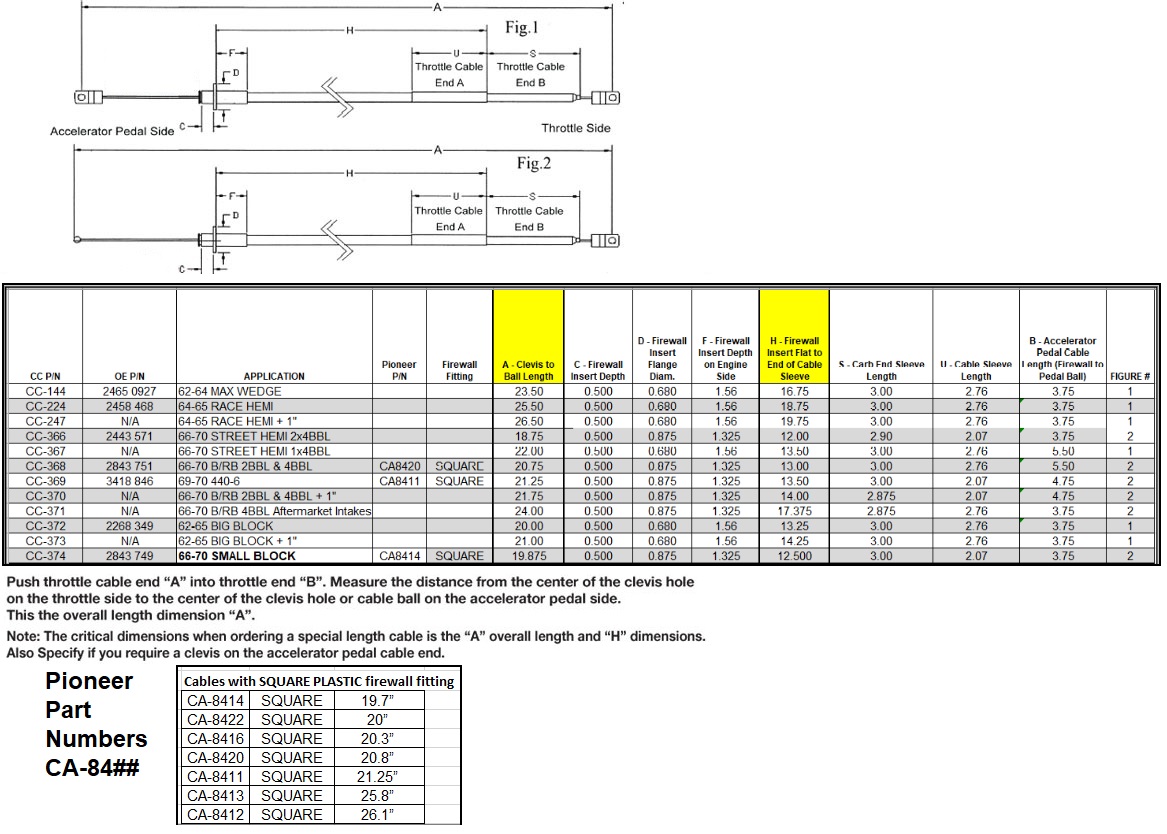

The stock manuals don't tell you the lengths of the throttle cables, sadly.

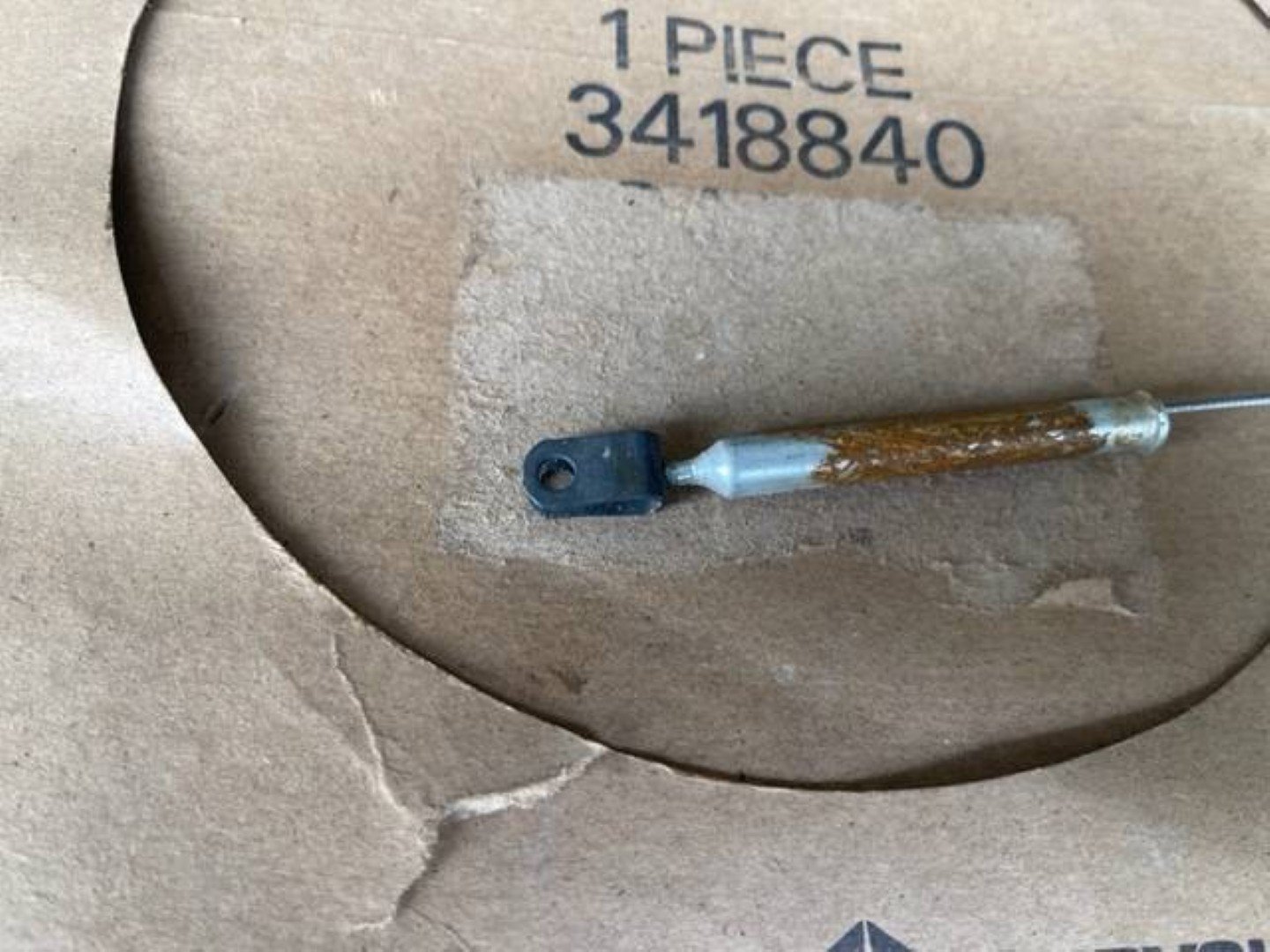

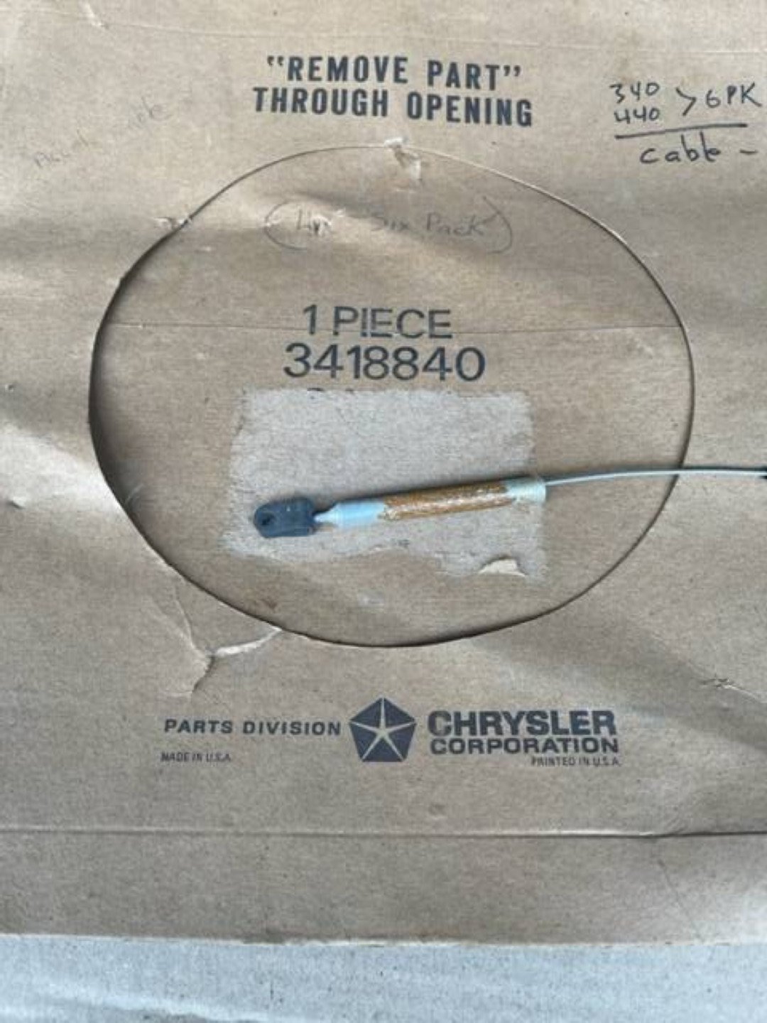

but the parts book shows the 340-6 and the 440-6 use the same throttle cable.
google AI says its 21.5 inches, but it's unclear at which points on the cable this is measured.
