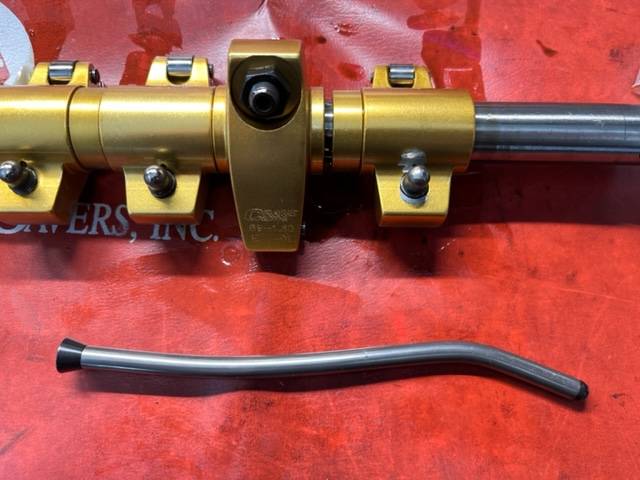

Hi everyone,
I am trying to find two pushrods and a rocker arm. They were made by crane. The pushrod number is CRN-69690-16 and the rocker arm is CRN-69791-1. At the very least I need is one pushrod. Is there anyone that could make a pushrod?

Smith Bros in Bend Oregon , great service maybe get 3 so you have spares !!

There are some possibilities ,
If the valve springs are weak the valve train can get loose & hammer back into contact
If a valve floats & hits a piston that can bend a pushrod .
A broken spring will cause that also .
A collapsed lifter can also cause clearance in the valve train .
It is worth doing a compression test & inspecting the springs closely .

First I would remove rockers from shaft.Keep in order for further investigation.did rocker seize up on shaft.Is there oil flow. valve guide seized?

Or overtightening the rocker shafts causing them to crush into an oval & & seizing a rocker

If every thing looks ok on top. pull the intake check lifter bore. maybe seized or over sized egg shape and hung up. Turn engine over by hand.look through push rod hole.or hold a push rod in place.see if lifter moves up and down freely.

I saw a 440 race engine , well built & a lot of $$ spent , destroyed simply because the rockers shafts were overtorqued , a rocker froze on a crushed / ovalled shaft , it was discolored from heat . This held the valve open , the piston hit the valve breaking it & the piston , the connecting rod cut the engine in 1/2 , all that was left was maybe 1 head although once the cam was cut in 1/2 those valves would be stuck open so I doubt it , the carb , intake , dist & timing chain !!
A very simple & costly mistake ...
