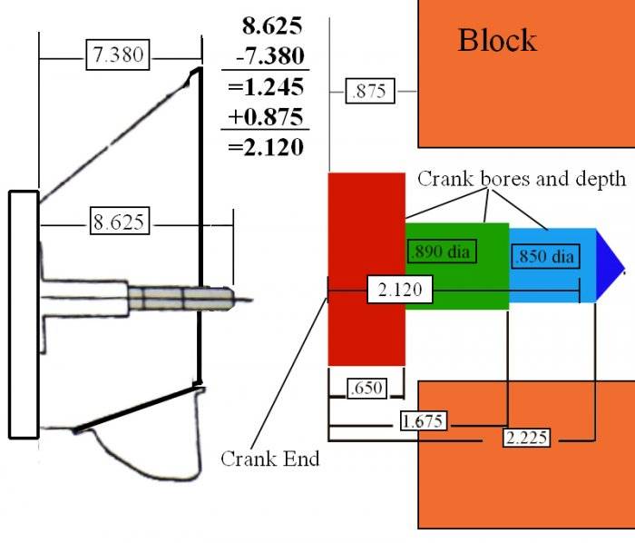

From a 440 crank I measured.
The depth was fine but the bushing diameter would need to be opened..............
