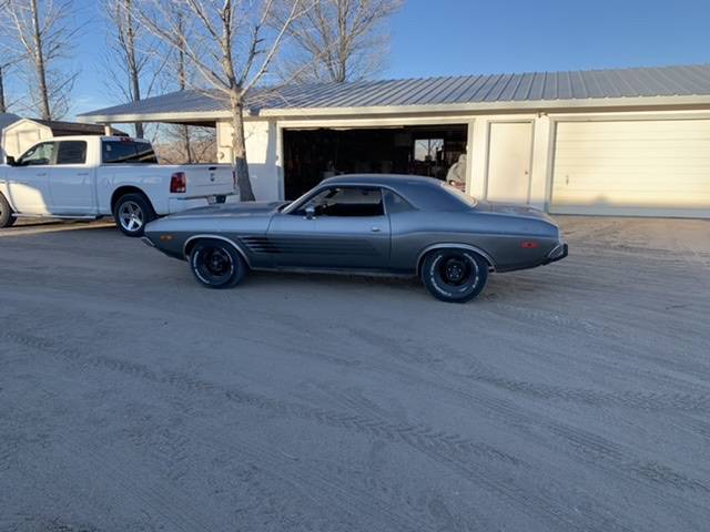

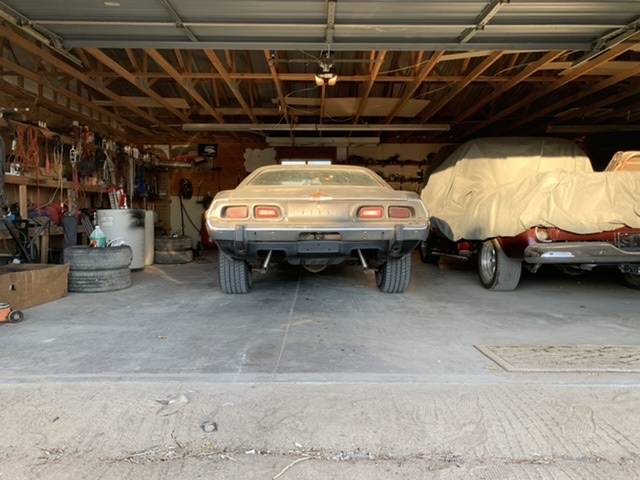

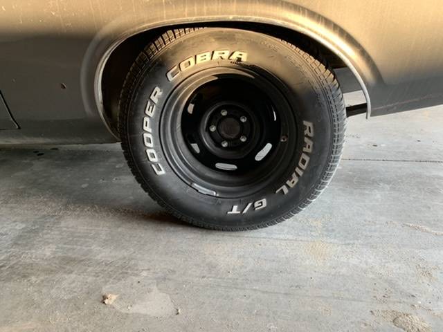

Hey Merlin,
Check out the post in the Tire & Rim forum by Big Al, dated 2/2/20. There’s a couple of photos of my Cuda and the description of the rims and tires, might give you some ideas.

I used the 15x8 cop wheels from summit racing with 275/60r15 on stock suspension and no mods
