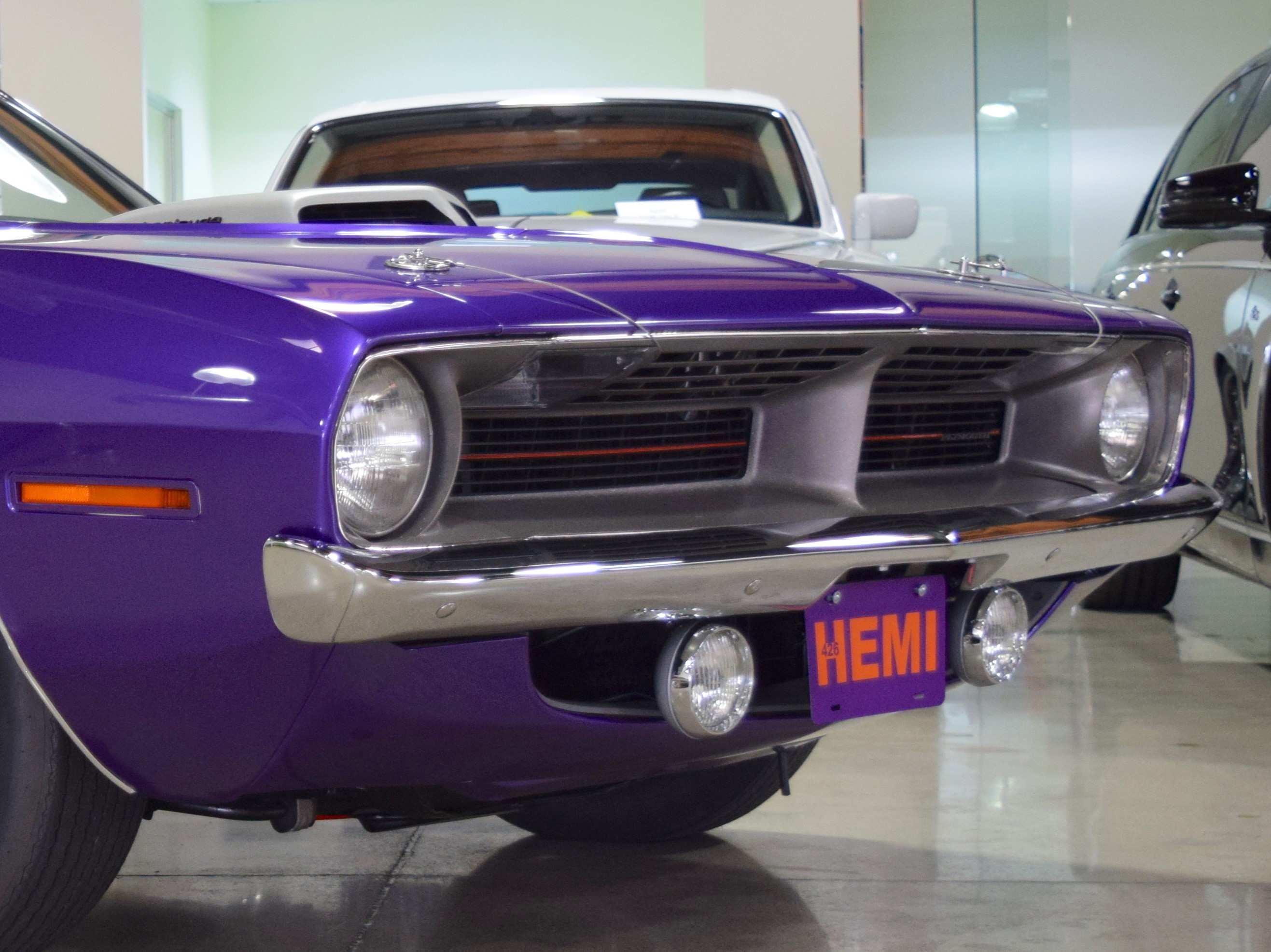

Random pic from the 'net;
thanks why didn;t i think of looking at pics on the web
got the bumper to fit perfect now with the ends kicked up a little the middle came down. i took my time alot of removing and massaging the brackets can;t wait for spring ..happy motoring everyone
