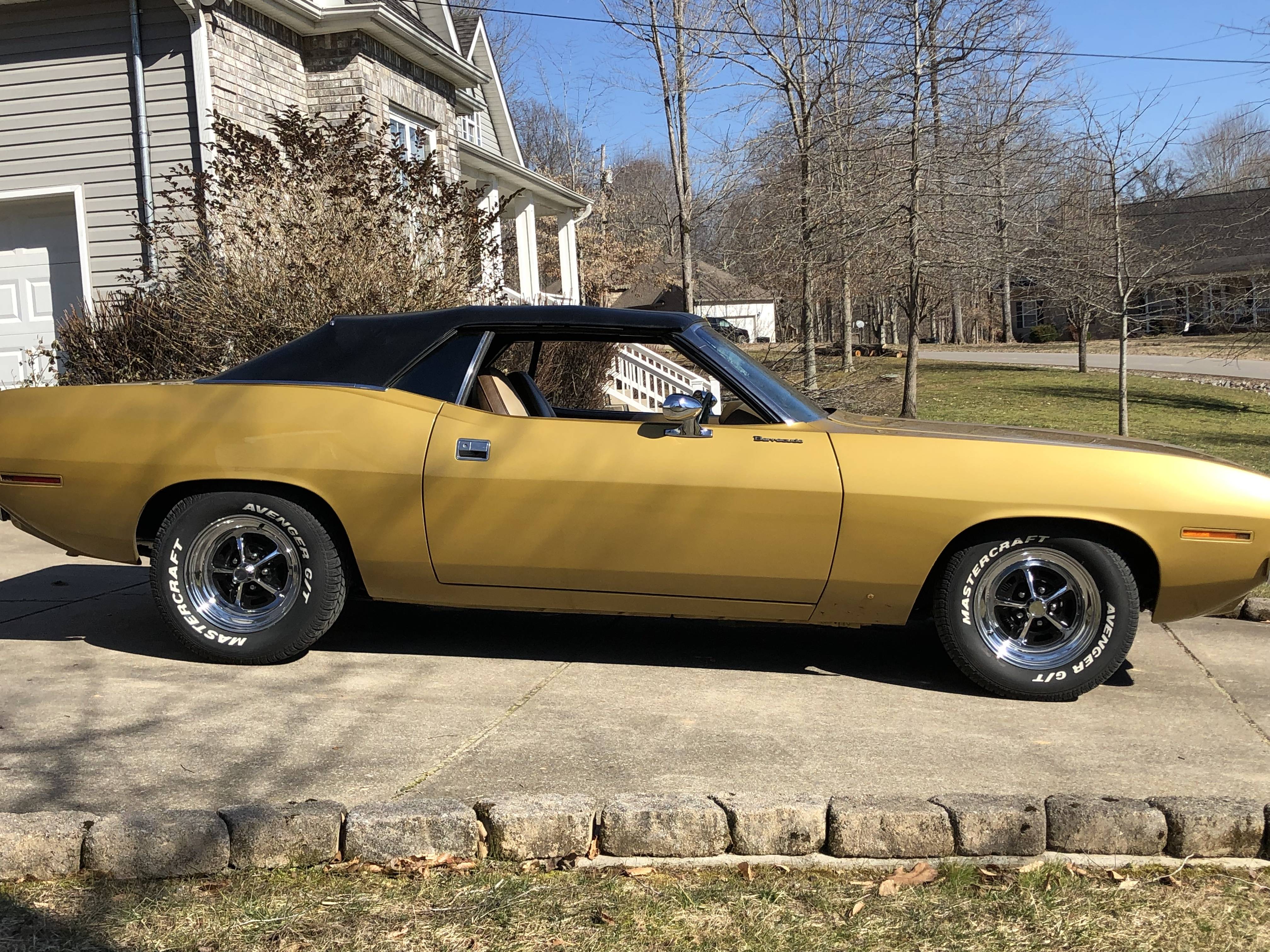

I just upgraded wheels on my 71 Barracuda. 245/60r15 up front and 255/60r15 in back. I could have got more tire in back but I only had 15x7 wheels. I was shooting for very similar diameter to avoid a raked look.

Personal preference, I would say. I think most would agree a non performance convertible like mine would be best with no rake. I think a rake only works on performance cars shooting for that 70s era street hot rod look.

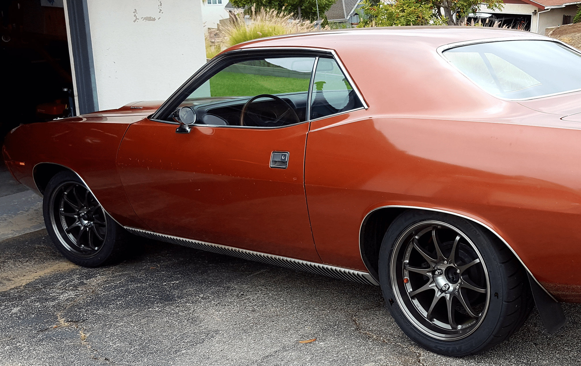

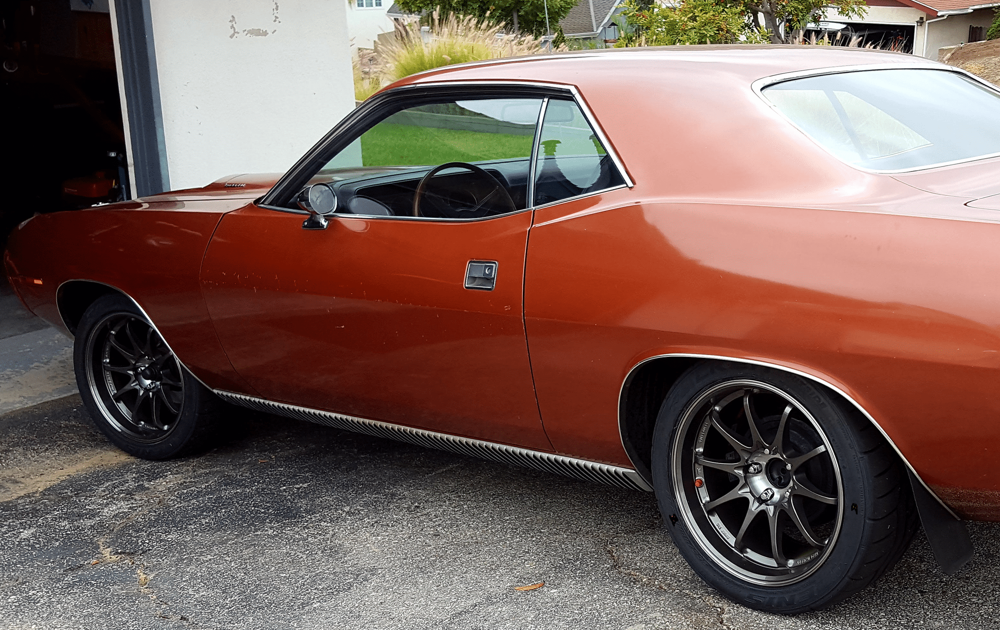

I am running 255 40 17 tires on all four corners on forged aluminum 17 x 9, +10 offset wheels. The 25" tire diameter helps for clearance on the front. A larger diameter tire of the same width would not clear when steering.

Volk Racing. Unfortunately, they discontinued the +10 offset in the model that I bought, just a few years ago.
Fortunately, I knew when I ordered that Volk eventually discontinues less popular offsets, so I bought six wheels right after they started offering a +10 offset.
