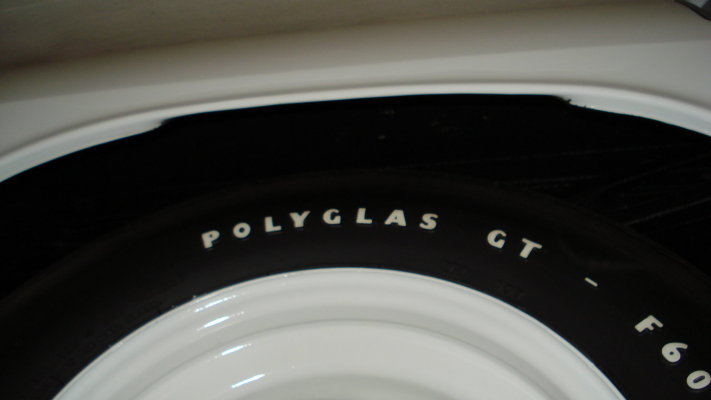

I understand hemicudas had the fenders rolled for the wider F60 tires. Does anyone have information what specifically was was done / pics?

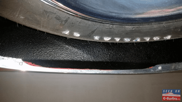

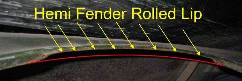

Factory rolled the lip like below. It is a crude process of leverage and pressure. Many people run the F60x15 PolyGlas GT tires with no clearance issues at the fender lip.
Crude or not, they are all done the same way and similar lengths.
I've not seen a different variation aside from the ones that non factory owners did to their fenders.

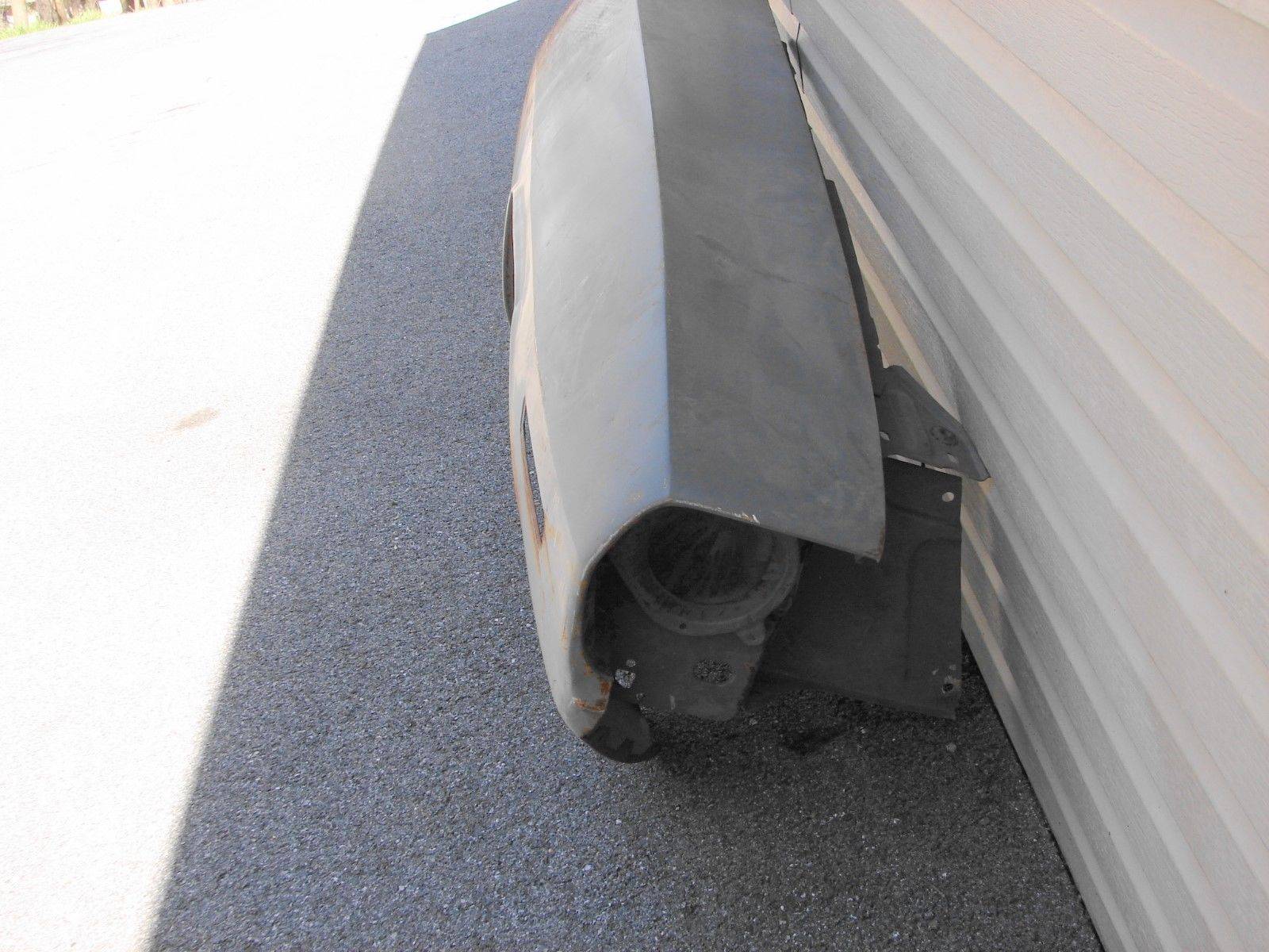

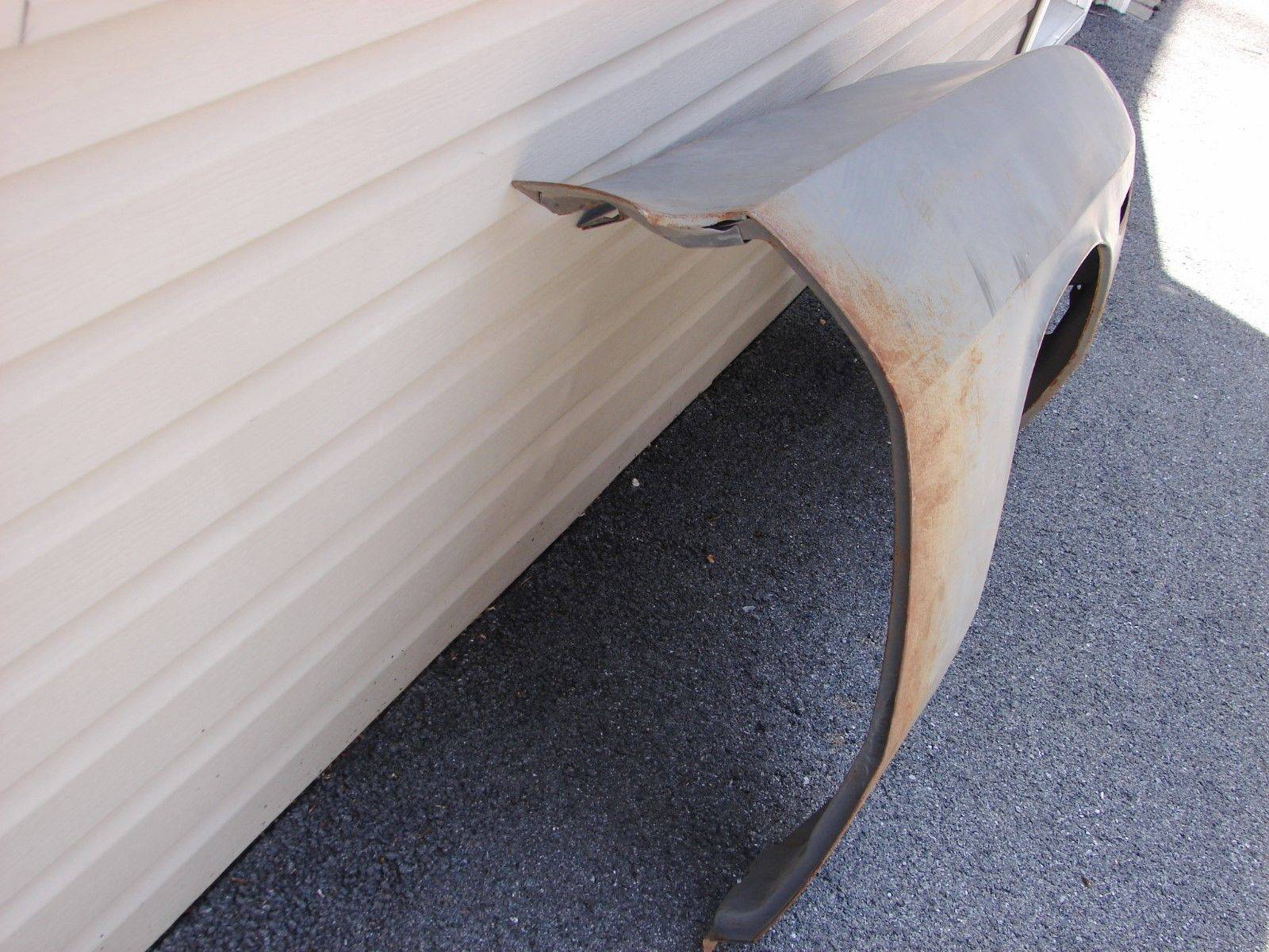

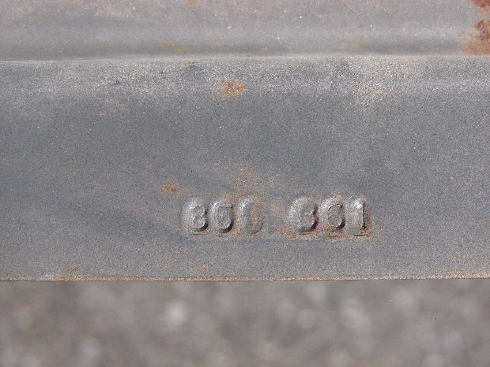

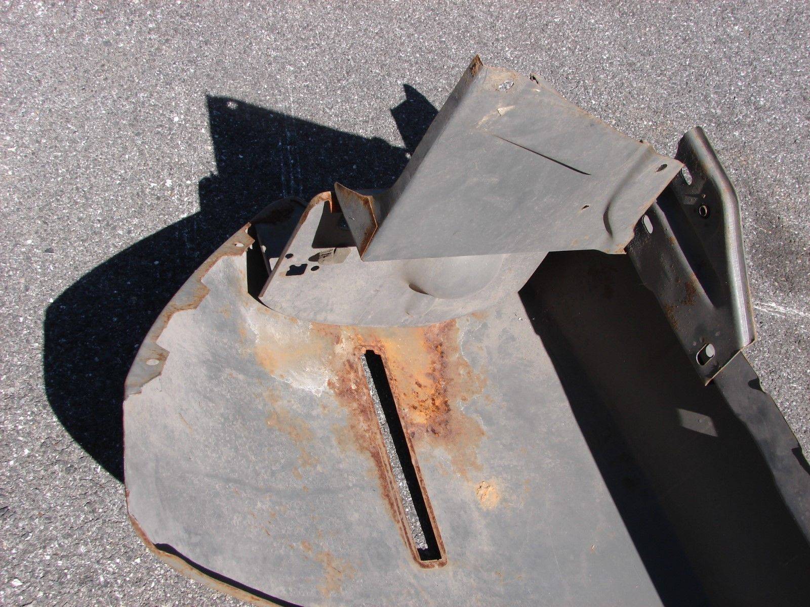

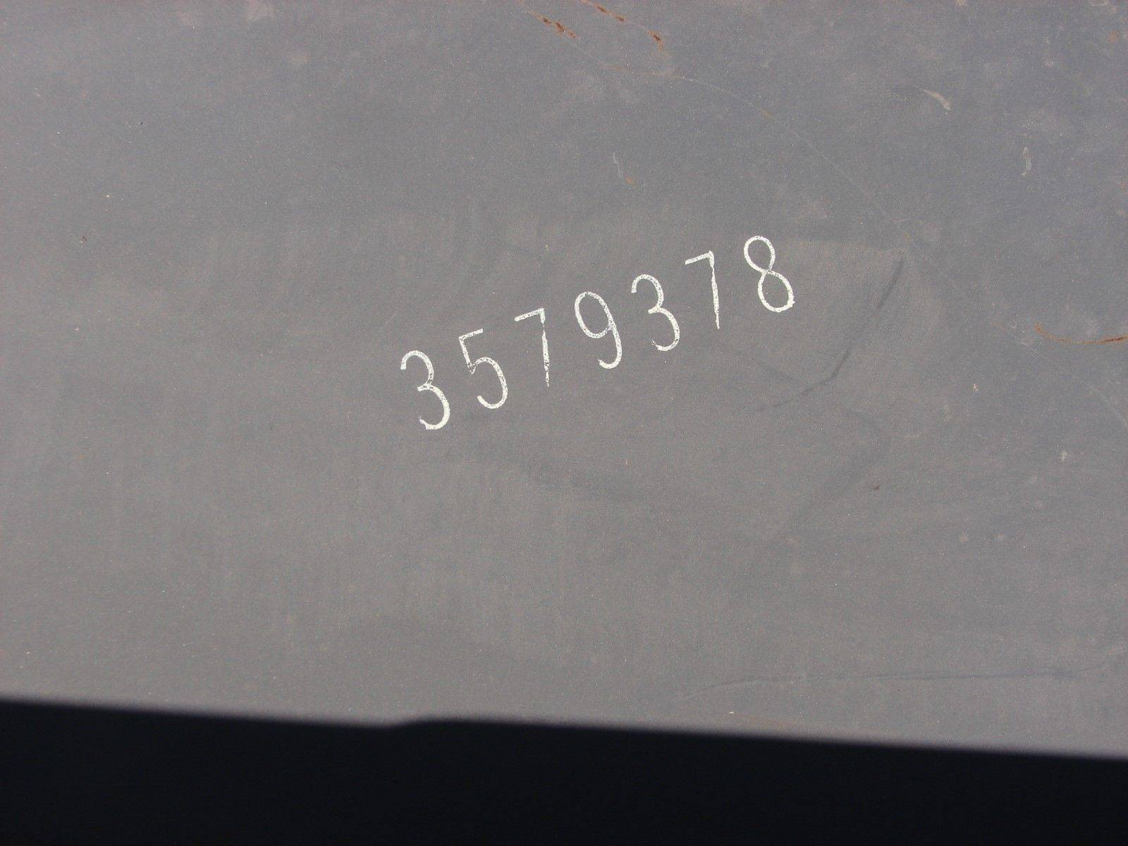

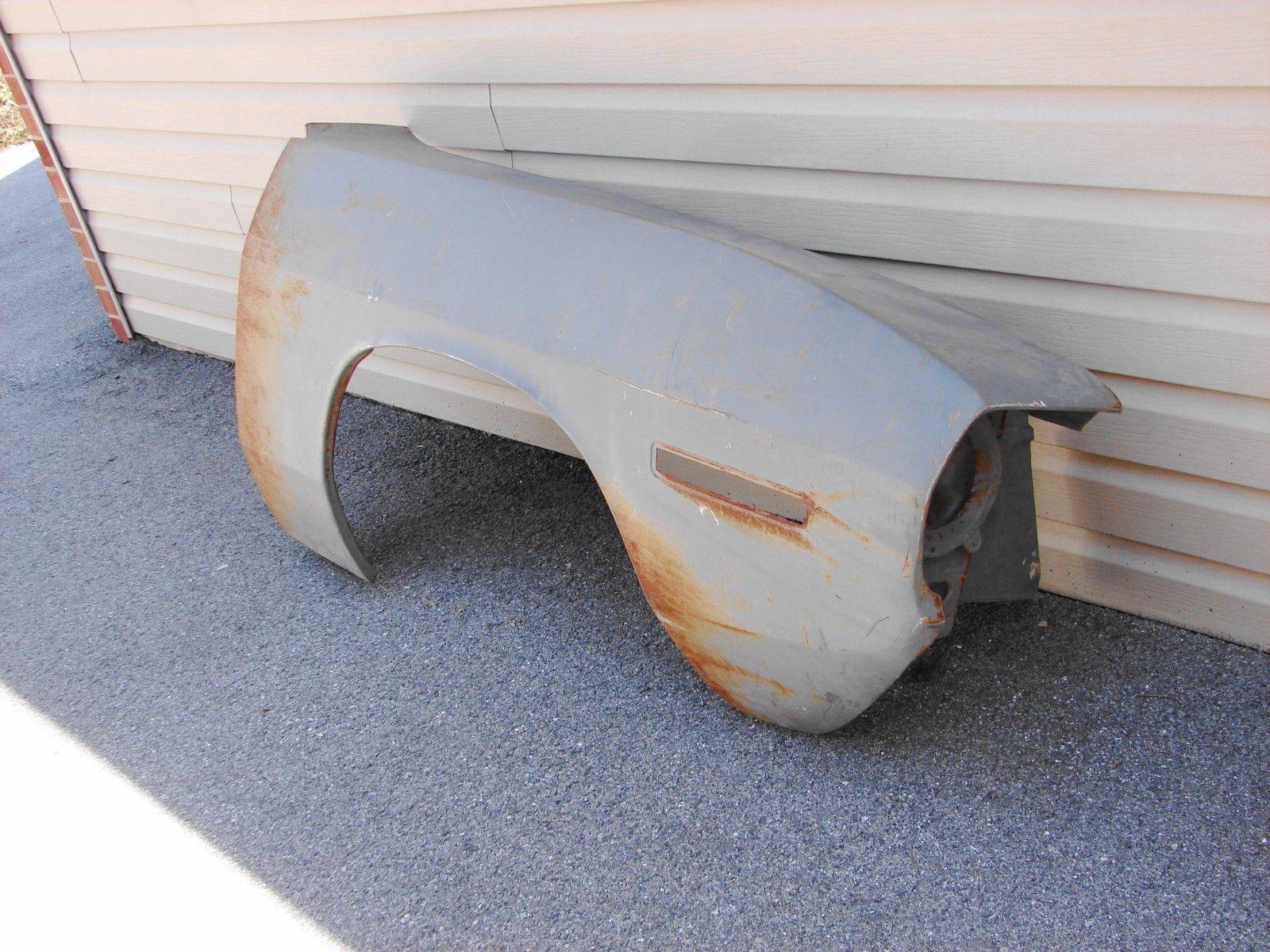

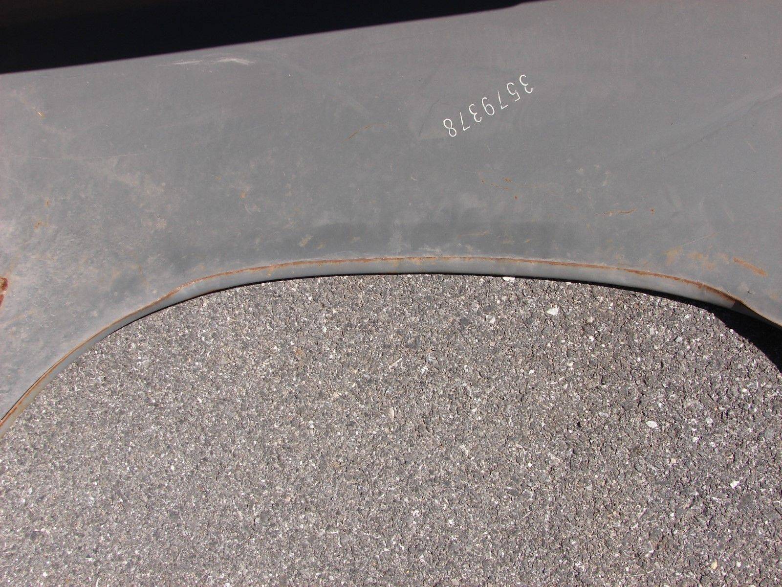

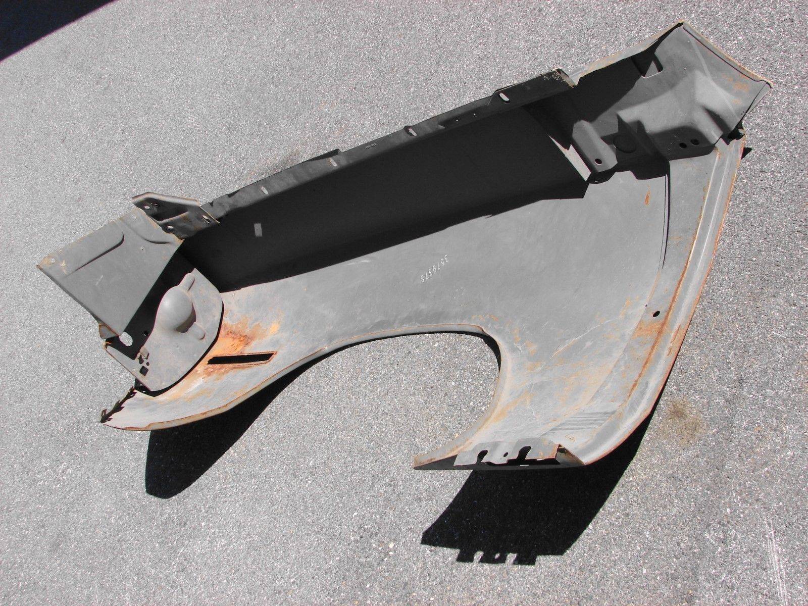

NOS pics included.

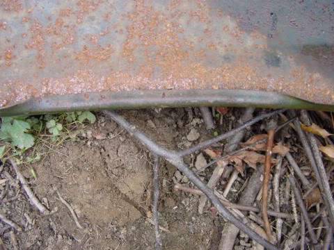

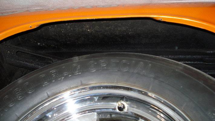

And some more originals with paint.

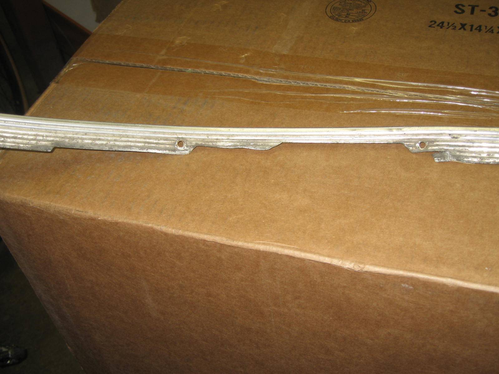

I'm not sure about the validity of the rolled wheel well trim but it was supposed to have been a factory made piece. ?
Would love for someone to prove me wrong. Or to see a different version of the wheel well trim with F60's.

If you look closely at the rolled parts of the factory fenders you can see there is a crease half way in the rolled part. There was a tool that was used to role these fenders.
Everyone I have gotten photos of and the one fender I have put my hands on had that little crease in the middle of the rolled part. That was not created by a pipe against a tire.
The factory had a machine and specifications as to where the role started and stopped. The original paint fenders all stop and start within around a half of an inch of each other.

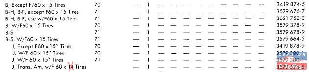

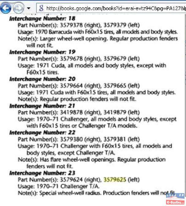

The NOS part number 3579378 fender earlier in this thread is for 1970 Cuda fenders with F60x15 tires.
