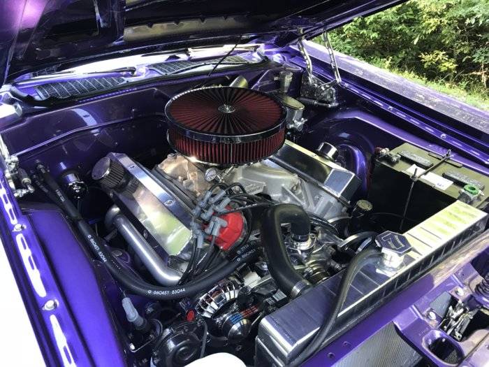

Well I've got a 70 challenger r/t (originally plum crazy purple), but the previous owner appeared to have painted it red and now its sporting rust. It used to have a vinyl top, which I'm abandoning. It used to be a 4 speed car with a 383. When I received it it didn't have either. I'm planning on building a street/strip car with the factory color. I've got a 440 block bored .040" and a 512 stroker kit from 440 source. Its going to be a 10.5:1 engine on pump gas, aluminum Edelbrock Victor heads, custom grind bullet cam with a fairly aggressive profile. I'm hoping to get it in the high 9s in the 1/4. I've purchased a 727 that I got for a good deal. It will be rebuilt with a fully manual valve body and transbrake. The rear end is a 8 3/4 and I plan on running a 4.10 setup. A few other mods: exhaust electric cutouts, line lock, possibly a small nitrous setup?
The car is fixing to go into the shop for metal work, the majority of the skin will be replaced. I'm not tubbing it, however it will have a 3" spring relocation kit put on as I plan on running 295s in the rear on some 15" black steel wheels (that's still undecided). Ill also have subframe connectors put in and a cage inside the car. While I realize this wont be ideal for daily driving, I still want this car to be driveable on the street to cruise to car shows and what not. Basically I'm trying to build a badass street car that will turn heads.
