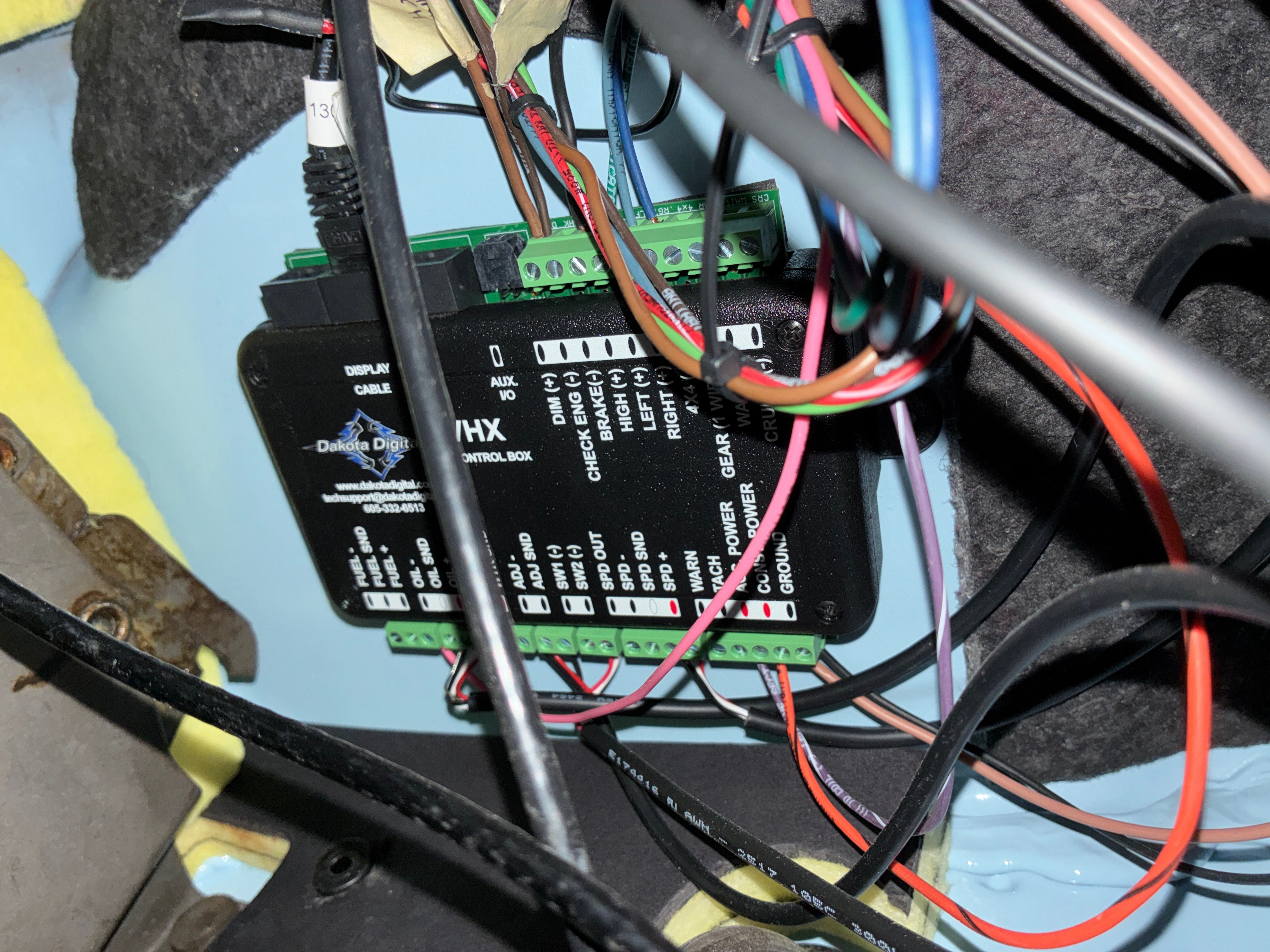

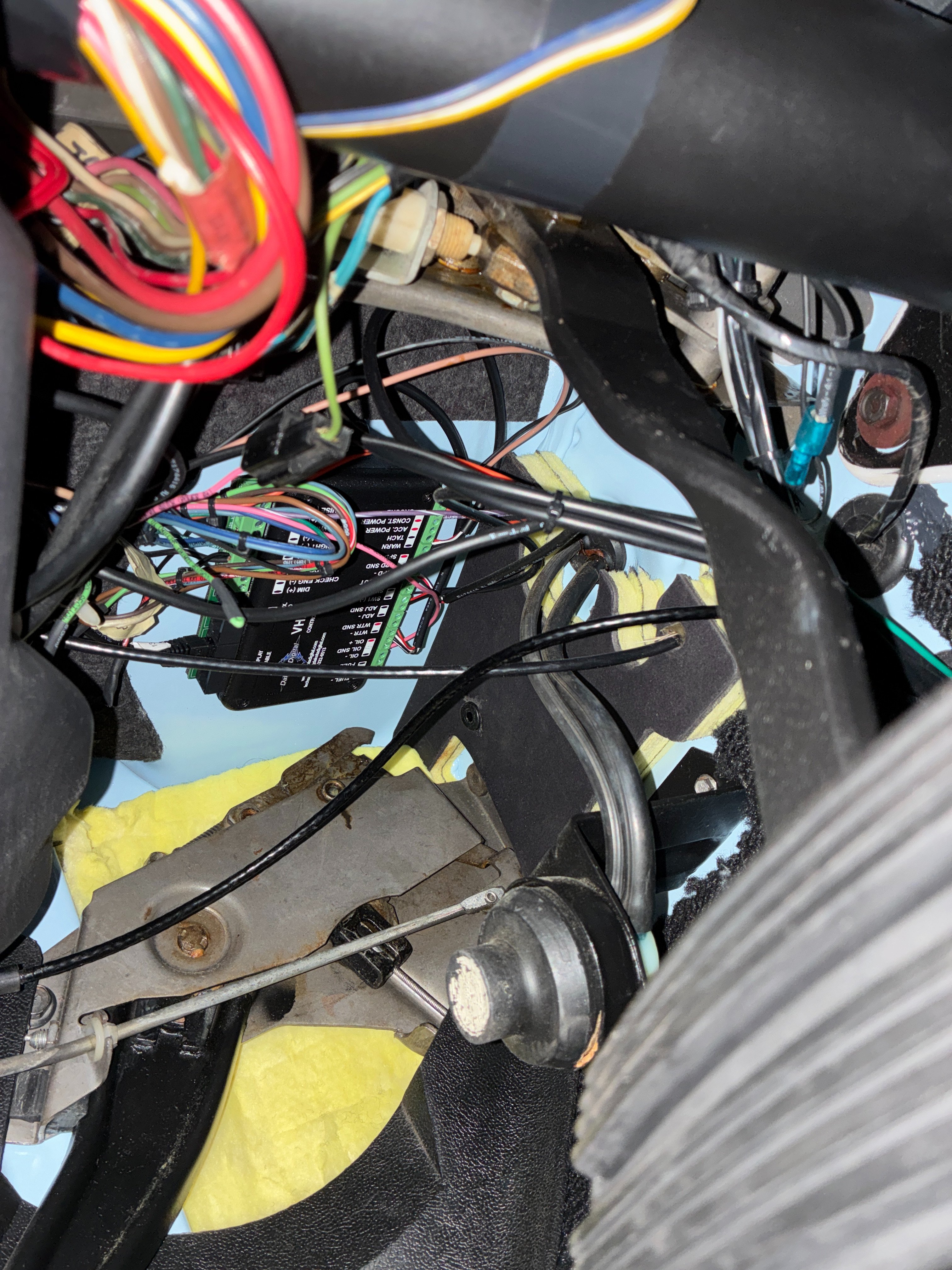

The control box for my Dakota Digital speedo cluster tucks up nice and out of the way of just about anything.
