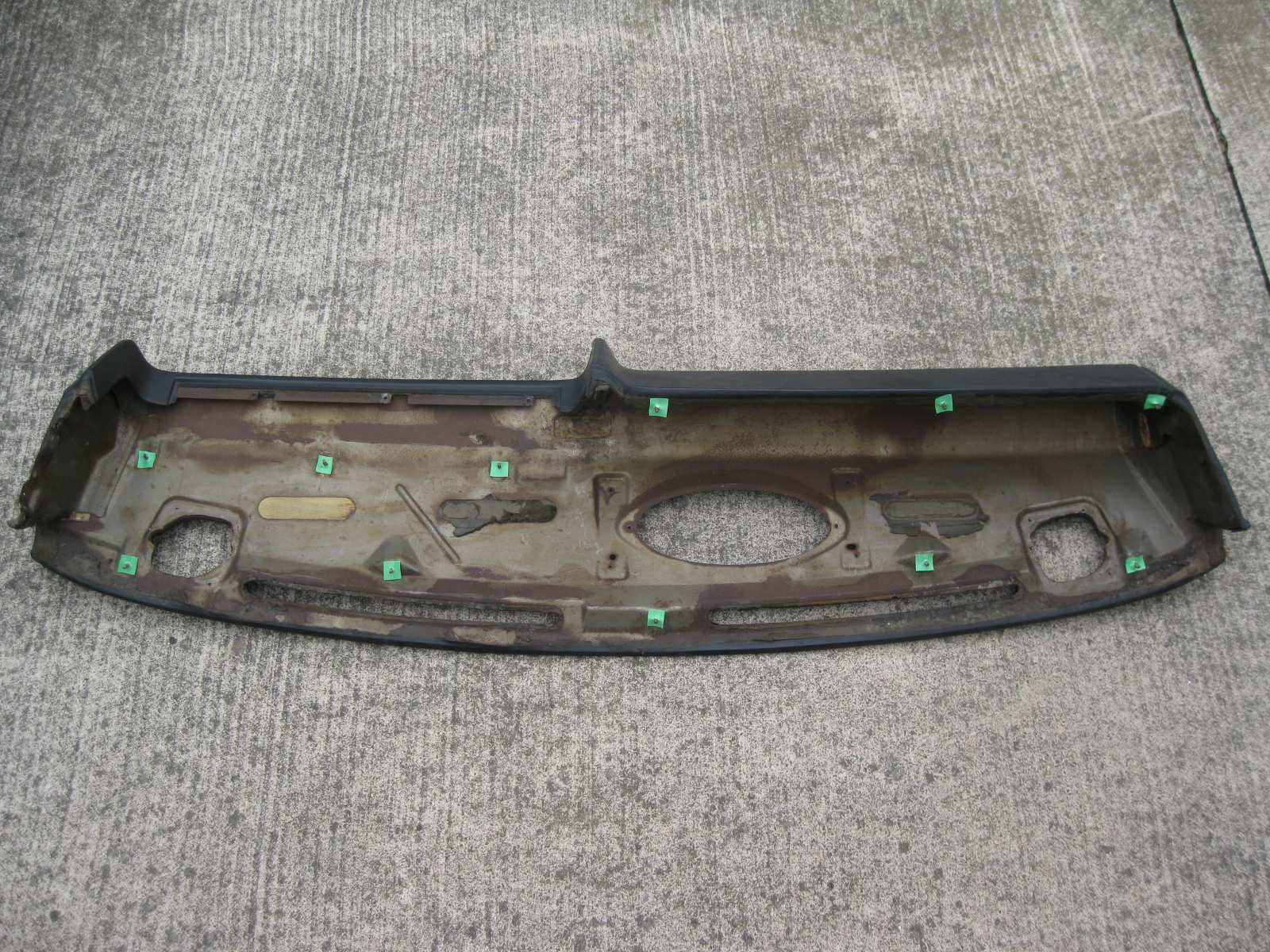

That's a good question, I wish I could give you a definitive answer. My "guess" is no. If you do have to remove the pad this picture should help locating all the studs.
