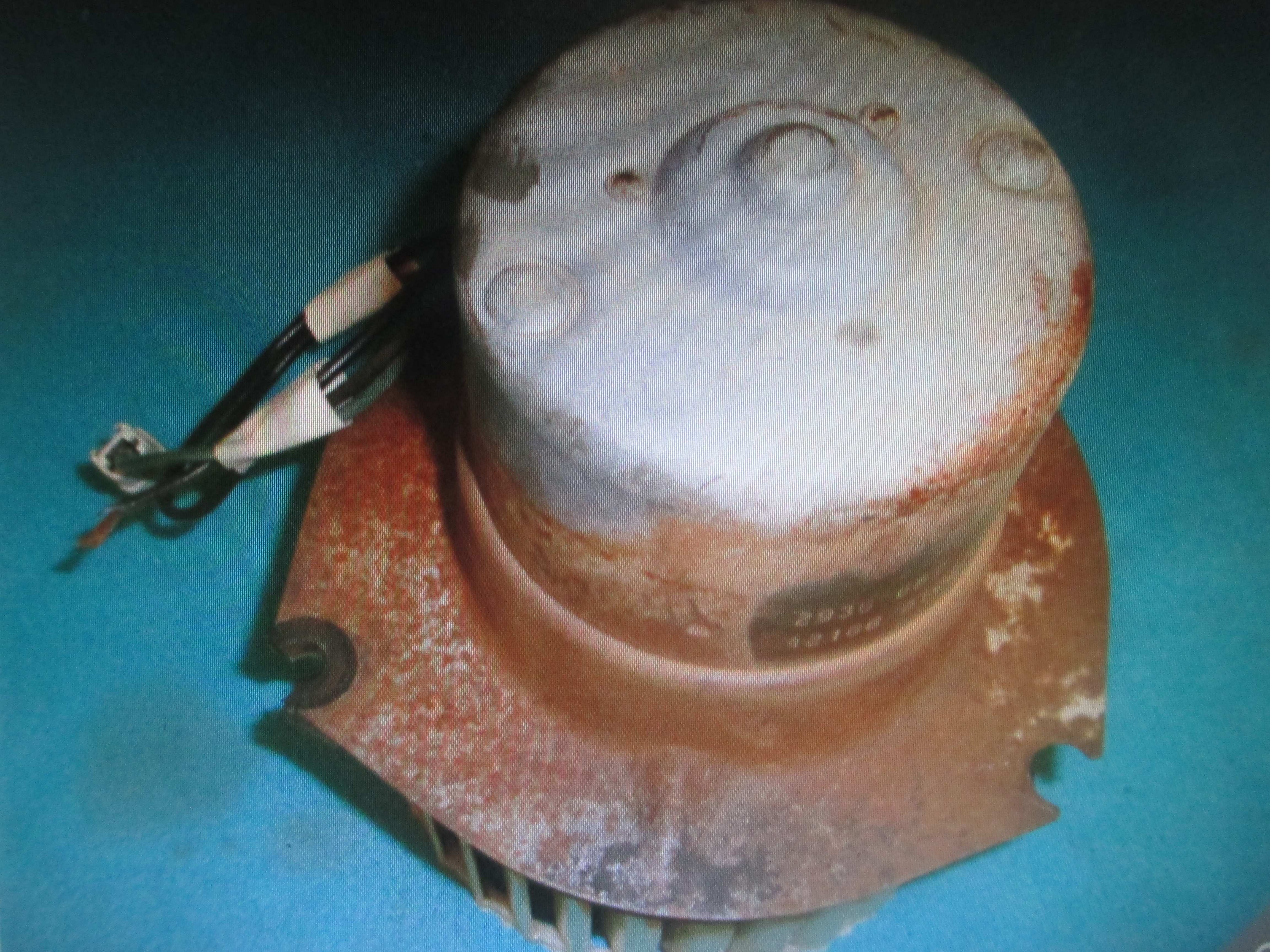

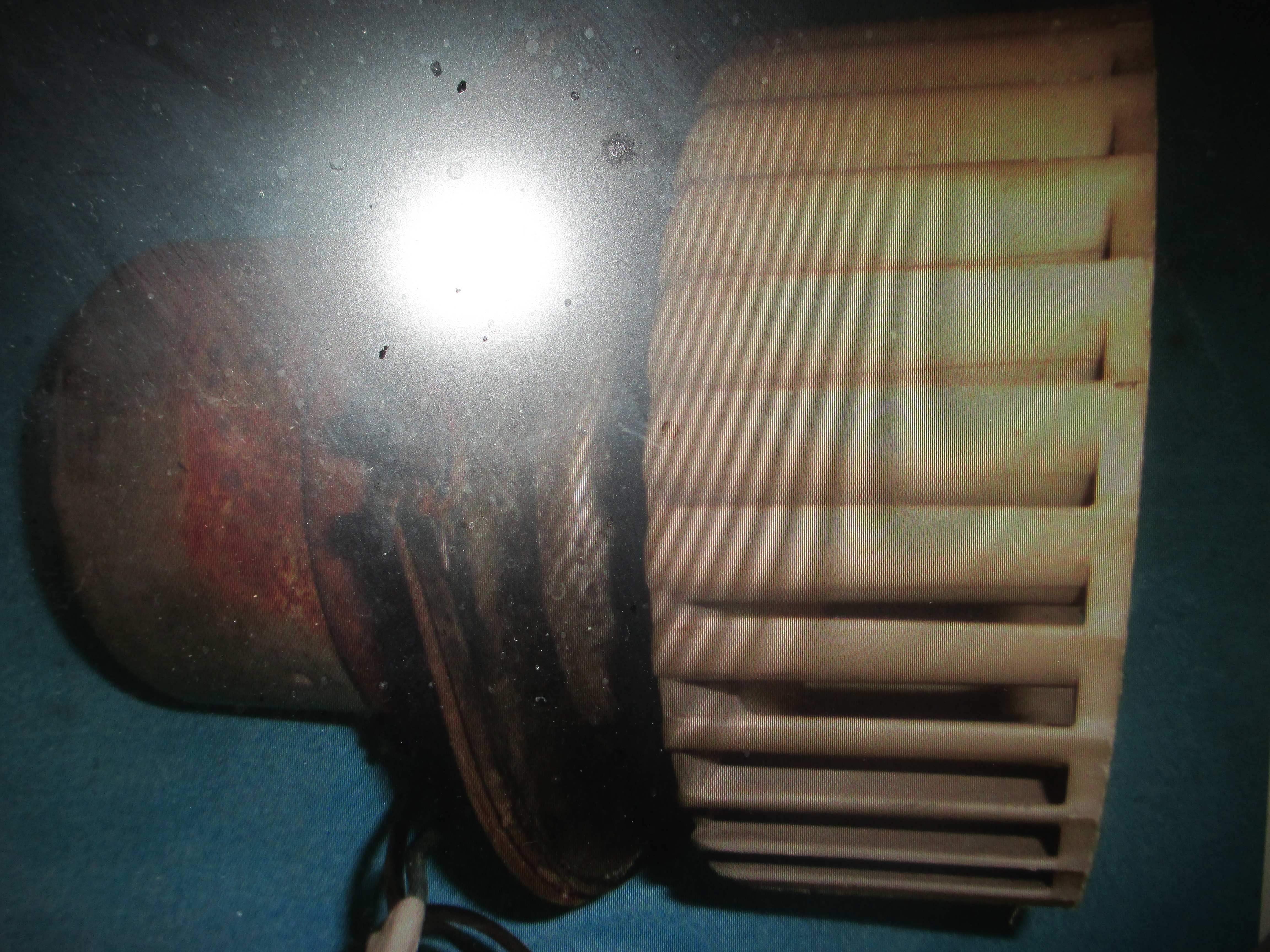

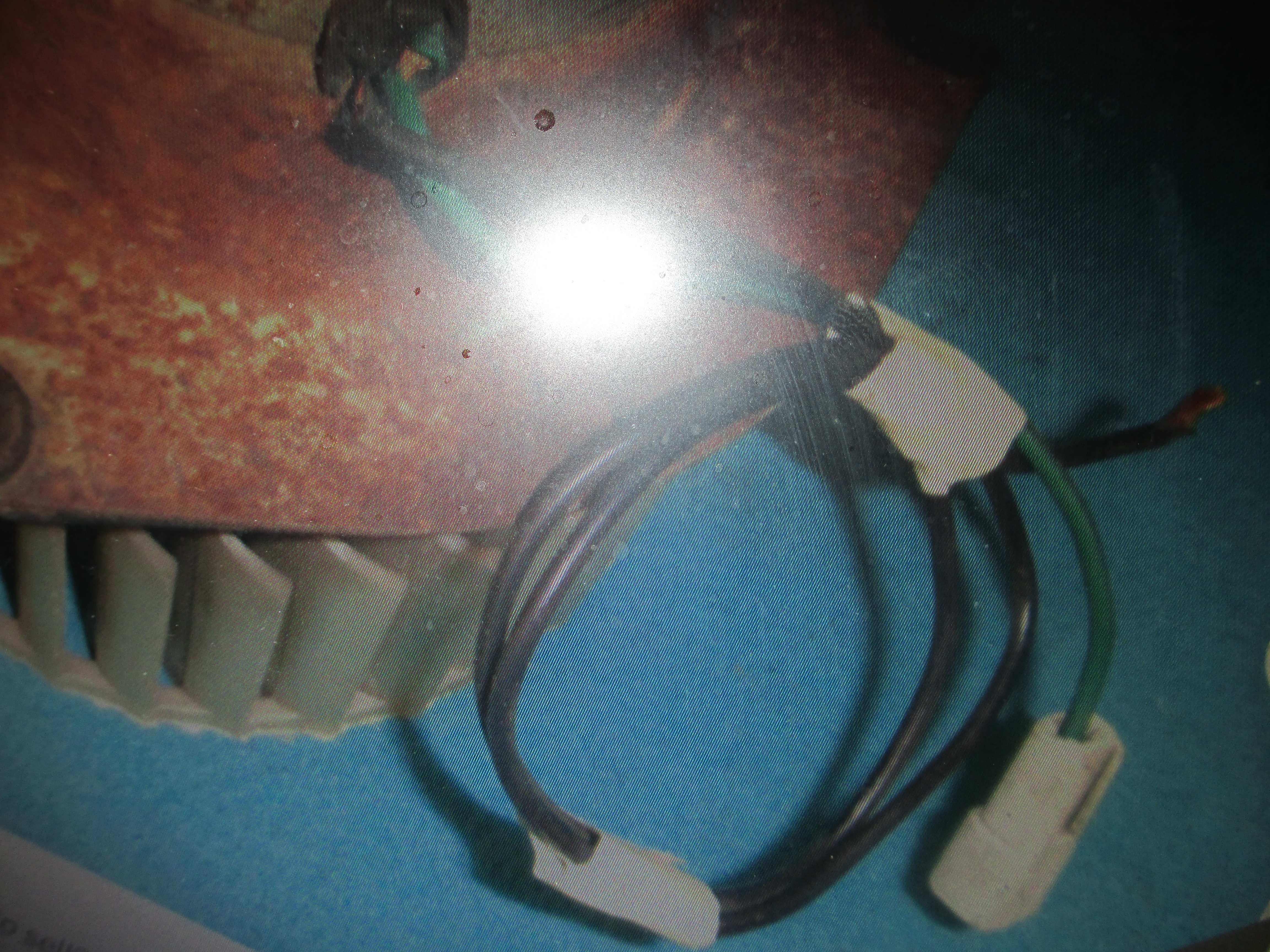

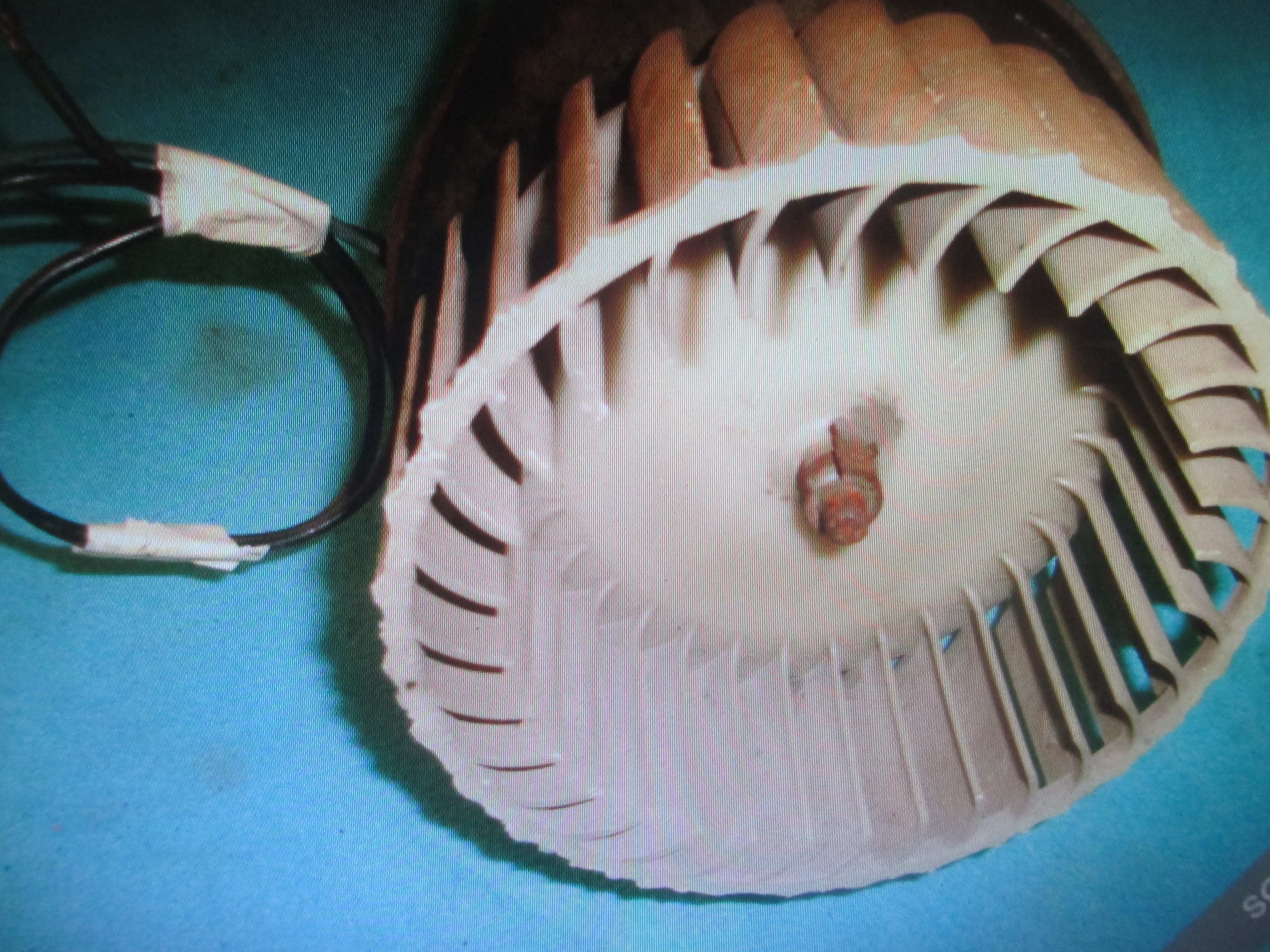

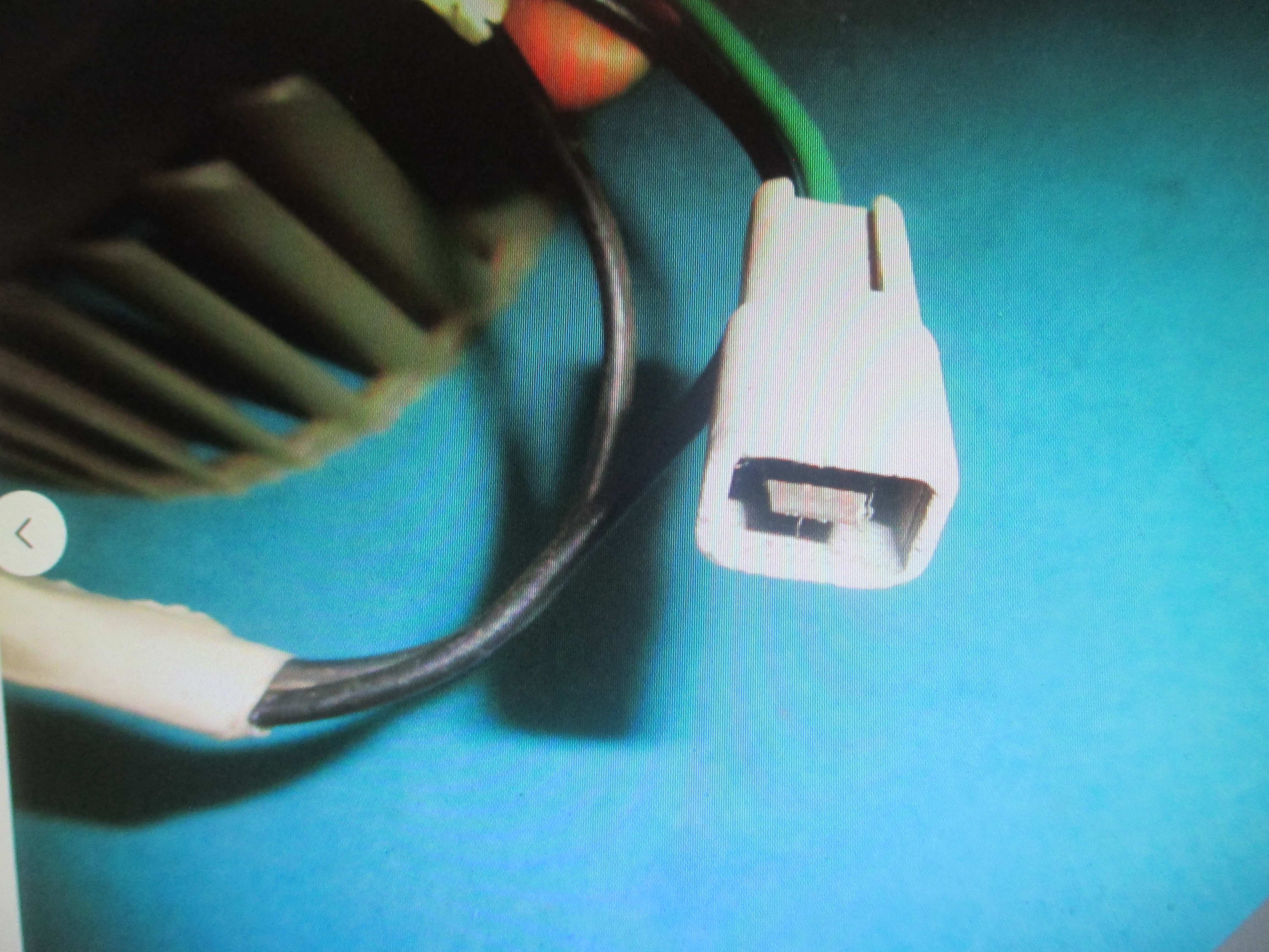

I bought this and im gonna have Topher rebuild and dye it. Can anyone advise if I got the right motor it looks right to me but I think there's a difference between a AC motor and a non AC motor how do you tell the difference?

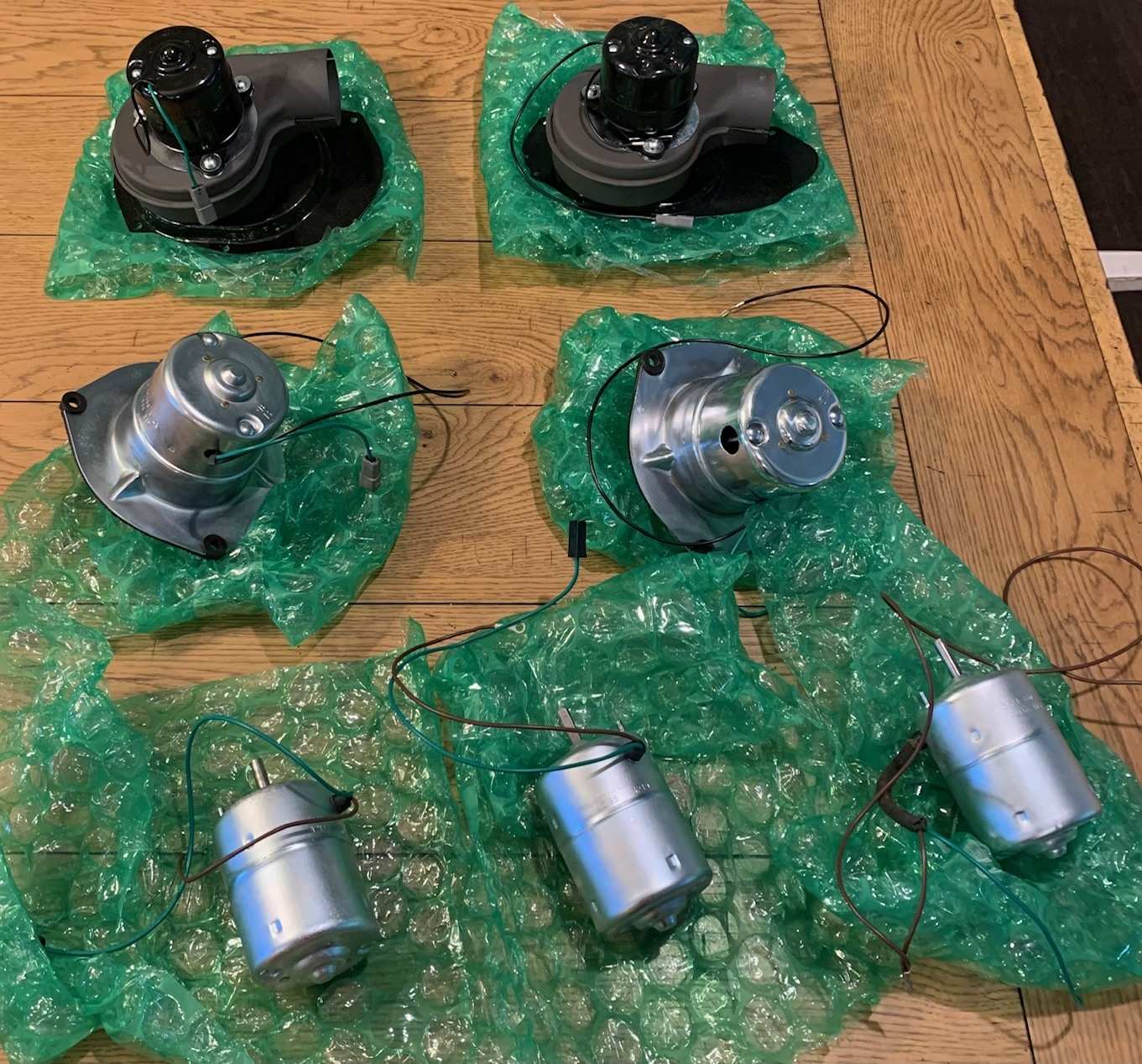

Here's a pic of the motors Topher did for me. The top 2 are rear defogger, middle 2 are a/c, and bottom 3 are non-a/c.
