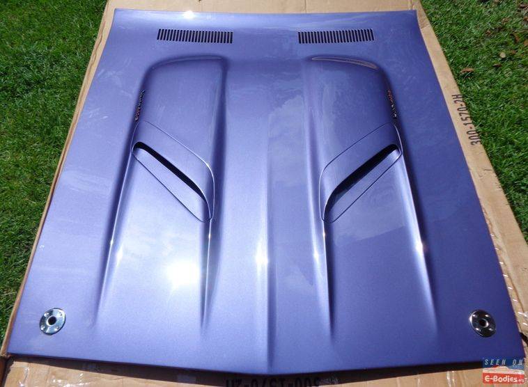

One of the things that has surprised me the most about the Barracuda as I learn about them, is that the twin bulge hoods aren't functional. They look cool, but they don't do anything to add air flow to the engine compartment. In my opinion, it's useless to have something on a car that is supposed to be performance-oriented, but ends being ONLY for looks (kinda like the faux beadlock wheels on 4x4 trucks).
Here's my question. I'm sure at least one person out there in the world has cut out the scoops on these hoods to make them functional, but 1) is it common practice, and 2) does it hurt the resale price of the hood? I know it's my car and I can do what I want to it, but is it frowned upon when people do this? And I ask about the resale value of the hood, because ultimately I think I'd like to go with an AAR style hood. I just can't afford it at the moment.
As a temporary solution, I'd like to cut out the scoops to increase air flow in the engine compartment, mostly because I live in southern Arizona and summer (and 110+ degree temps) is quickly approaching. I'd love to hear your feedback.

There were a couple other threads about doing this, but I think the consensus was that since they weren't designed to be functional, it may actually hinder performance by messing with the airflow and causing turbulence

Keep or sell the OEM hood, and buy a fiberglas AAR or twinbulge repro hood. Dont' chop up something OEM that is only getting harder to find when someone else might be looking for your style hood. Buy a replacement new hood and have at it.

That’s interesting, thanks for the input. I suppose I could’ve searched the forum for previous threads — hate to be that guy. Well I guess that explains why I don’t see any that have been cut when I do an image search online.
Thanks. That was another reason I was hesitant to go chopping it up. It’s in great condition, and I’m sure there would be someone eager to have it as-is, so it would be a shame to alter it just for the sake of having a temporary solution. It gets pretty hot here, and with headers/closed hood I’m always watching the temp gauge like a hawk.
I think I’ll save the time and effort, and spare the hood. I thought about going with a shaker hood, but it seems to be pretty difficult to piece meal everything together. The only kits I could find included a lot of what I already have and couldn’t find a shaker bubble by itself.

I had a hood that someone did the modification that you are talking about. I had a hard time selling it, no one wanted a cut up hood. You have gotten great advice from other members, don't cut your stock rally hood.

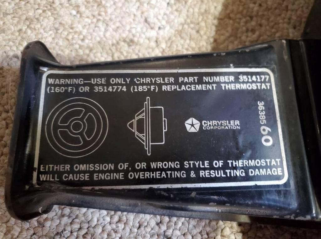

As I've discussed elsewhere in another thread, make sure you are using the right thermostat. If it's not all brass & copper construction, and doesn't look like the diagram in the factory decal below, you're handicapping your cooling system. Parts-store thermostats are NFG. You cannot buy the right ones new anymore; the Mr. Gasket Asian copy has an enormous (>70%) failure rate. NOS is your only option, and in your situation I'd definitely be looking for one or more of them.
Thanks for the explanation! Certainly helps me understand the physics of what’s happening to the air as it goes over and around my car. And thanks to others for their info as well. Before now, I hadn’t known about “boundary air” and obviously wasn’t educated on how or why air induction systems worked.
I’ll try to get a stash of thermostats that aren’t NFG (seems the NFG folks put their parts in everyone’s boxes nowadays) so hopefully I can find some new old stock ones - for the Scamp as well.
