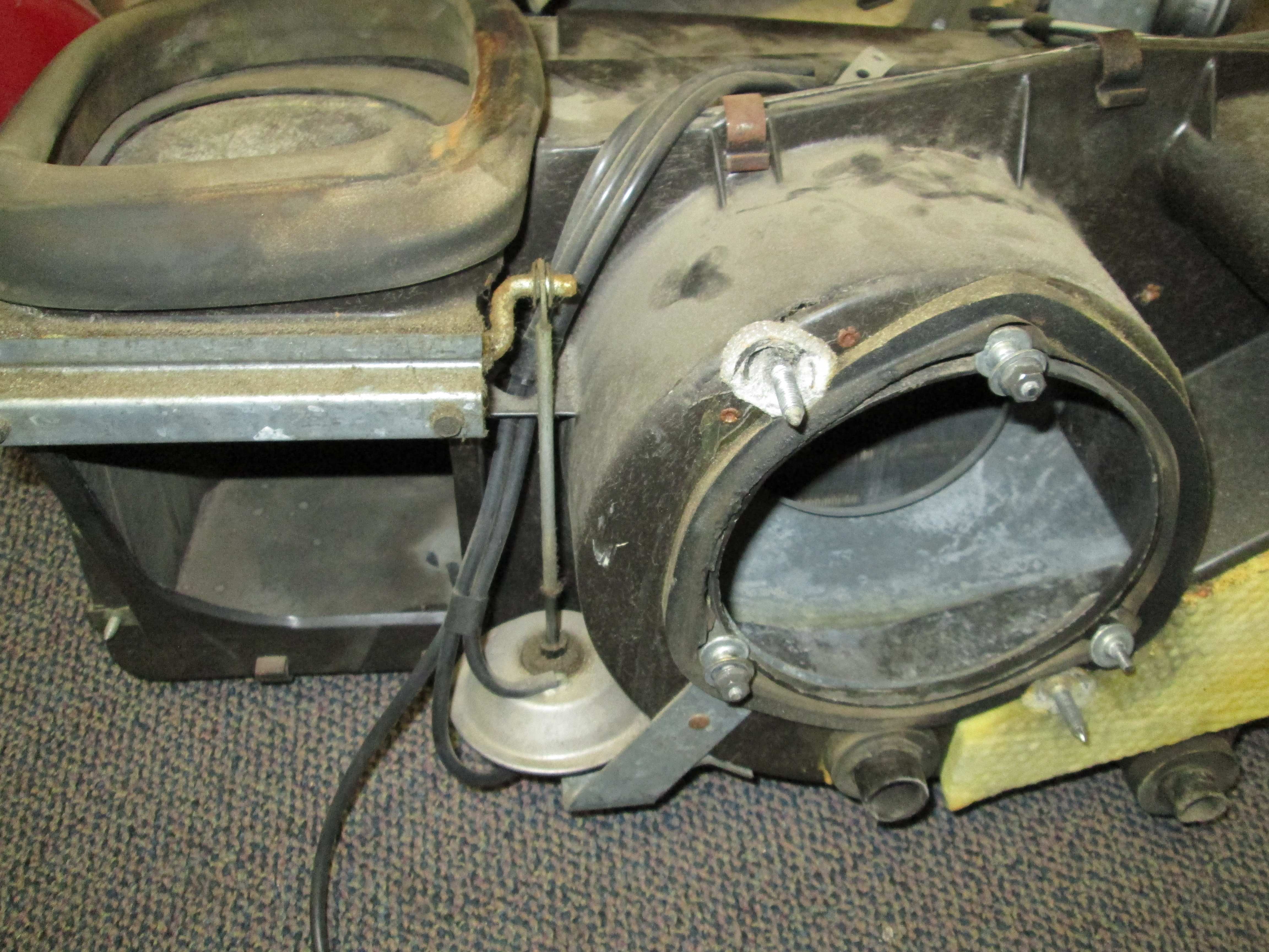

Does anyone have any idea what these would be used for there are 5 of them?

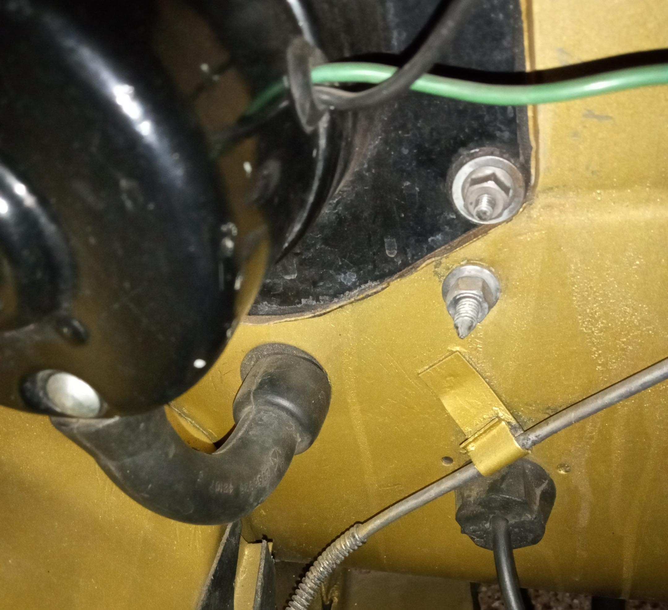

They also go on the three studs to hold the heater, A/C fan motor flange onto the firewall. The rubber isolation gasket has a molded raised "pad" that these conical washers compress by the nut. I'm the original owner, so know this is factory correct.
Since there are 6 of them, do you think one goes on each side?\nOf the rubber thanks
I didn't thinks so at first, but then referenced this picture I took when refurbishing my Heater Box (used outstanding Detroit Muscle kit - - seen in the sidebar). It clearly shows two conical washers per stud. So your question was a good one! Mystery solved :steering:
