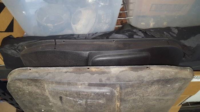

I had to replace my passenger 70 challenger door with a 71. My original door panel does not seem to fit properly on the 71 door, especially in the upper front corner area. I looked at my 70 door and the sheet metal contours do look a bit different. Can anyone confirm my issue? Thanks

1970 is one year only. The difference is that there are 2 slots cut at the top and bottom of each end (4 total) to allow for fit around the upper and lower curves of the door structure (see photo showing the 1970 panel with slots vs. a 1971-4 panel without.) You can easily replicate the slots by carefully cutting them in at the right locations which should help them fit properly. Other than the slots, the rest of the door panel is identical cosmetically. Hope this helps...
