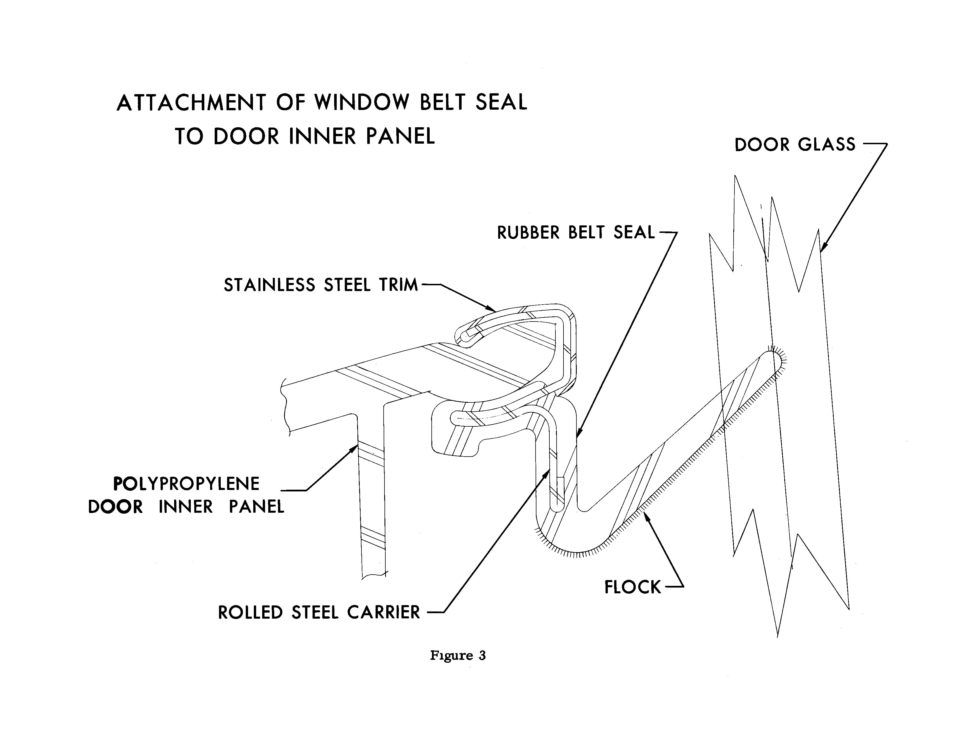

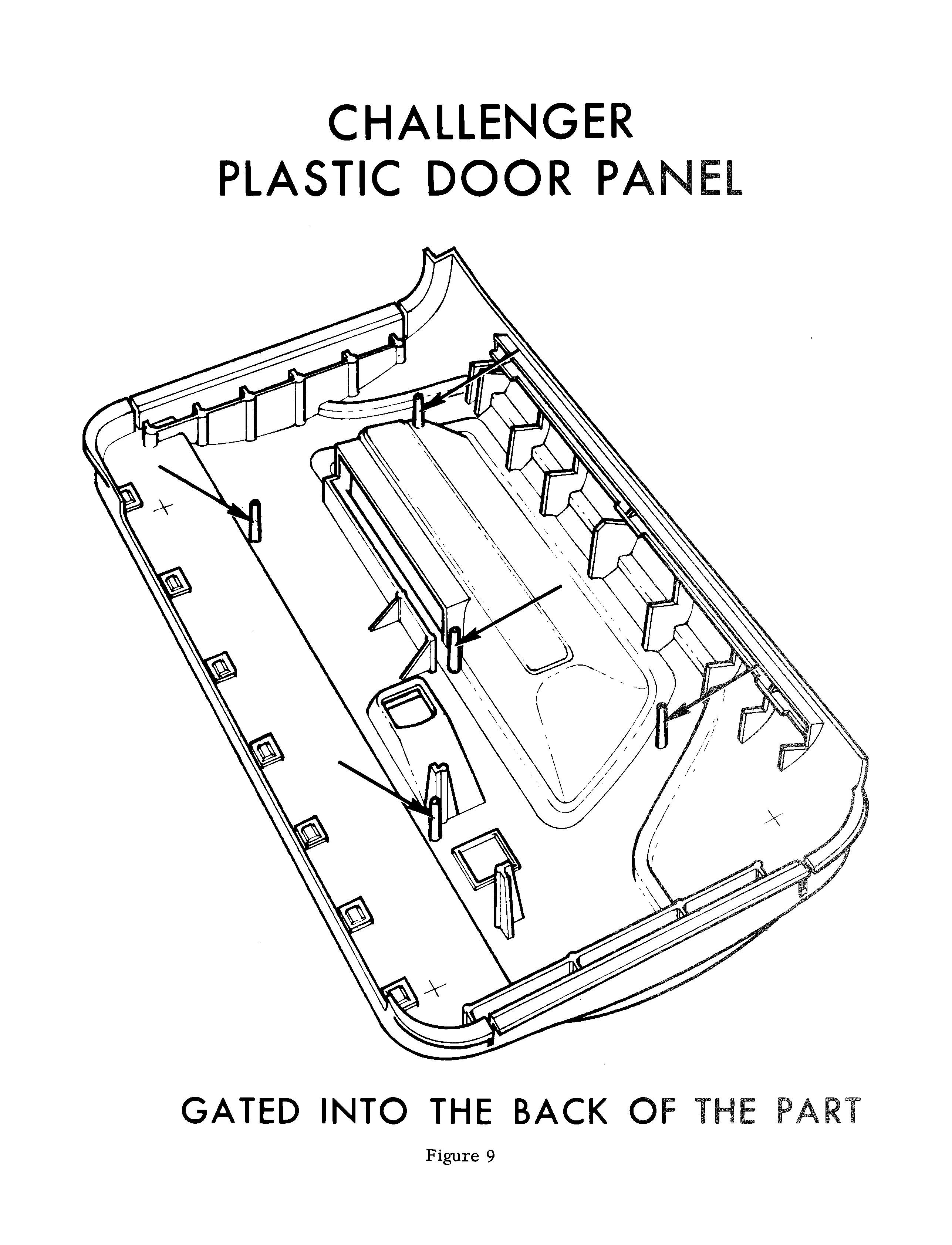

the door panels MAY BE ABS plastic, but I don't think so. Polypropylene is a better fit. They resist melting (to weld) and gluing (by most adhesives) and of course, repelling moisture and hand acids and oils from handling.
