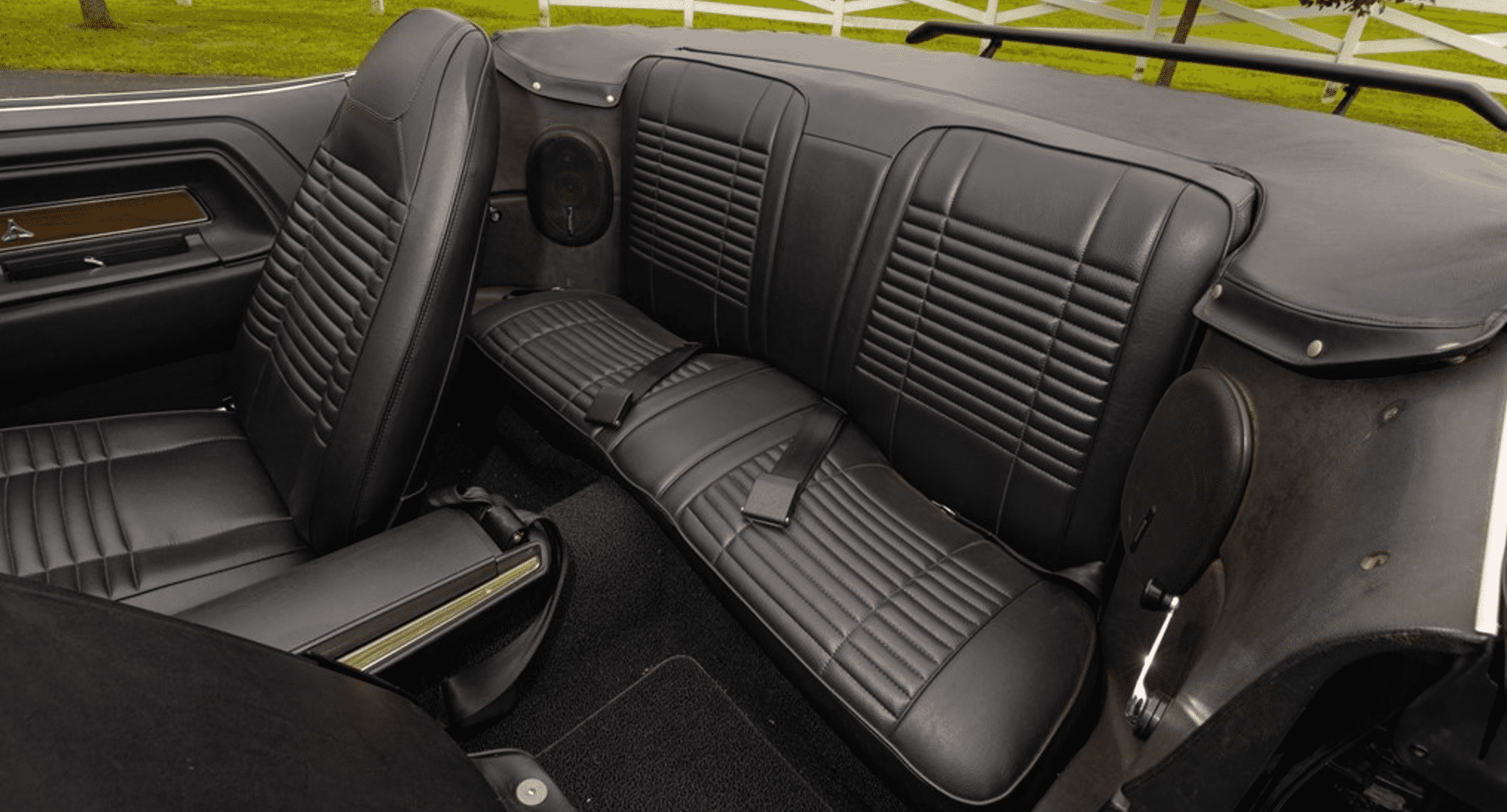

So I found this pic of a car 1970 challenger convertible that sold @ Mecum earlier this year.
First, the idea of kick panel speakers is a great one and I was already planning on doing that. My last project was a 55 chevy and I fabricated some kick panel mounts from ABS that I had my interior guy finish to match the rest of the car. Here's a link to a google album in case anyone's interested in seeing that project.
I really want a decent sound system and to me that means at least 2 speakers in front and 2 in back. I think I can probably make 2 6x9's work like the ones in the photo below.

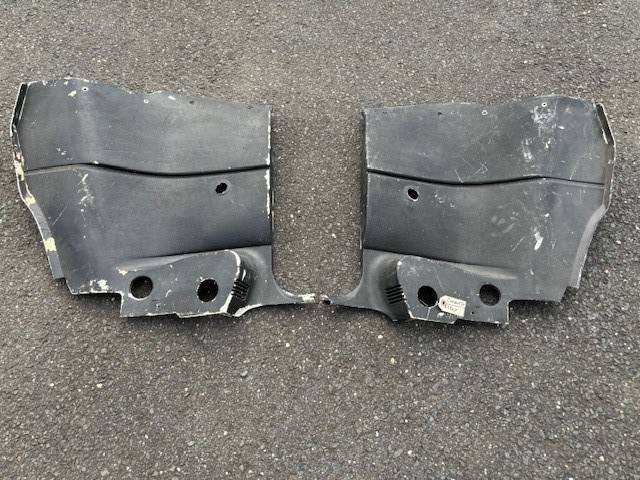

What condition are your rear panels? Mine are good other than the speaker holes so maybe we should trade even up.

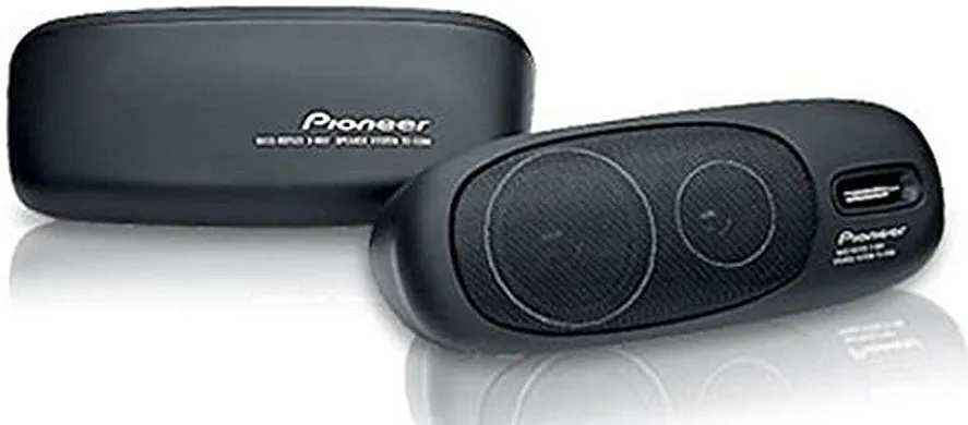

I don't have a pic of my car when I had the speakers in it. I used speakers like these. I made brackets and mounted them on the top of the back seat. They looked like headrests. I attached them under the boot strip on the seat. Since they didn't have a lot of range I added a couple of subs in the trunk to round out the sound. I cut rear panels in 1980 to mount 6X9s. I found that you hear both sides of the speaker. The boot on helps a little with sound. Any speakers with a large magnet would hit the top pistons when mounted. These speakers are similar to what I used. You can clear the top and use the boot with them mounted.

Unfortunately the Challenger and Barracuda rear panels are different but there are lots of Challenger ones that have been cut like DeMatt1's.

Use another pair for the speaker holes or find a pair that has them cut already.
Just use those and put up your nice ones until you are ready to either use them or sell them. It's pretty easy to find a pair that has holes cut into them.
250 is a great deal, well worth that cost.
