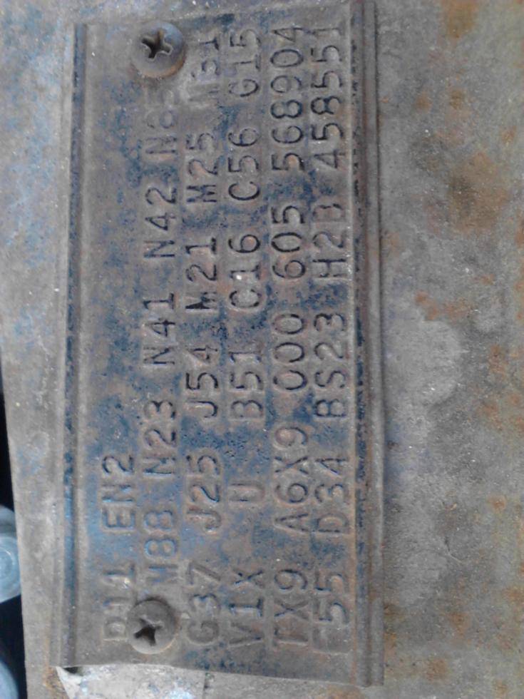

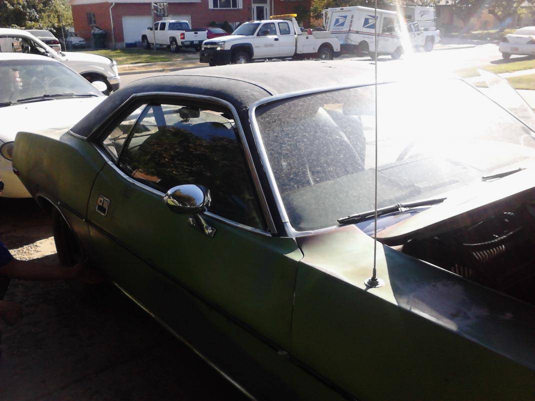

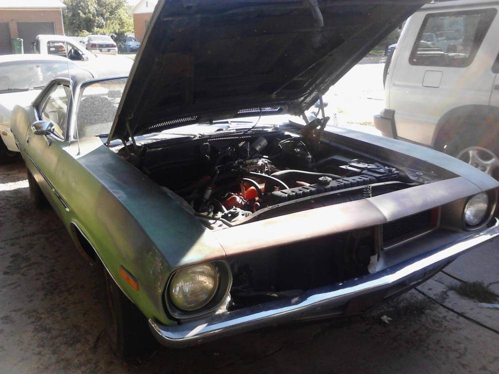

Hello, I've come to this forum for your help guys, I am an A-body And B-body owner. I've come across a 1972 Plymouth Cuda 340, Apparently numbers matching and was an original Black on Black vehicle. Can anyone help and have a gander at this here Cuda and give me your opinions, can anyone decode the fender tag? What should I offer? It Needs Quarters and your typical rust spots, and some panels but it looks fairly solid.Any advice, opinions welcome.
The frame rails and floors look fairly solid. lots o bondo in the rear quarters, trunk looks solid-ish. Automatic Trans with an 8 3/4.

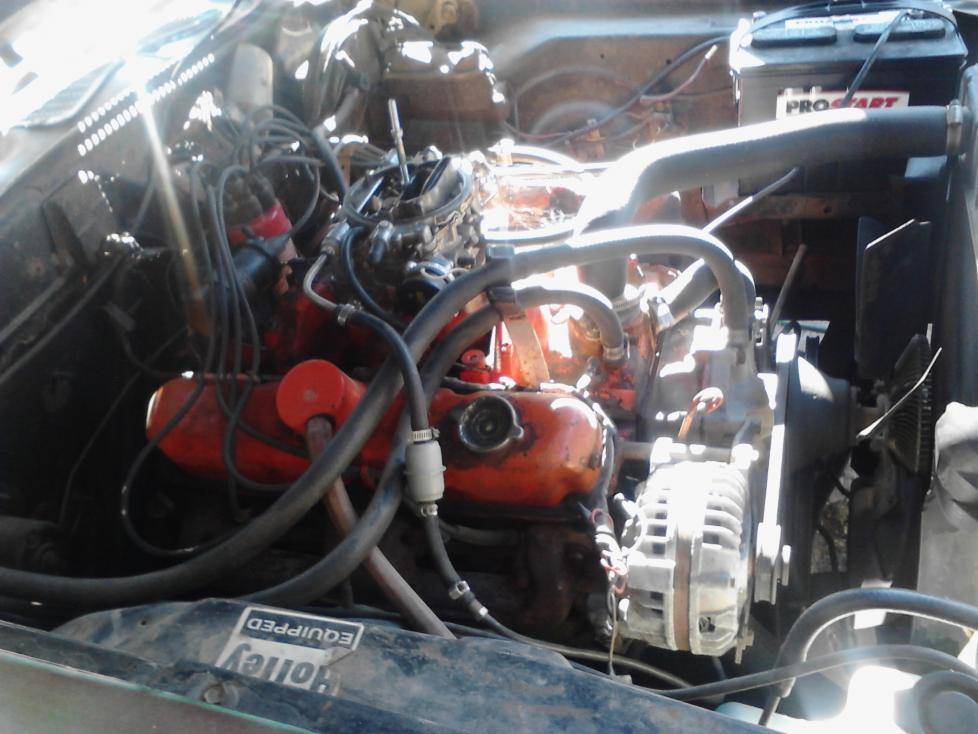

If that is a numbers matching engine , the color should be blue. Would check the numbers on engine to see if it is original, assuming you care about such things.AS far as price $5000.00 or less would be a good number here.Codes are M88-deck lid mldng, N41, 42, dual exhaust, N85, tach, J25, 3 speed wipers, J54, sports hood, B51, disc brakes, C16, console, E55, 340 engine, D34, auto trans. The numbers not mentioned require more work, but this should give you a good idea of what you have here.
Thank you bad440, I will be checking the car out some more this evening, i will post more pictures before i choose to purchase.
