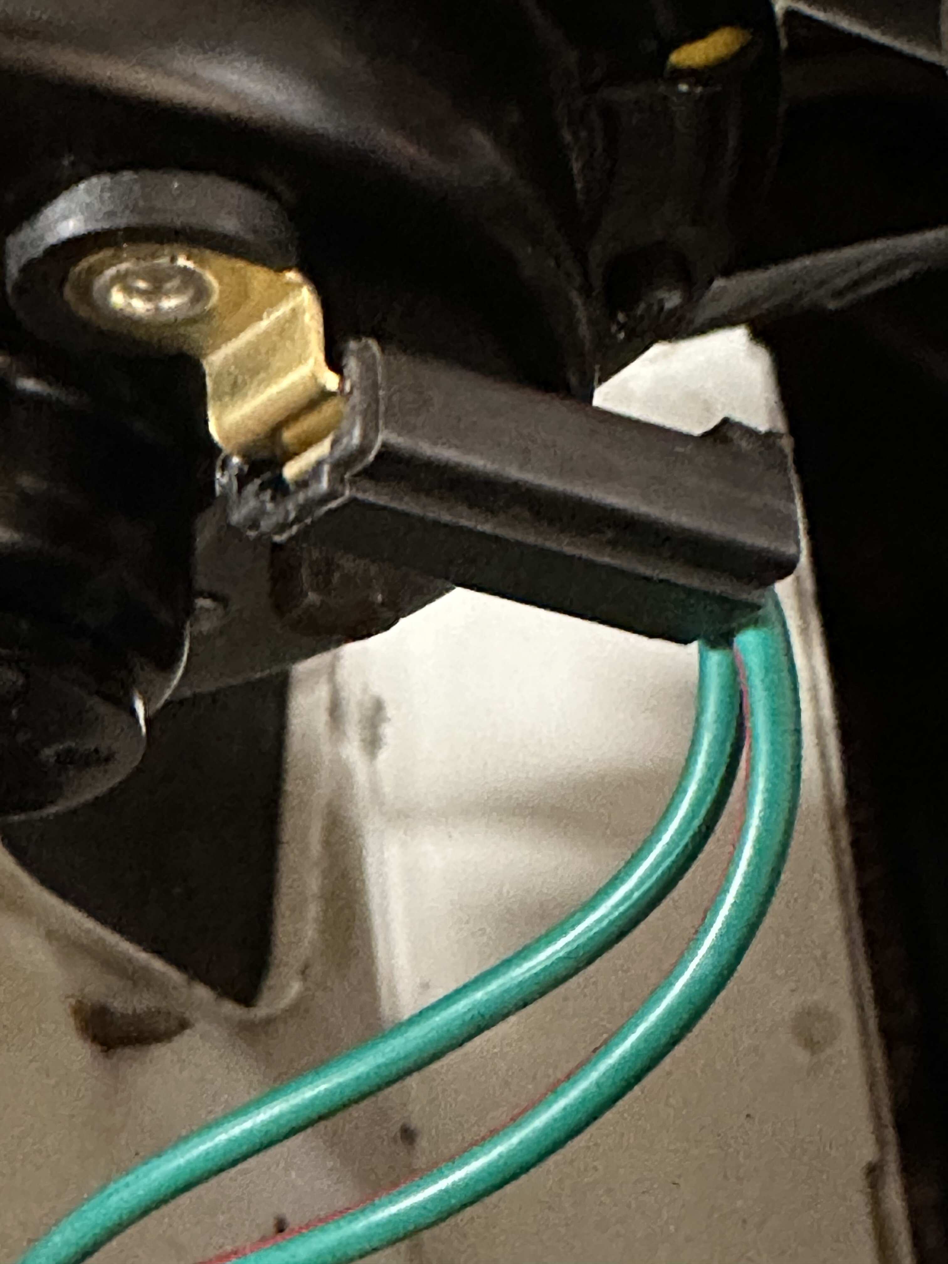

I would appreciate some input on the topic of engine harness connectors.
Is there a simple way to revive a used connector like this? In this example of the connection to one of the horns, one is fine and the other is too loose to stay on the terminal. My engine harness is original but seems in good shape overall, but some of the connectors are loose after 53 years and I wanted to see if there were any tips for tightening them. If I have to cut and replace them, is there a source for the terminations that you recommend?
Thanks,
JB

You can remove the terminal from the plastic jacket, then use some pliers to close up the gap on the brass terminal.
