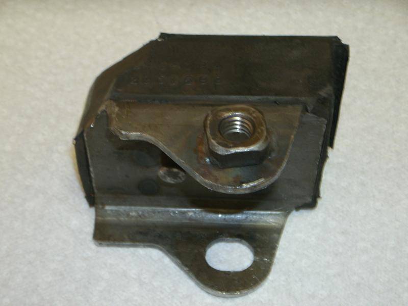

Does anyone know where i can get a drivers side motor mount for a 426 hemi. Broke it last week reinstalling the engine. K member was for a 440 but a kit was purchased and fit perfectly. Apparently the guy I purchased the car from is no longer around. apparently the kit was purchased from a company somewhere in the USA.

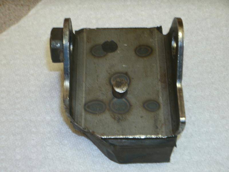

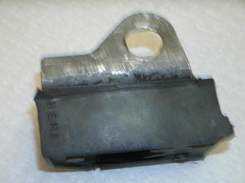

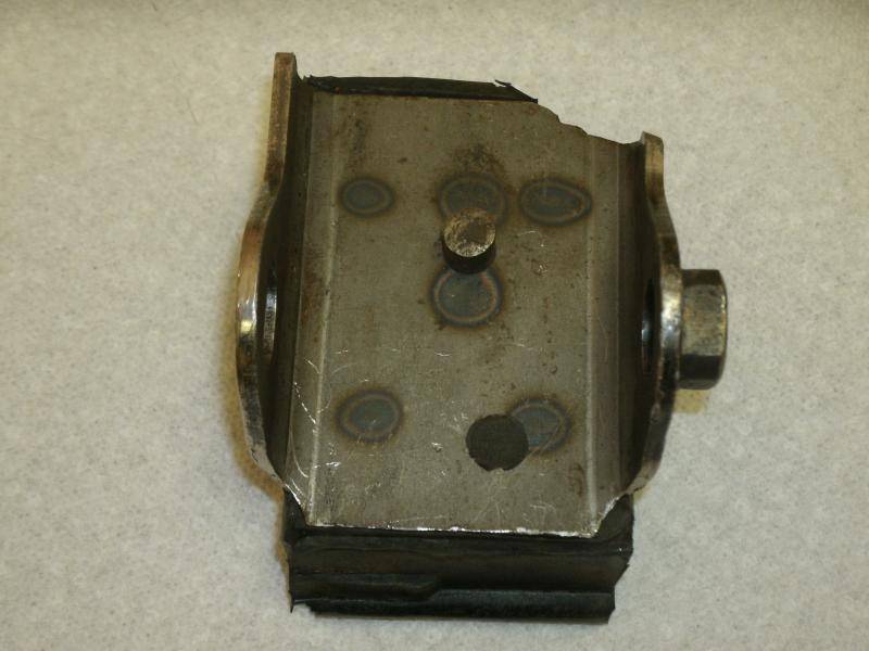

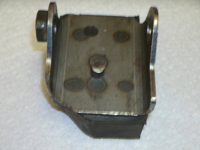

Attached are the pics I took of the broken engine mount. The rubber separated from the other metal piece still attached to the block. My mistake when trying to put the engine in. The length of the metal is 3 1/2 inches and the inside width is 2 1/2 inches. Anyone know who makes this and where I can find one.
moparleo
Oct 17, 2011
7,237
2,021
OK. Here you go: Mopar Part # P4510288 left side Hemi insulator # P4510289 right side Hemi insulator. Do a web search on that part number and all of the usual Mopar High performance sites like Jegs, Monicatti, Year One, etc.... wil pop up. It looks like the mounts run from $35.00 and up depending on the supplier.
I hope that this bit of info will lead you to where you want to go and get your car on the road. Good luck. Mopar or No car!
