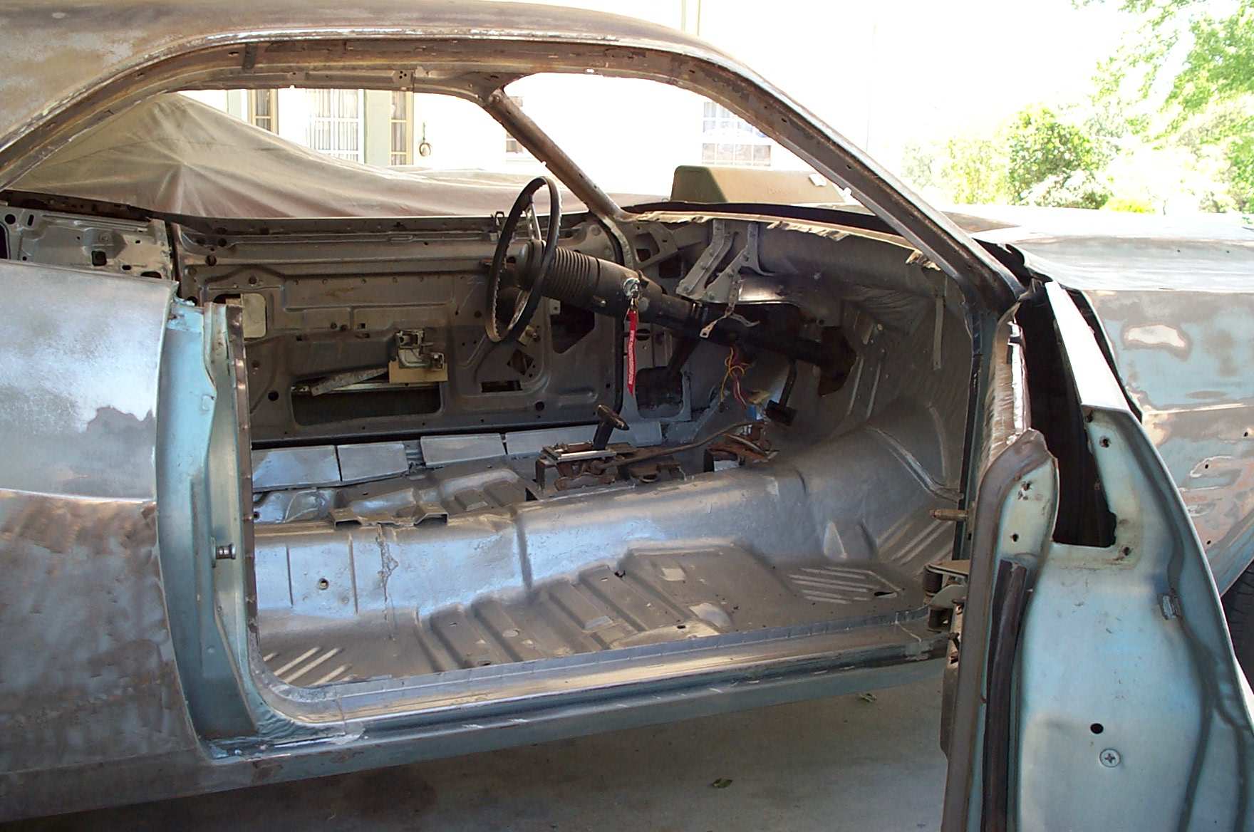

I did the entire interior of the car with Por15 and the underside of the body (with black). There will be zero rust for the next 50 plus years. But trying to over paint this stuff is really tough, but for me, unnecessary.
