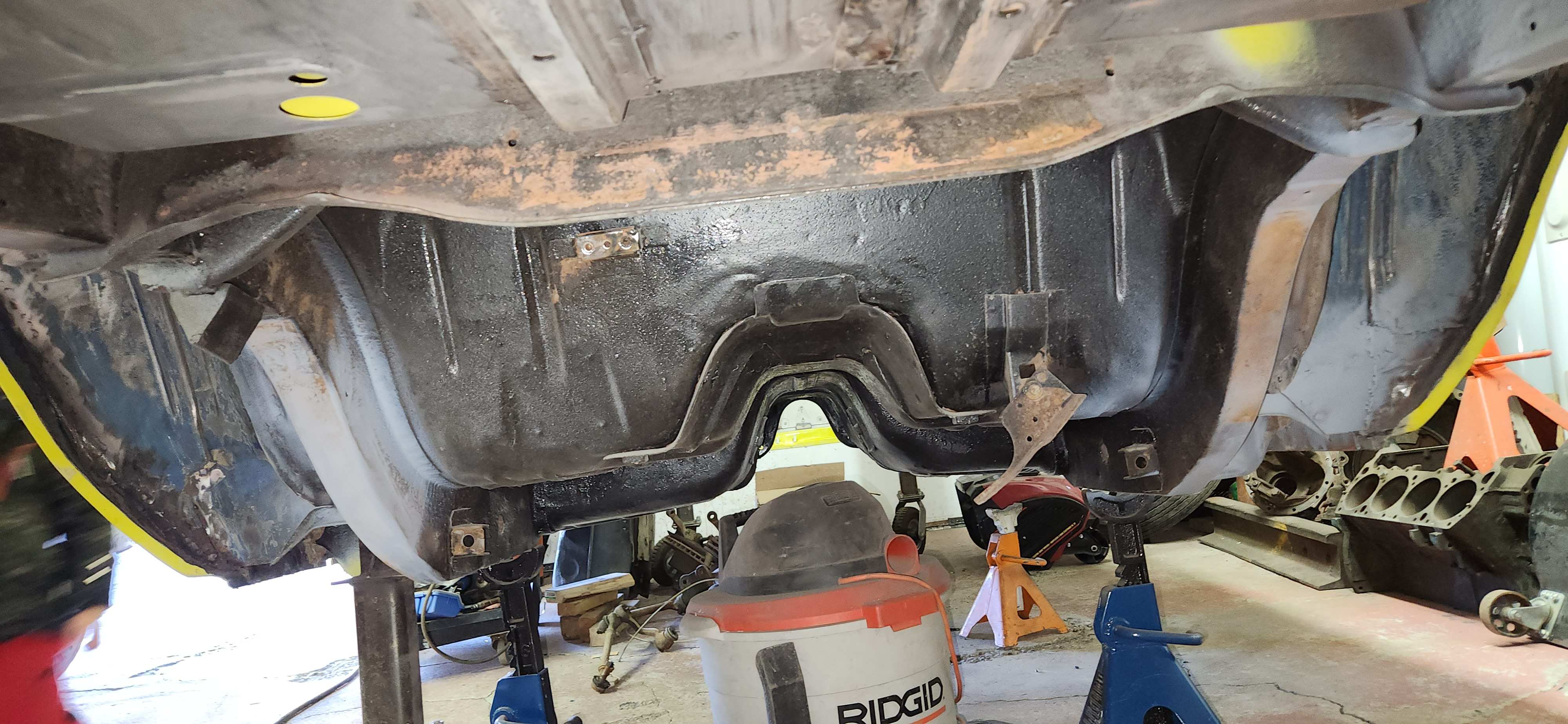

Hello everyone have a 1971 cuda that i am doing a couple of things too and i noticed that on the right side has a hanger bracket. Is it supposed to be like this? Or should there be a second one and the gentleman i bought the car off of never put the left side hanger bracket. If it is supposed to be like this where does the left side hanger mount to? If anyone has pictures it would be great thank you all.

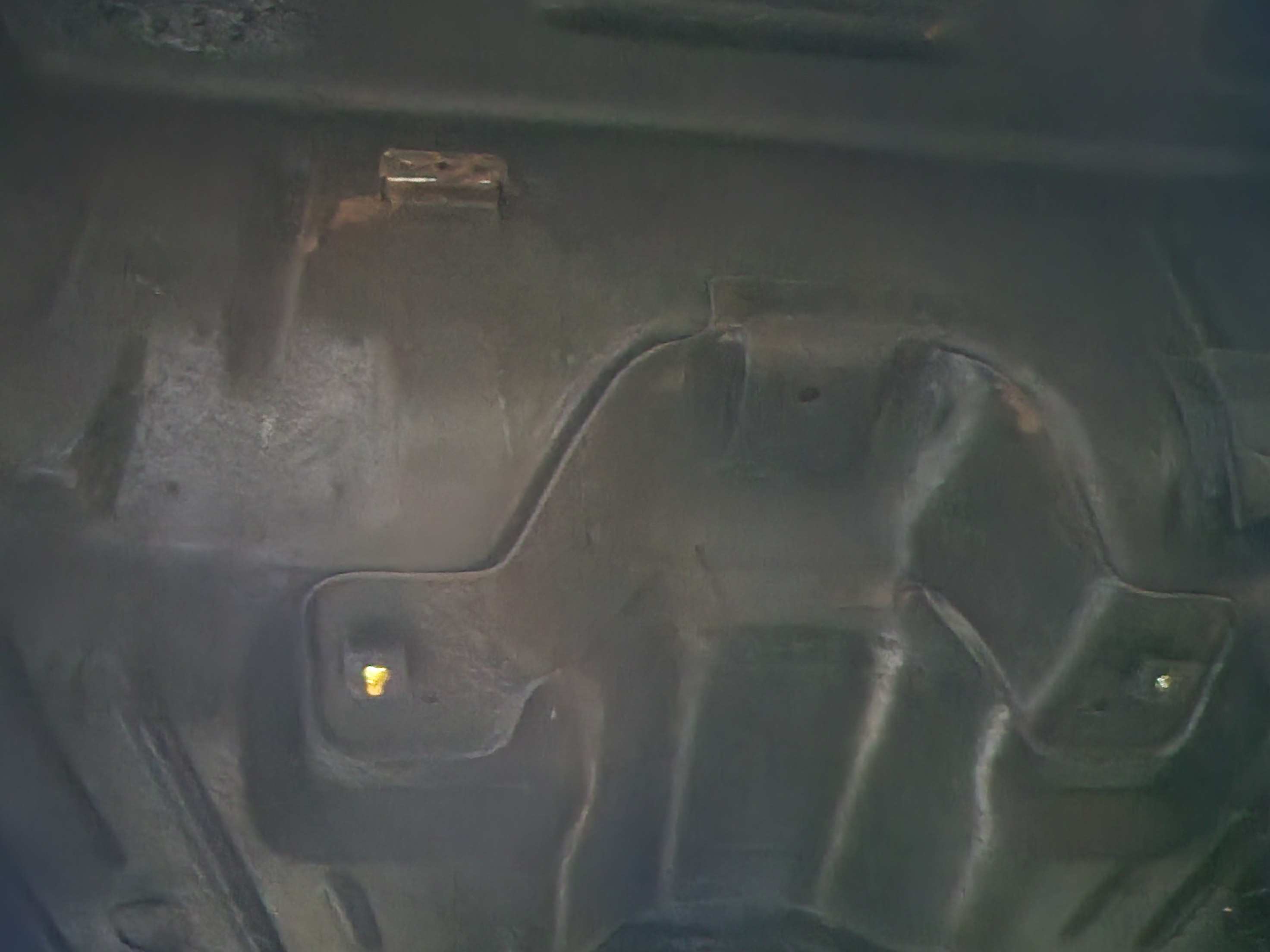

If your car didn't have dual exhaust from the factory, there would be no bracket. But....if you look where the bracket would be, you will see 4 center punch marks. That is where the bracket gets bolted on when you add the second exhaust pipe. Those holes will match up with the aftermarket brackets. Mega Parts has them.

Did you buy your exhaust yet? If you haven't you may be able to buy that when you order your exhaust. When I bought my exhaust from TTI, I ordered everything that I needed from them. My car was a single exhaust car too.
No i haven't ordered my exhaust yet. I do plan on ordering exhaust and headers from tti but I didn't know they had that bracket as well . So thank you for that info and thank you for the picture I see it clearly now
