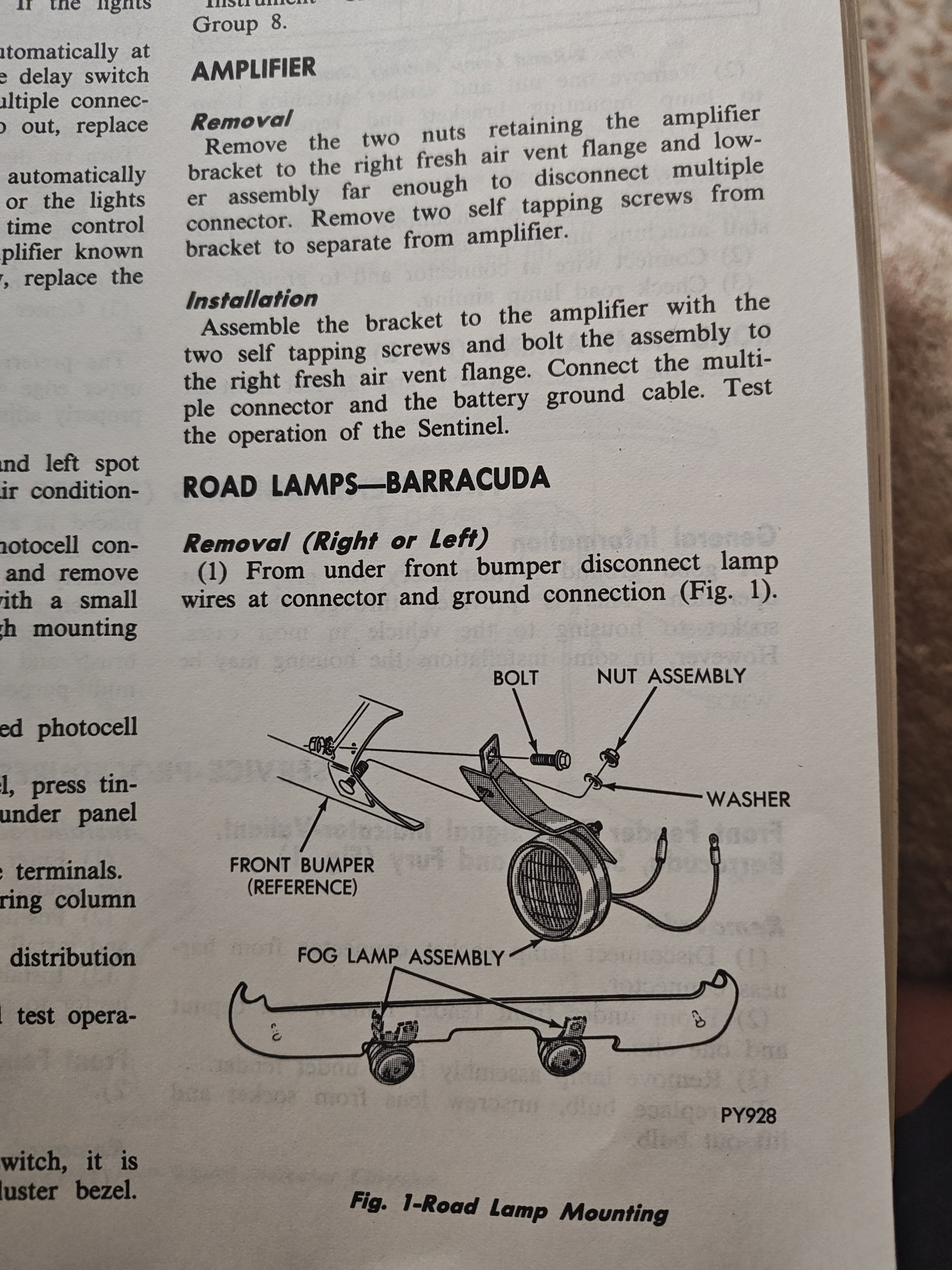

I have a 70 AAR Cuda clone. It was originally a Barracuda with a 383 2 barrel. When I bought it it had a 340 (1973). I would like to install the front driving lights but I'm not sure how the brackets are supposed to be mounted. Does anyone have any photos? Thanks.
The road lamp brackets (the OEM style ones) mount behind the bumper, but in front of and behind the bumper-to-frame bracket. The hemi-sphere hole is for the factory-style road lamp.
Here's a figure from the shop manual (1971) that might help. The brackets are mounted to the backside of the bumper.
