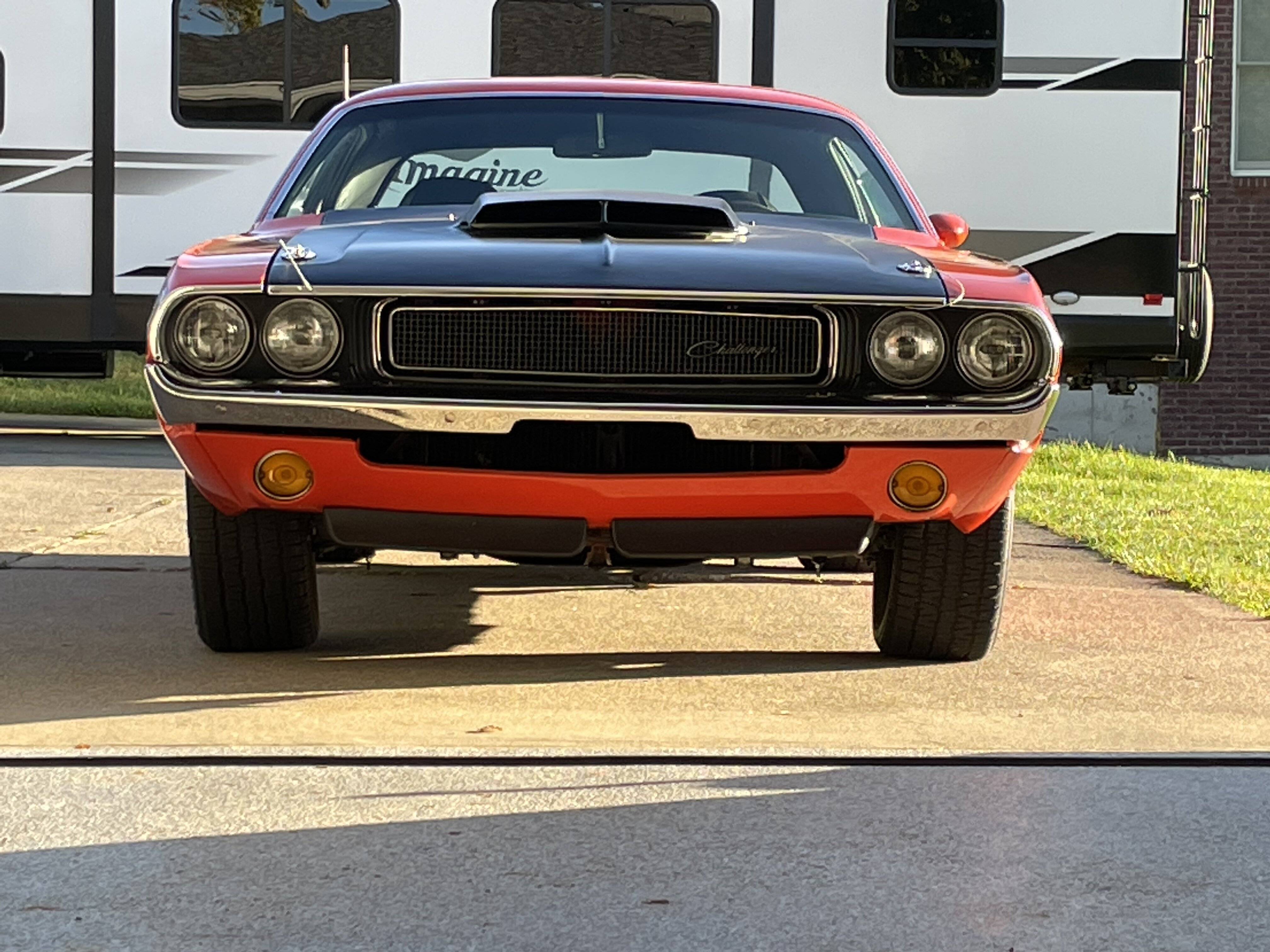

Here is how my front end came back from the shop last week. I don’t believe that they aligned it, but they did replace a passenger lower ball joint. But it is driving as bad as ever and jerking all over the road. The bump steer is also a noticeable problem because the wheel is held straight and it darts with the slightest road imperfections. I am nearly ready to tear apart the front end too. It pops like my back at the chiropractor when going over uneven surfaces or when the weight transfers quickly. I can hear it under my feet. My shop said everything looked good as far as bushings,k frame, etc, and that everything was tight. Any thoughts?

Holy crap man, a blind man could do an alignment better than that! And go get your money back.
Find yourself a reputable shop that can work on these 50 yr old cars.
Not sure what you know about an alignment but there are only essentially 3 adjustments, camber, caster and toe. In your case the camber is significantly off. The alignment cams on the shock towers under the hood are what adjust camber and caster and in general they can be set per the attached picture and get you relatively close. Toe is adjusted with the tie rods.
Can you guys share some good specs for a radial tire car? I have to think they would be a bit different from bias ply tires. I had a tech in our shop align mine way before the restoration and it was great. He’s retired now and I don’t know what the settings were. ?
You will most likely NEVER be able to get desired negative camber with desired positive caster UNLESS you change to aftermarket upper control arms, or at the least... install the Moog K-7103 offset bushings (installed in reverse position). The original factory setup upper control arms simply don't have the available adjustment range or geometry designed into them.

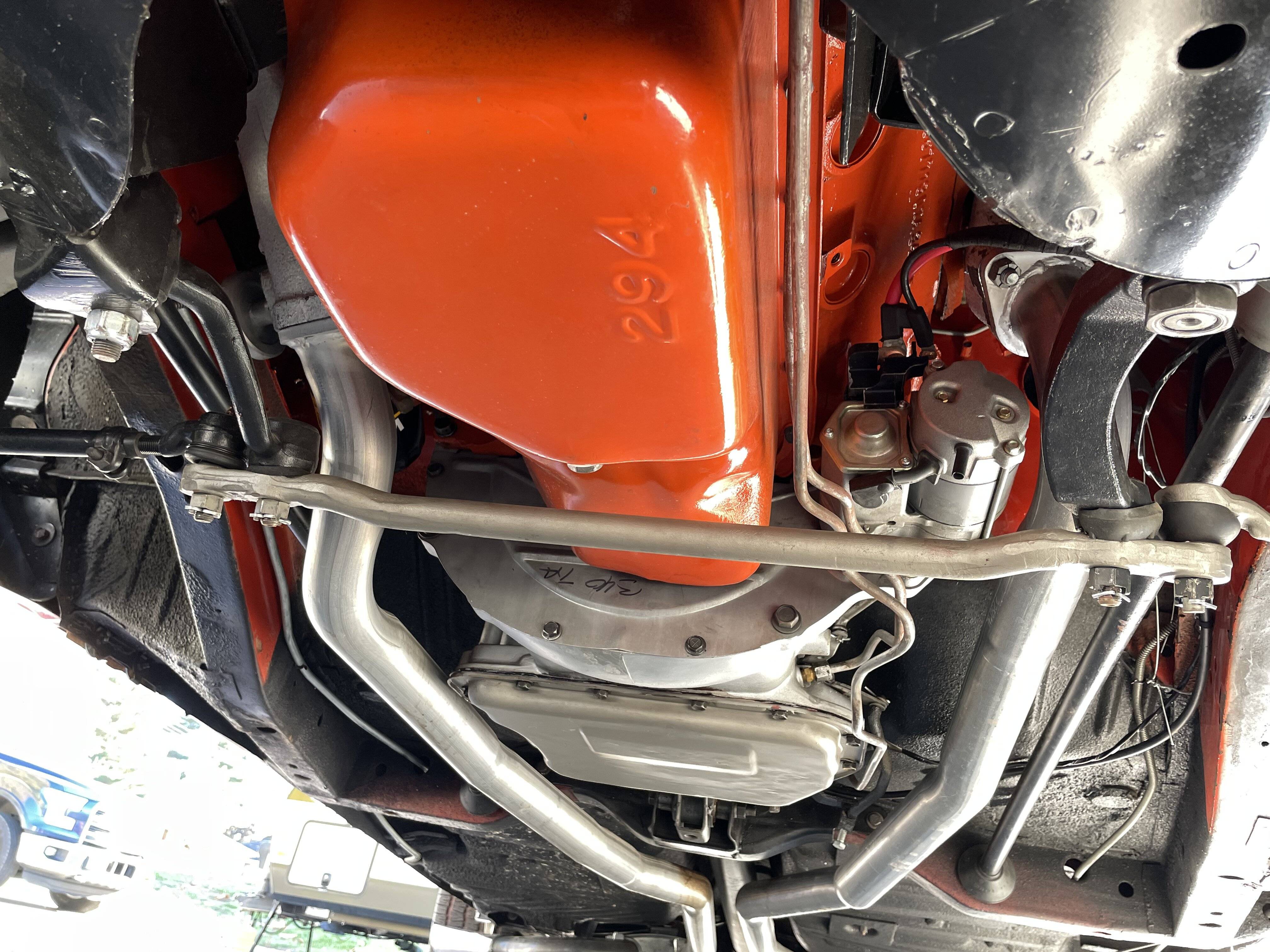

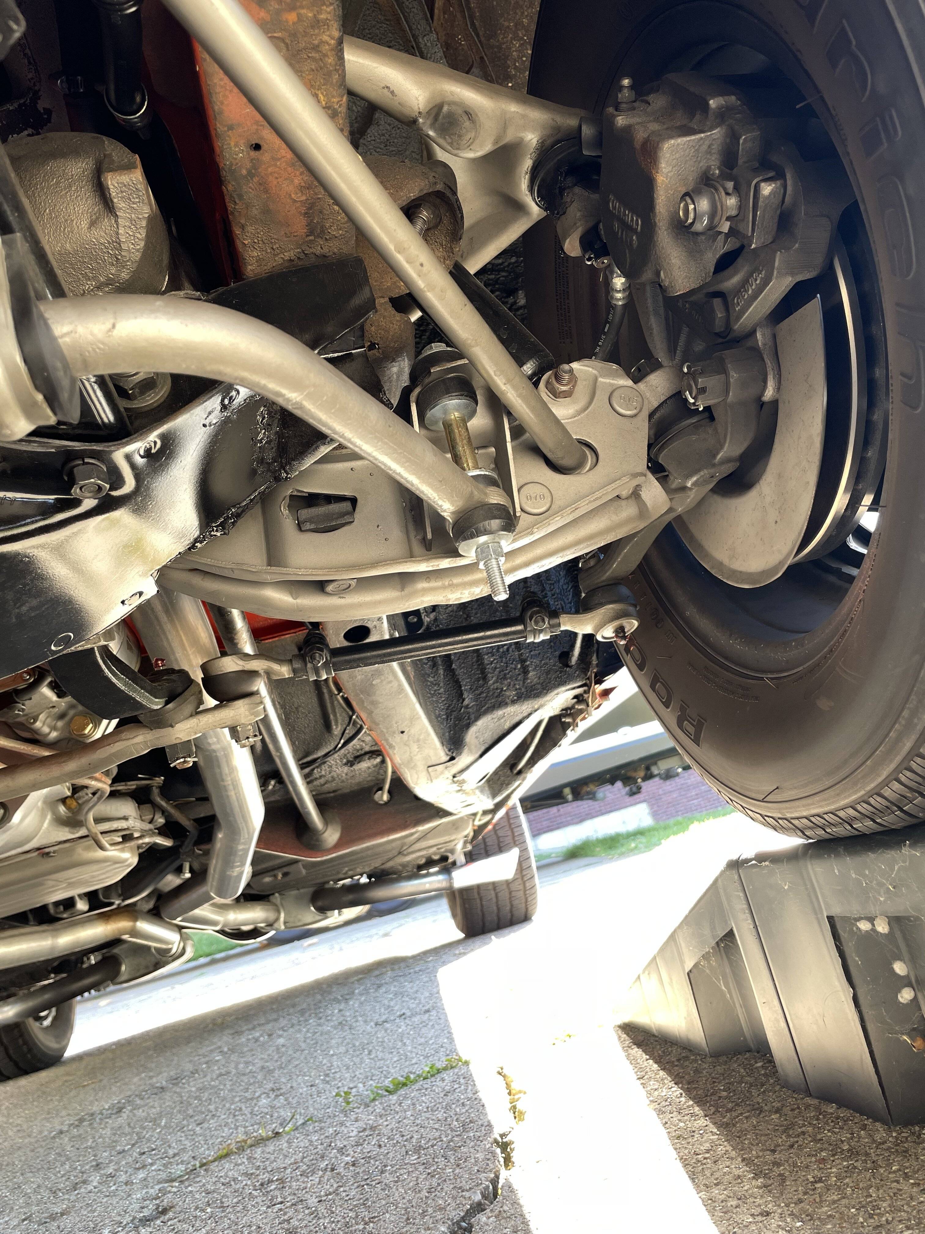

Took the day off work so that’s why so many posts today. Took some pics of my car’s undercarriage. Found that both my Pittman and my idler arm are both fast ratio. Knowing that my steering box is not, would this be a reason for the steering being so wonky feeling at high speeds? I’d like to switch back to standard if it will make a difference. I am ready to take the car for an alignment, but I’m gonna get new UCAs, torsion bars and maybe strut rods from firmfeel first and I want to have this guy do the front end work and align all at once. I also want him to diagnose the clunking sounds in the front end. It all seem tight and fairly new.

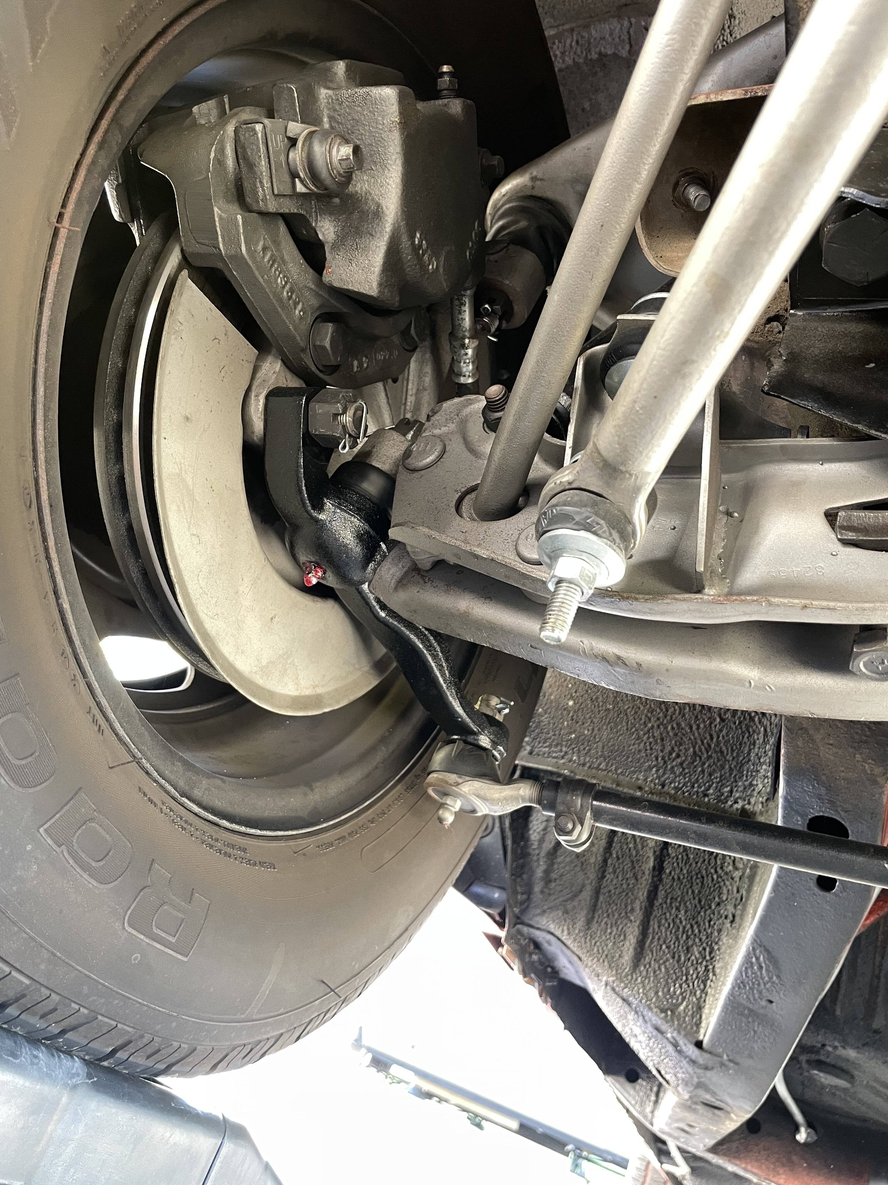

I noticed that the passenger side tie Rod connector is different than the driver. The last shop did replace a ball joint on that side. Maybe that’s why it’s different.

I doubt the arms are responsible for the "wonky" steering unless they are sloppy in their connections. Putting FR pitman and idler arms onto a "standard" box is common and does not adversely affect the steering in and of themselves. If you are having a steering/handling problem it more than likely is the alignment but it could be any number of things; worn parts, bad tires, bent wheel, sloppy steering box, etc.
One thing that no one has mentioned here. The original TA box was just a C body box that was modified and cast with the TA designation. It has a larger sector gear than other 70 B and E cars. They also modified the box with internal stops so it stops before it can contact the frame. So the sector for a TA is not just a C body sector. Firm feel can rebuild and make your box do what you need it to do. I agree with everyone else. You need a better alignment shop.
