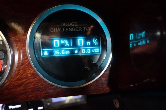

Of course that does work as long as the fuel pressure remains constant , i have separate controller that can measure injector pulses + pulse width i will have to program it to see how accurate it is
Injector control signal (PWM) or dedicated fuel consumption signal (PWM/FREQ)
AUSTA
Apr 16, 2015
949
512
PERTH WA

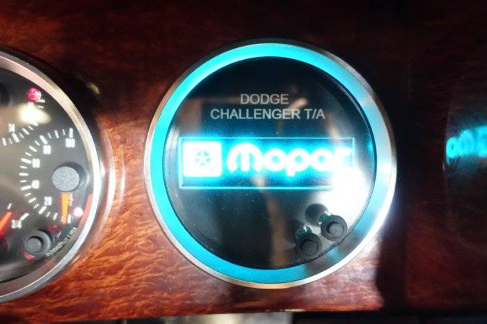

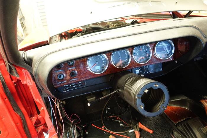

This is the gauge i made up to measure the pulses from the fitech the electronics is available aftermarket but had to make a new circuit board to fit into the speedhut housing every gauge can be programmed for imp or metric also does 0 to 60 feet & 1/4 mile times the boot screen is also programmable to your own bmp
