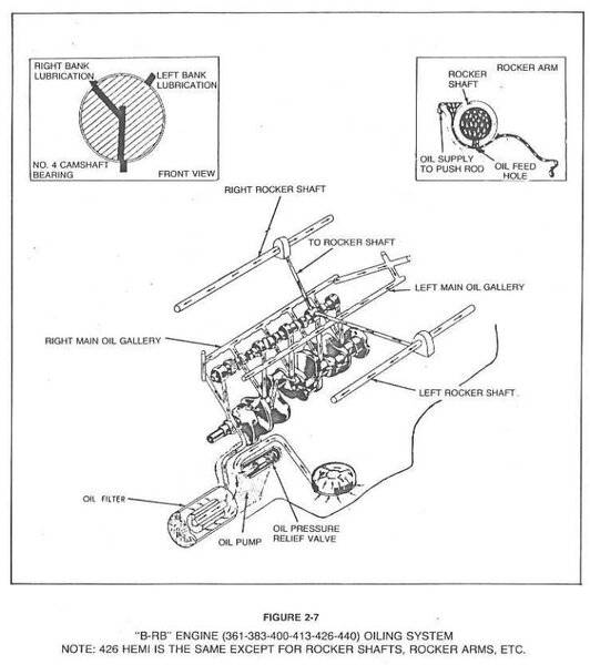

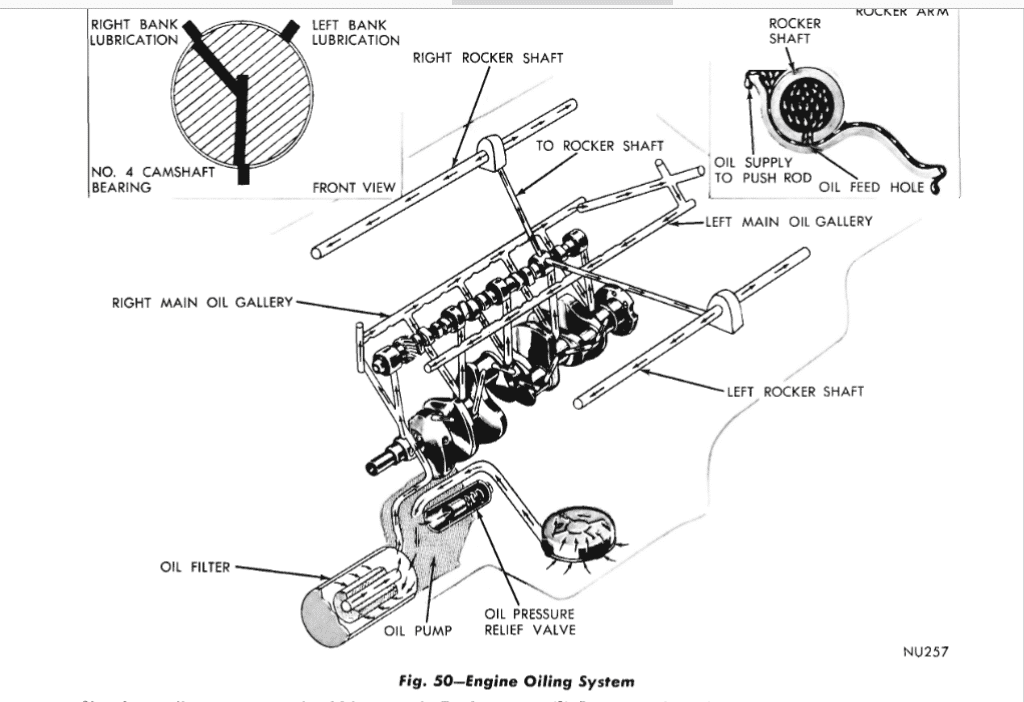

When you were spinning the oil pump (clockwise small block, counter clockwise big block), did you slowly rotate the crankshaft to align the oil galleries on the #4 camshaft bearing? See digram below.

Several have asked the question, are you or someone turning the crank as you are spinning the pump? This is the only way to know that your oil galleries and rocker shafts are not plugged.

The video I did the motor was already primed 10sec. It was about 30 seconds or a little more. Used a 1600 rpm drill until I started to start to see oil. { Think about it an engine running at 1200 rpm cold start high idle. Cam turns half the speed 600rpms. Pump is turned by the cam. 1 to1 from cam to to pump drive? Just a guess. So a drill running at 1600rps it takes about 30second or more to feed oil to the motor. So the motor running 1200 rpms will take 3 time longer or more? And it is only being delivered in pulses. (drill also has a 3600rpms I don't recall what speed it was on.) That's why any engine should be primed. Remember to turn the crank until you find the cam position to line up with each side of the oil galley.
