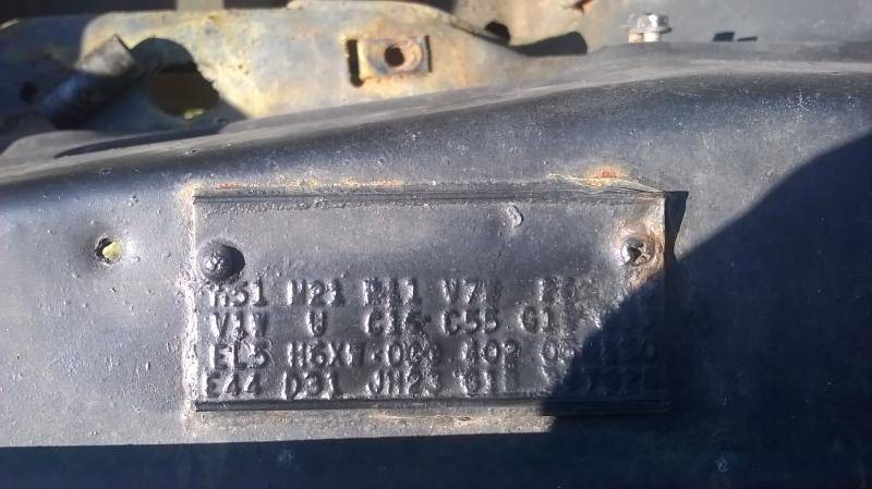

Well I decoded what I could on my fender tag when I bought the car, now that I am tearing it down and prepping the whole restoration process, I cleaned up the fender tag and completely decoded it. I'm not trying to say my car is special or unique, I could be completely wrong but a few of the options and how it was built, I'm curious if it's even semi rare or if ayone has seen something similar. Again it's probably not but I want to consult those more knowledgable then I on this.
JH23:
Dodge Challenger
High
2 Door Hardtop
C1B: 225 145HP 1-1BBL 6 CYL
1971
Dodge Main, Hamtramck, MI, USA
347628: Sequence number
E44: 318 cid 2 barrel V8 230hp
D31: A904 3-Speed Auto Trans.
EL5: Butterscotch Exterior Color
H6XW: Trim - High, Vinyl Bucket Seats, Black/White
000: Full Door Panels
402: Build Date: April 02
058150: Order number
V1W: Full Vinyl Top, White
U: USA Specifications
C15: 70 only Deluxe Seat Belts
C55: Bucket Seats
G11: Tinted Glass (all)
G33: LH Remote Racing Mirror
H51: Air Conditioning with Heater
M21: Roof drip rail moldings
W11: Deluxe Wheel Covers
V7W: Accent Stripes, White
26: 26in Radiator
challenger6pak
Feb 27, 2011
4,092
924
It should be an E24 not E44 coded car. A nice color combination; but nothing is outstandingly rare on the car.
wyckedtanker
Sep 10, 2014
42
Oklahoma
ok I could be wrong wouldn't be the first time but E24 is for the slant six and E44 is the 318 2 barrel according to the codes I have pulled up again I could easily be wrong, but I know mine came out of the factory with a 318 doesn't matter as I doubt it will be going back butterscotch, the car is plum crazy now probably going with GB5 true blue metallic to match my wifes 71 Demon
challenger6pak
Feb 27, 2011
4,092
924
The C code is for a 225 6. Your car came with a 225 not a 318. 318 code is G. I personally like the butterscotch.
Your right I had to go look at it closer it's g1b 318 with the e44 318 WP_20150815_16_46_41_Pro.jpg

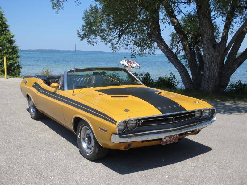

Well when I broke it down it seemed somewhat rare too me, it probably isn't but a butterscotch car with white vinyl top white pinstripes and white interior, every butterscotch car I have seen has black top and stripes or a white convertible top

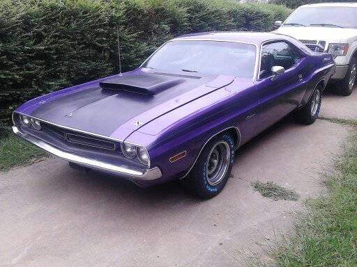

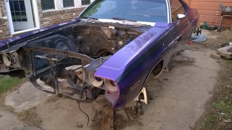

Well it's no where near origial now, I bought it like the first pic. now it loos like this, reparing to go to the body shop for new quarters and wheelhouses. I wanted to paint it gb5 true blue metallic to match my wifes demon, but I'm starting to thin it should go back original inside and out except for the 440 I have for itchallenger 004.jpgWP_20150410_19_24_03_Pro.jpg

Take the tag off and read it from the backside. Many times old tags are easier to read from the back.
