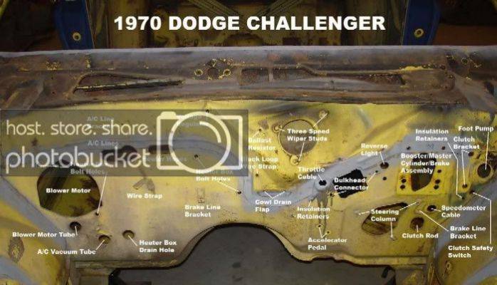

I'd look at the cowl weather stripping under the hood top of firewall. That's the first line of defense from under hood fumes - it should direct them out to the sides away from the cowl air intake
Then seals in the heater box - I believe the heater draws air from the passenger vent even when it is closed.
It could be other seals on the firewall too - there is a number.
Insulation should help heat and sound but not sure how it would help fumes.

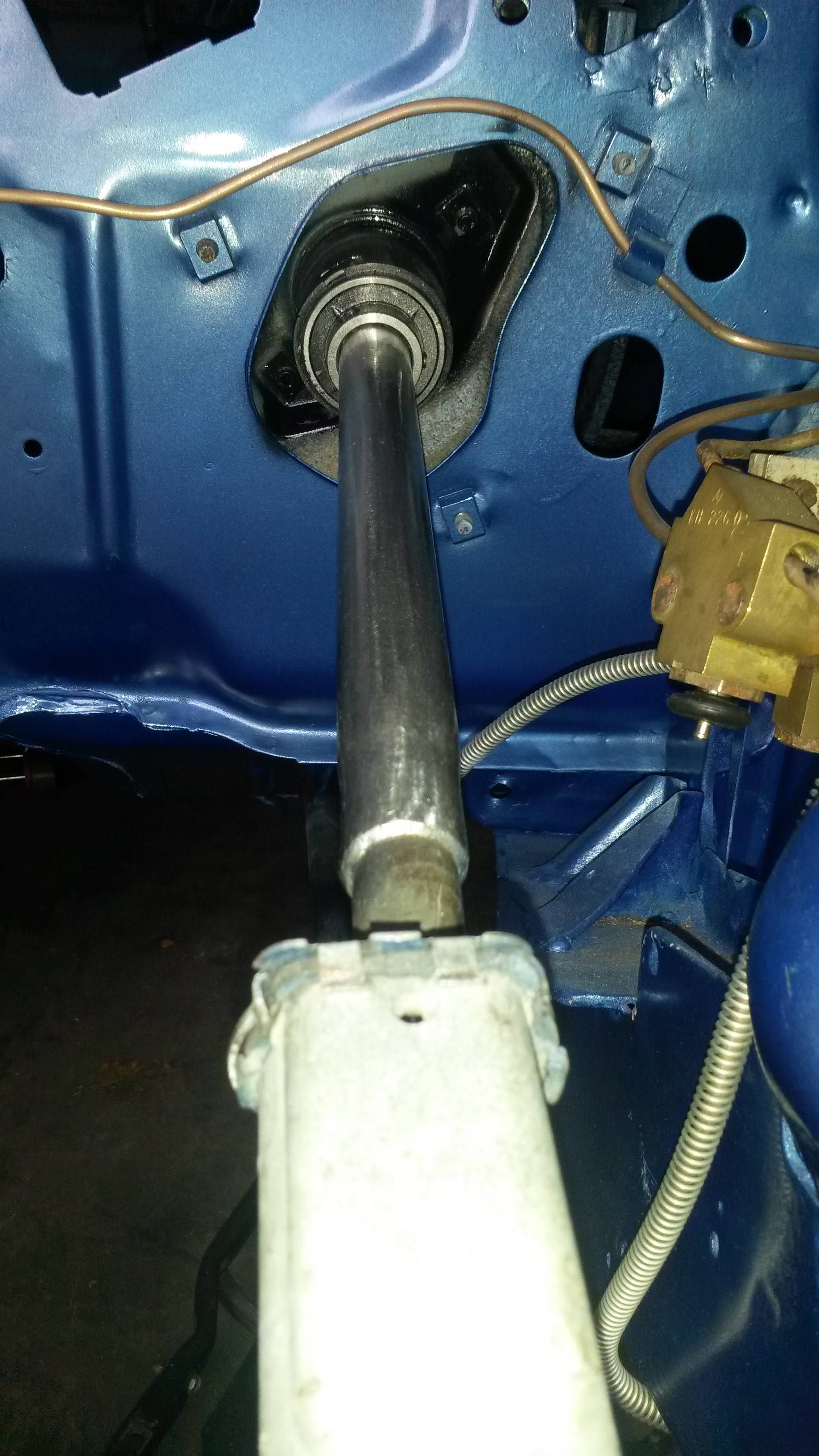

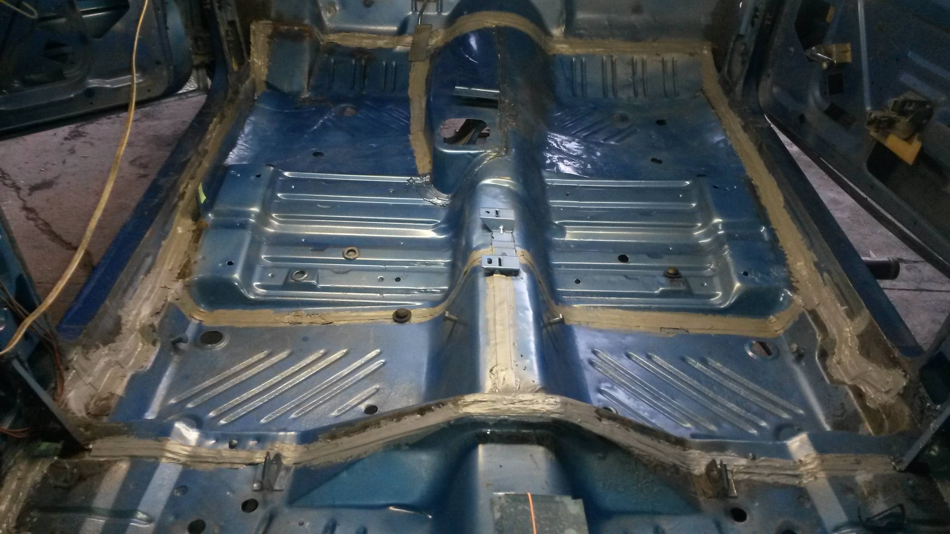

2nd I would check all the firewall holes and steering tube .3rd check floor seams and tunnel holes.
