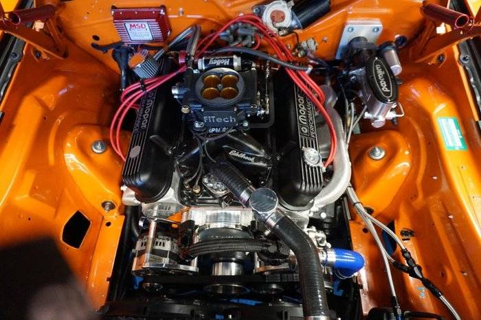

Picked it up of a mate for $200 i think they are around $400 being 2 pumps if 1 fails you can turn over to the other although the pump itself is overkill for a stroked 340.
If using return to tank circuit use 3/8 main 3/8 or 5/16 return make sure any rubber joints are using EFI high pressure hose with good clamps
Dont use the small sintered brass filters they clog very quickly use a good holley or equivelent i use 20 micron rear with a 5 micron front .
When fitting put the supply into a bucket & purge the system before connecting to the EFI
Used AN6 fittings on carby connections

That looks great!!!!! Thanks for the information as well. Finally got mine running again after dropping a valve in #7 last year and potentially putting the Fi setup on in fall.

Is that a right hand drive too?!?!??
