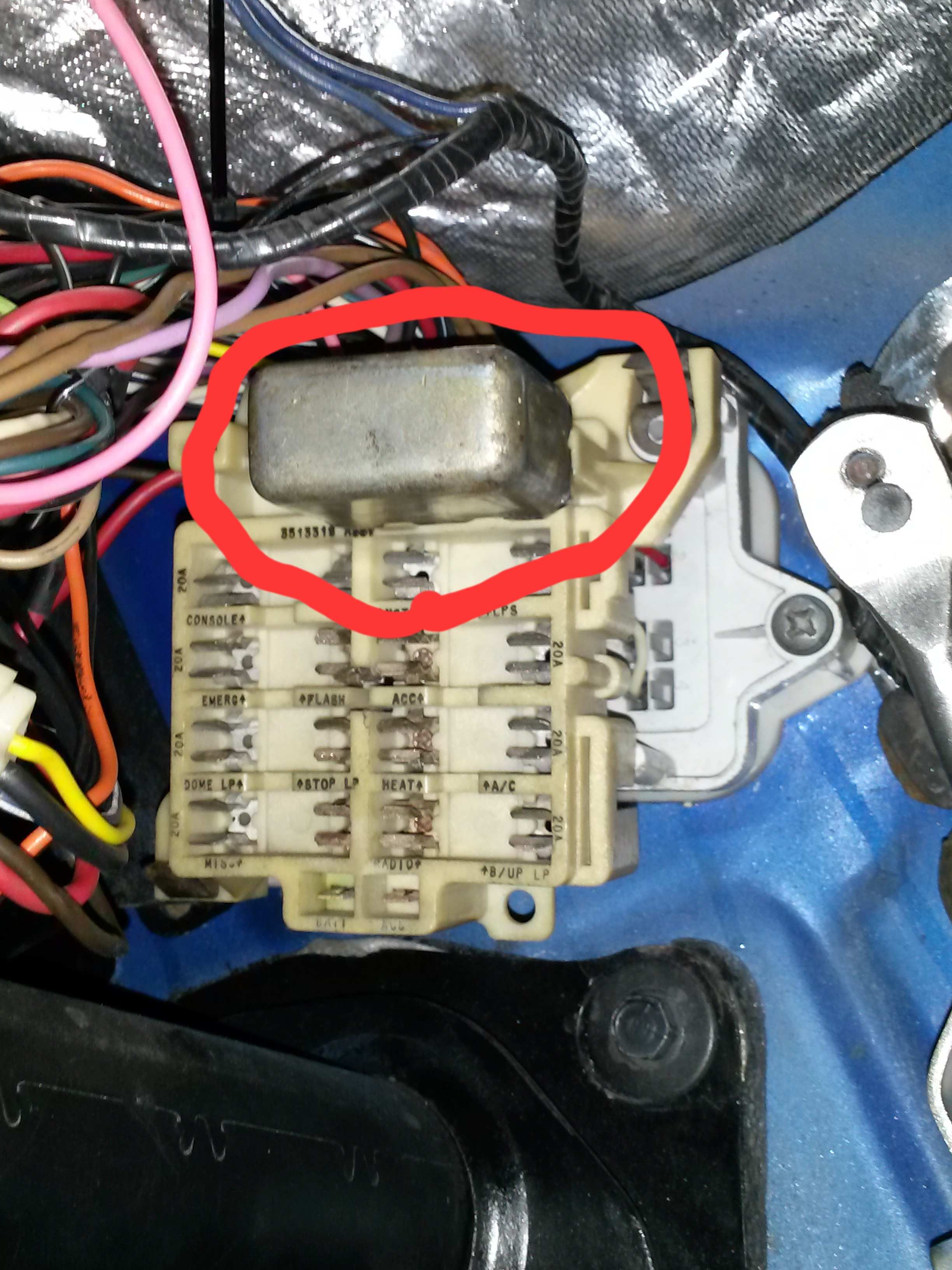

May 28, 2025 #1 M mitchDublin Member Joined Apr 29, 2025 Messages 12 Reaction score 11 Location Dublin, Ireland Hi all, this relay is missing on top of fuse board , side flashers/indicators not working, could it be this , thanks

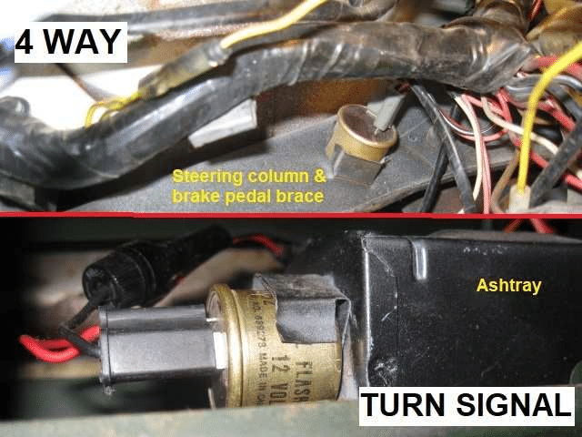

May 28, 2025 #2 Challenger RTA Well-Known Member Joined Oct 28, 2018 Messages 5,064 Reaction score 2,878 Location PA Flood city Why does that look like my picture with the horn relay.
May 28, 2025 #3 Challenger RTA Well-Known Member Joined Oct 28, 2018 Messages 5,064 Reaction score 2,878 Location PA Flood city Emergency flasher is on the right side of steering column. Turn signal flasher is on the right side of ash tray underneath the dash.
May 28, 2025 #4 Katfish Well-Known Member Joined May 14, 2022 Messages 805 Reaction score 531 Location Palm Bay, FL Pretty sure that relay on the fuse box is for the horn. I'm guessing your horn doesn't work too.
May 29, 2025 #5 Xcudame Well-Known Member Joined May 27, 2023 Messages 2,743 Reaction score 2,045 Location Southeast Arizona These guys are right! That's a horn relay. The flasher relay is a cylinder.
