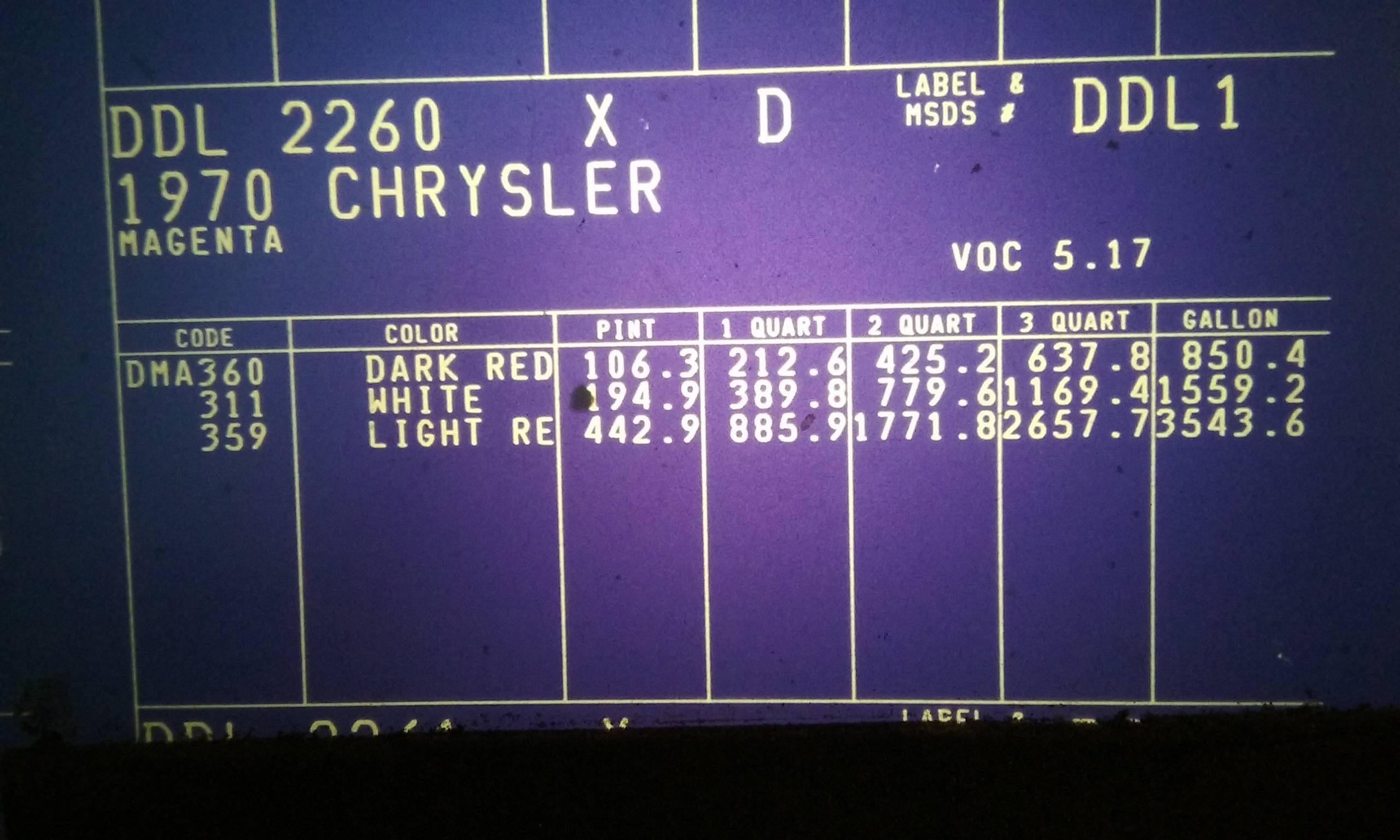

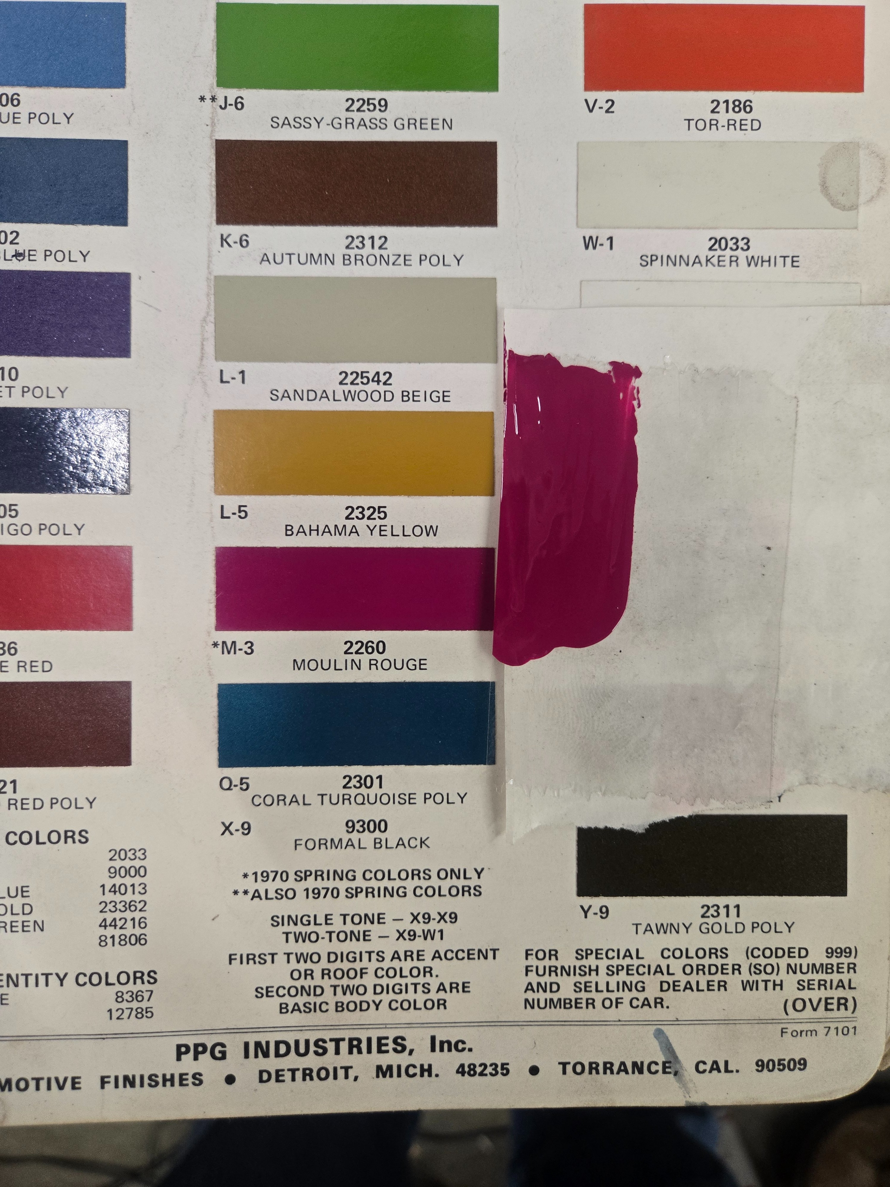

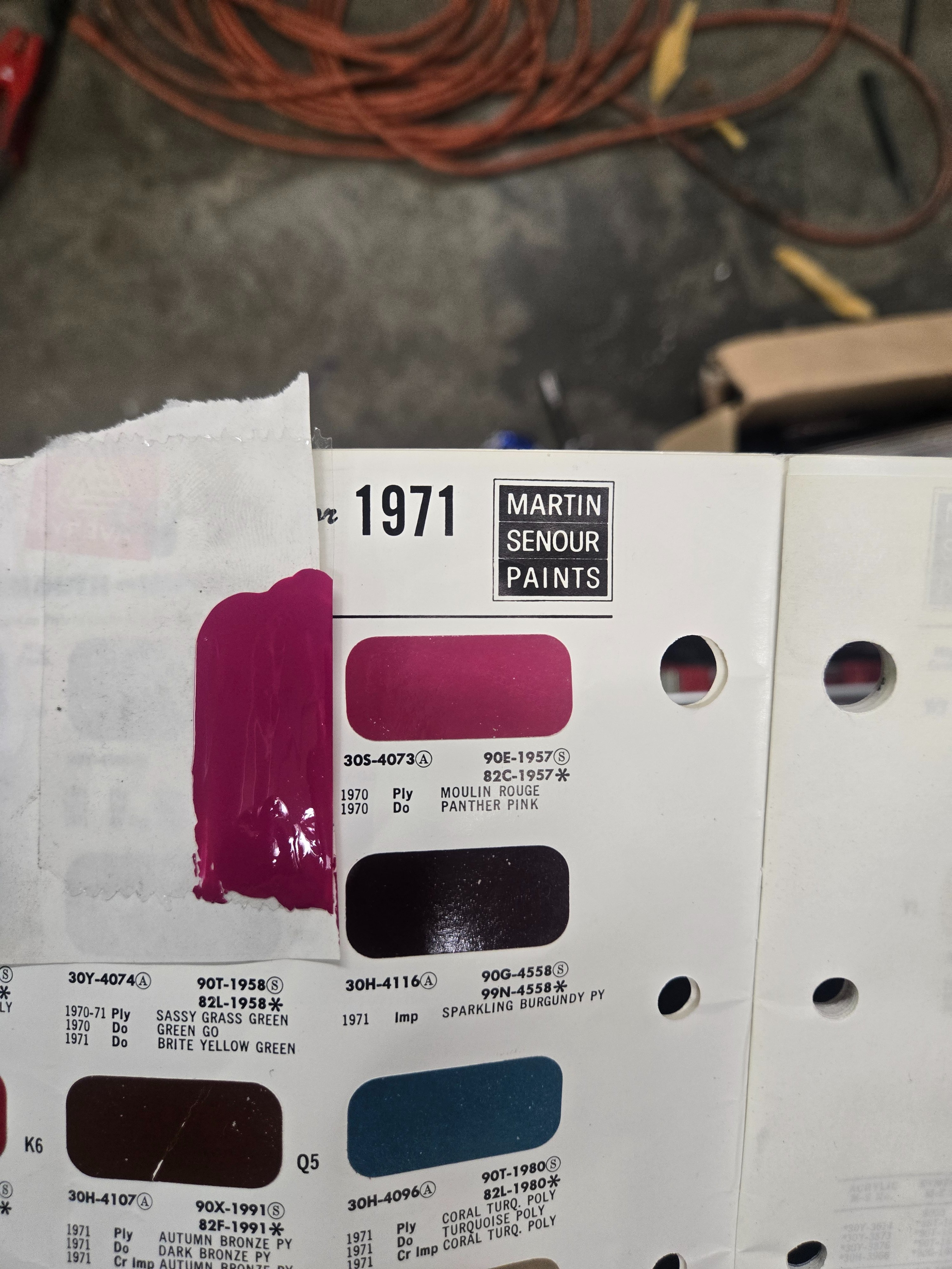

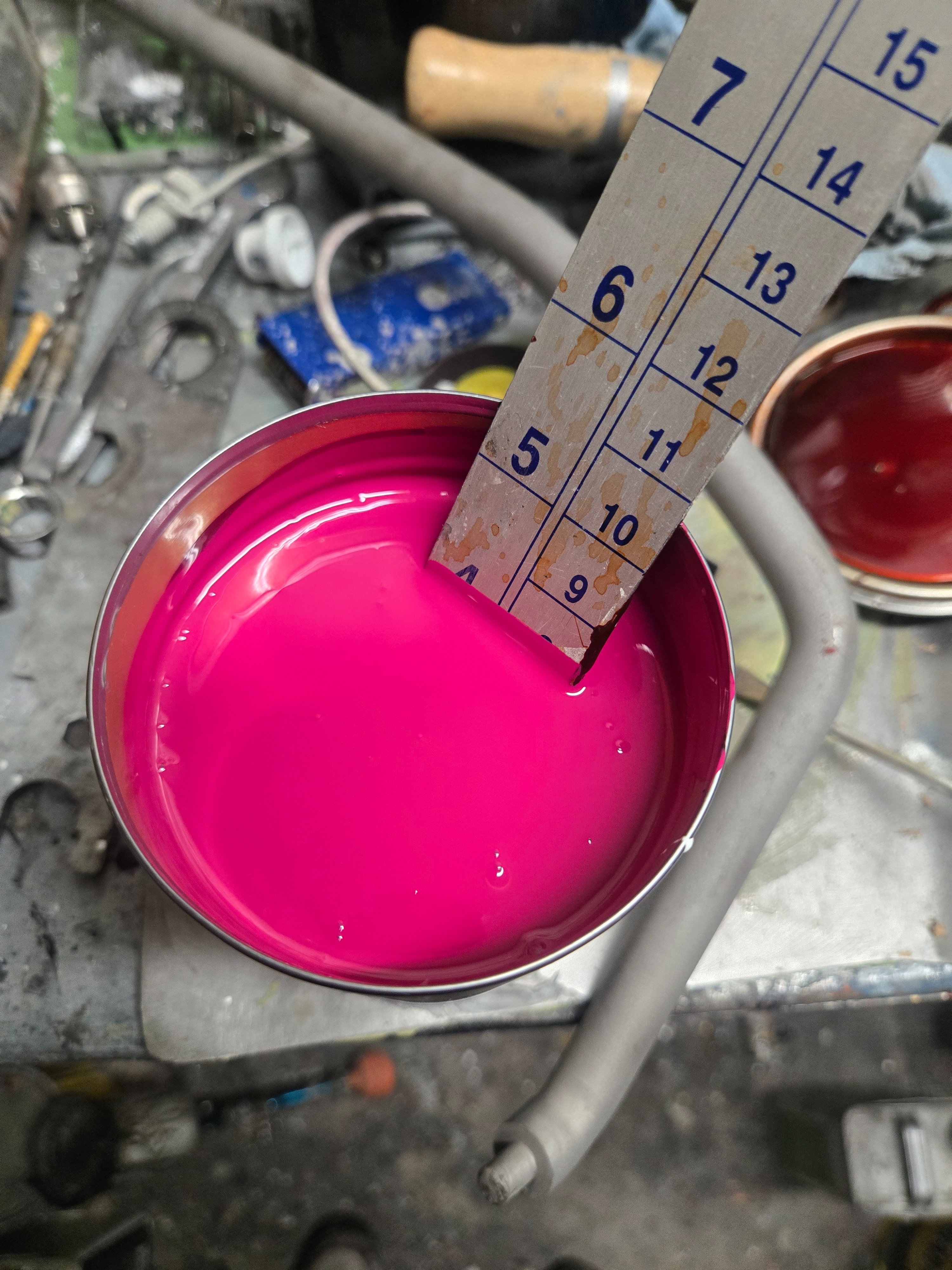

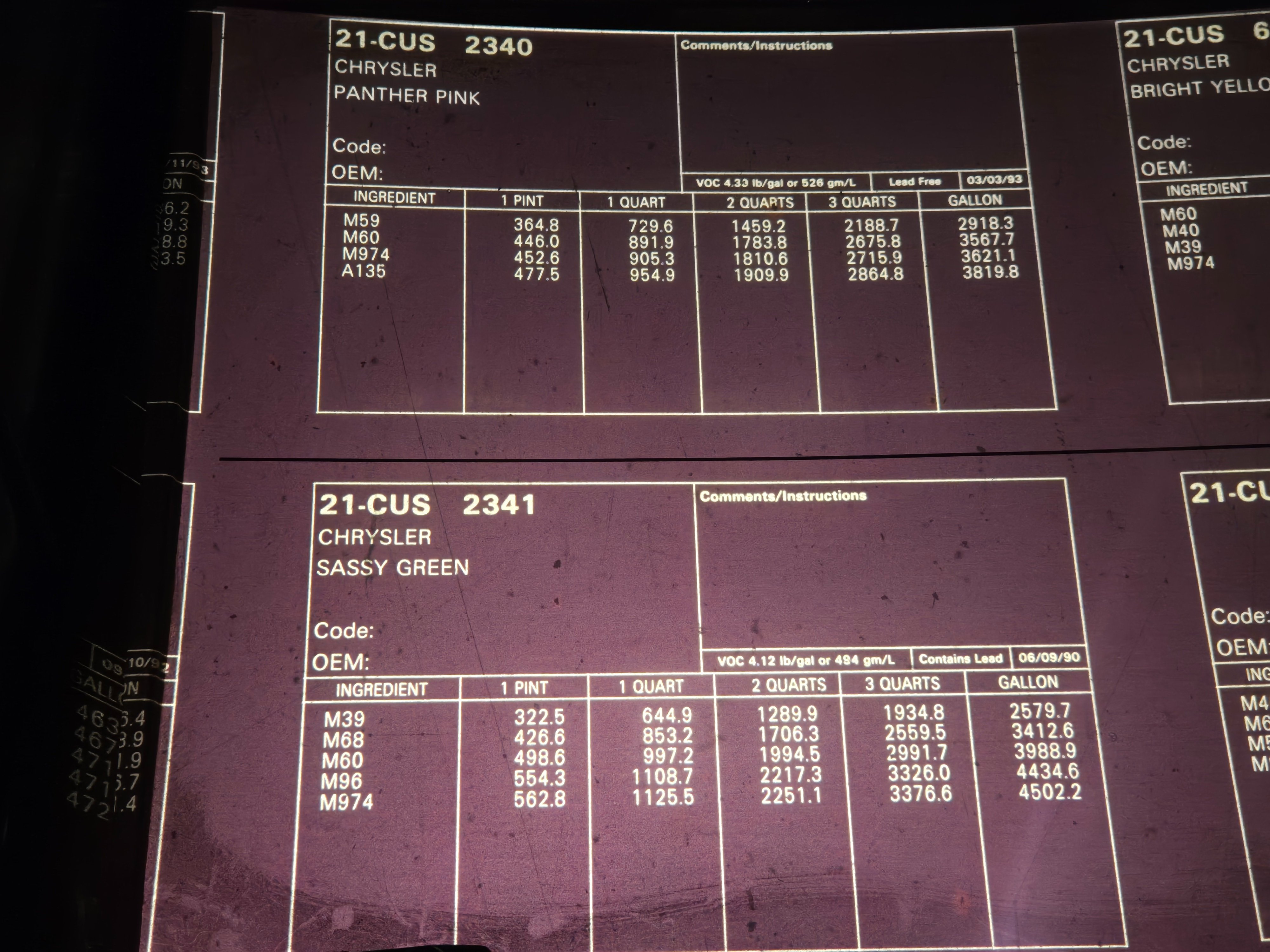

All the mopar colors I've mixed have been pretty accurate. I could do a half pint just to see how good it looks.
Then we could see about a scan or sprayout.
There were a ton of variation to this color, back in the early 80's when I was first exposed to a 70 duster in fm3.
The spot repairs were all off from the original colors. Like how lime light is often off.
