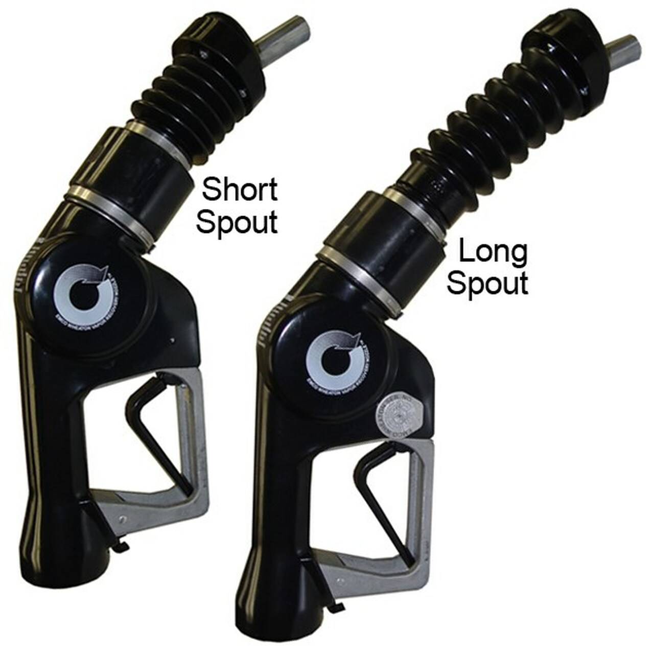

Trying to hold a funnel and work the flippin' pump handle just would not work. In order to get fuel to flow from the nozzle, you have to
force the recovery collar back. When you use it on a modern car filler, you just shove it into the filler hole and that forces the recovery
seal back and allow the fuel to flow..
This is what they look like. The spring is pretty stout so trying to hold that back while holding a funnel...OOPS, I need a third
hand to squeeze the feed lever!!!

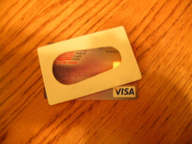

After looking a little bit , there seems to be a partial solution. Make or find a funnel to accommodate the length of the nozzle and the end large enough for flow. weld or braze plate to funnel. Just a thought. looks like Bikers have a work around. I would think the spring rate would be much over 20 lb. Vapor Recovery Fuel Nozzle Tool - SuperHawk Forum
