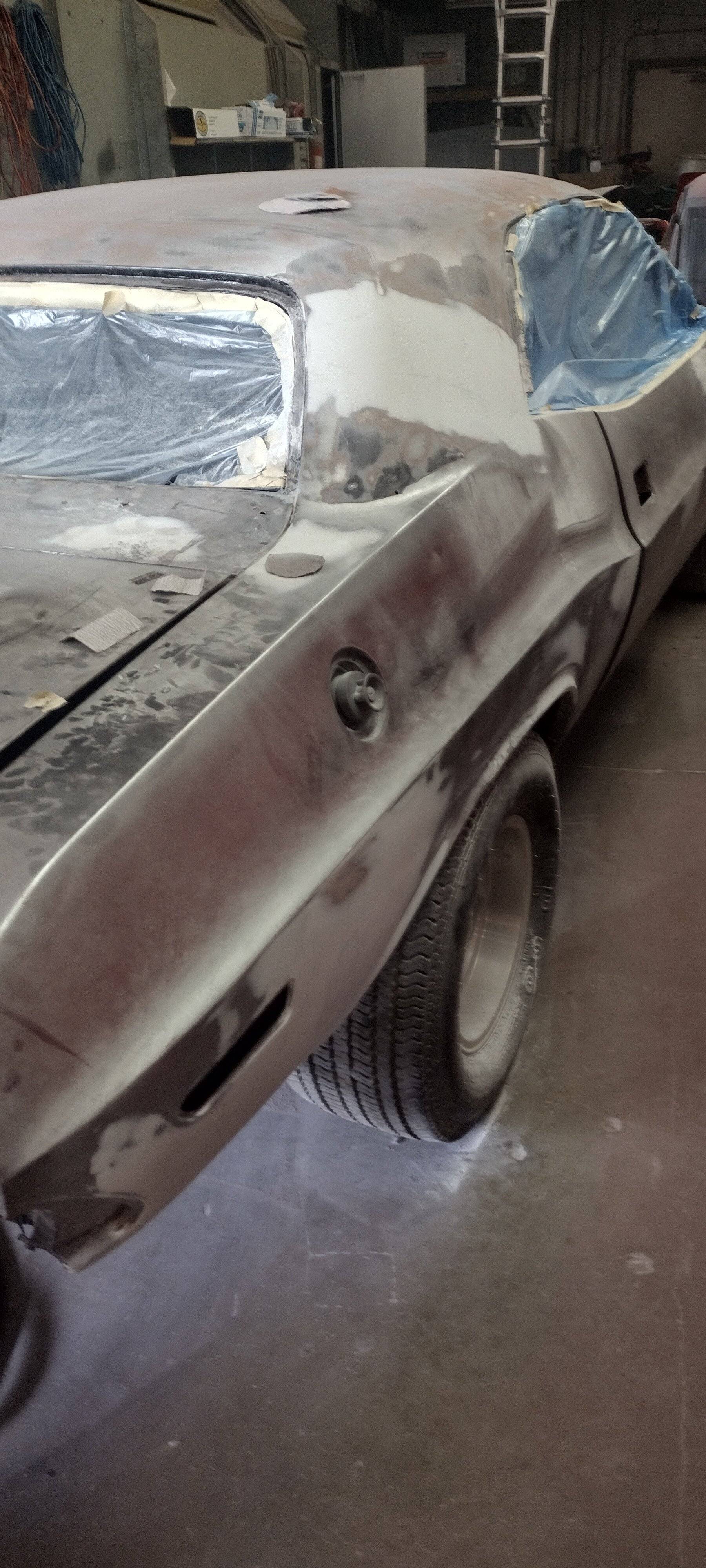

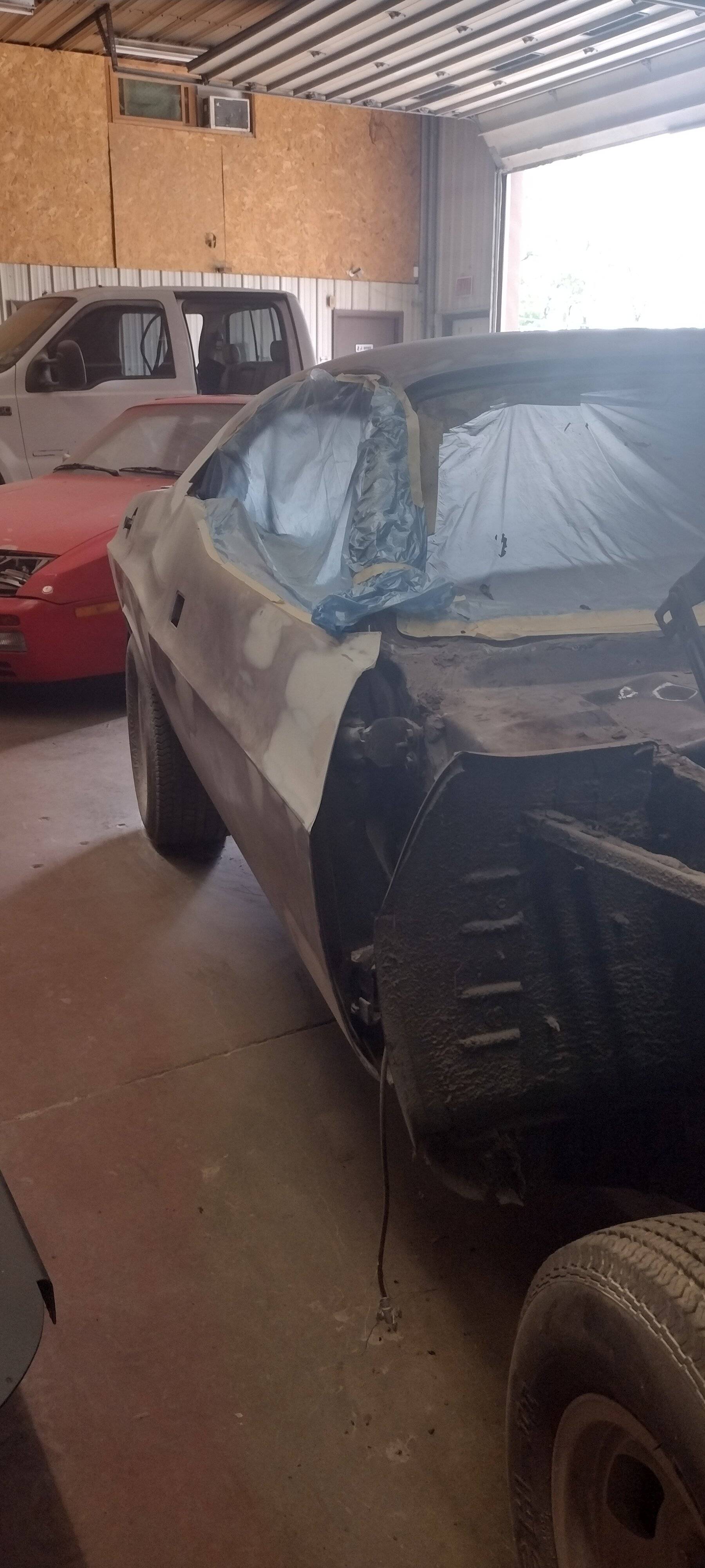

Been a while since I posted on the site and my 71 black v6j rt Challenger is still going thru restoration and very close to being back in black. Slight pitting around the rear window caused the vinyl top to be removed but it gotta be done right. Car was amazing bare except for that. Pure solid steel!
