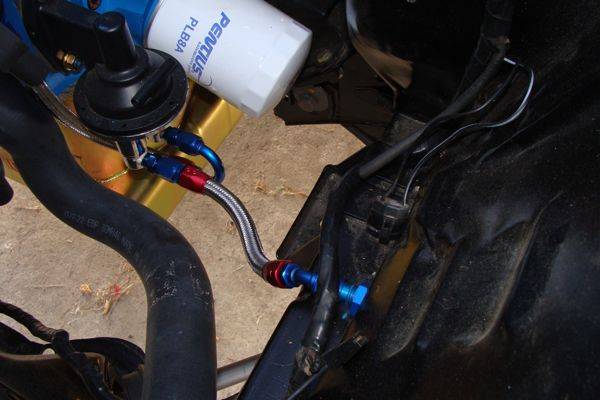

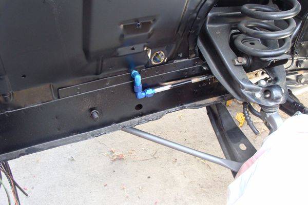

I have done this. You will need -5 for 5/16. Very rare. I went from 3/8 to -6 on my Torino recently and I used a tube nut and sleeve and did a 37.5 degree flare on the original steel line.
