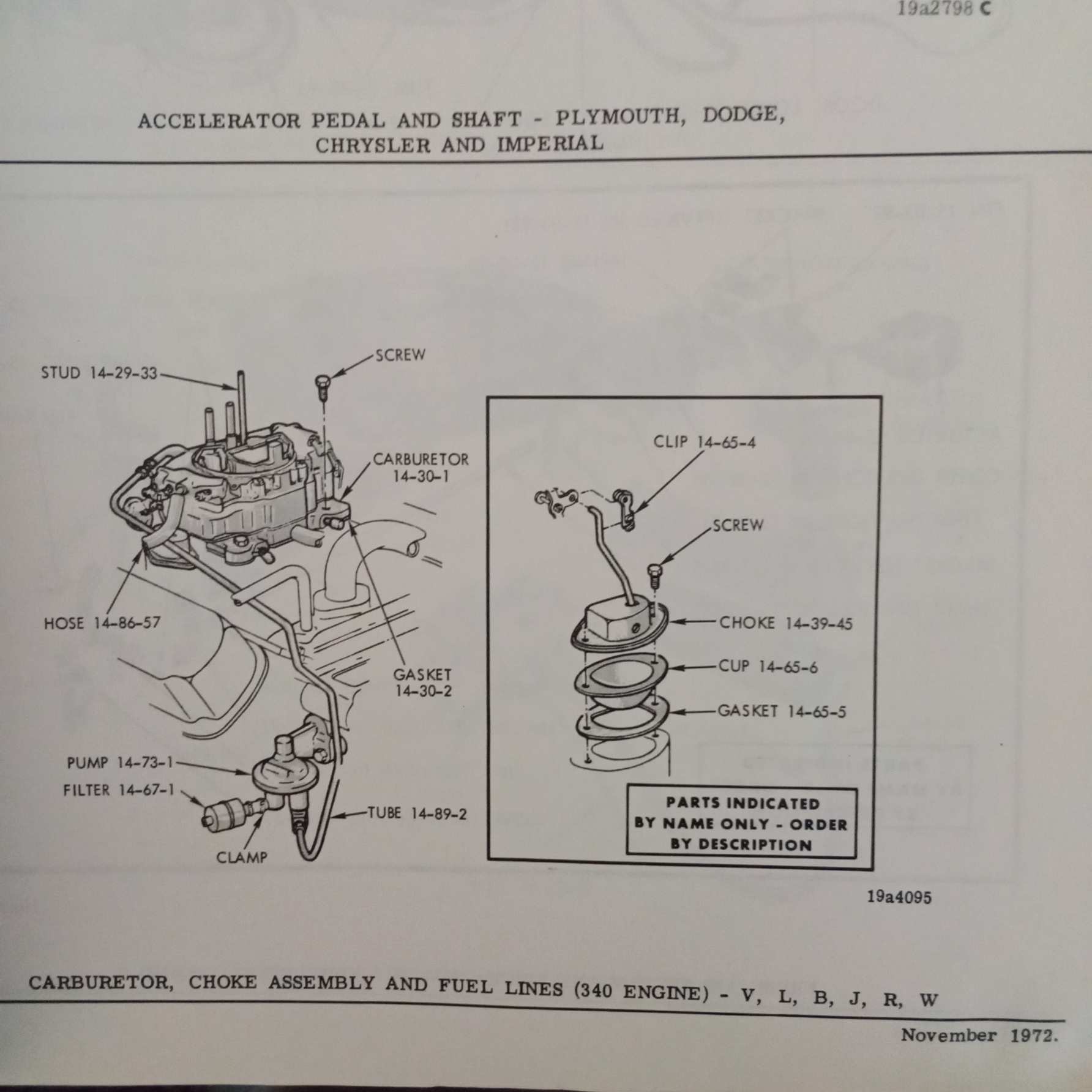

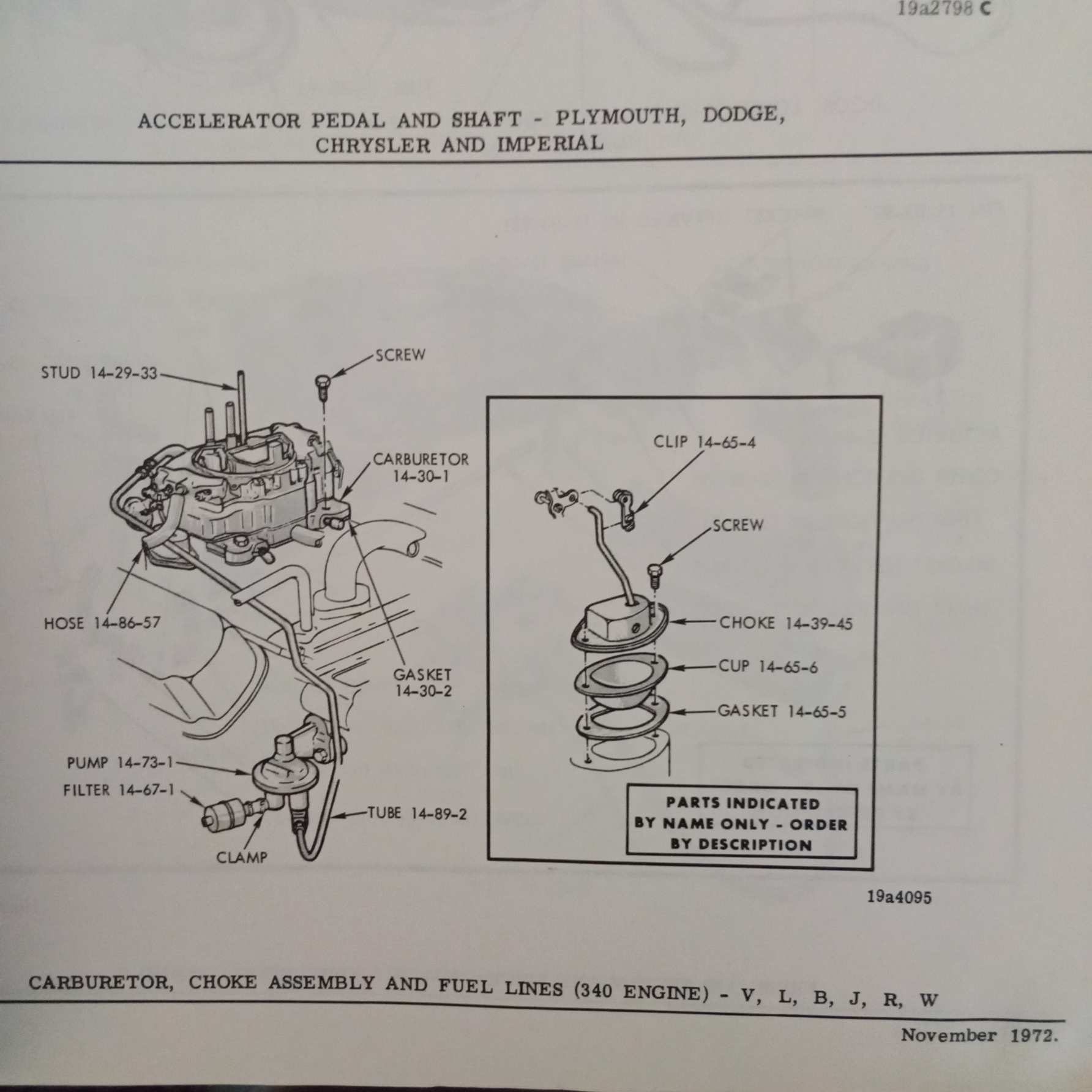

I can't speak for how the '71 Challenger 340 fuel line/fuel filter configuration is but I do know it was different for the '72-'73 340 Challenger. Here's a page out of a late '72 Chrysler Parts parts catalog. As you can see the fuel filter is on the inlet side of the pump. The fuel line I'm having trouble with is the 1-piece line, not the 2-piece line like I stated in my initial post. Thanks everyone that has chimed in on my post so far, it's most appreciated.View attachment 140916

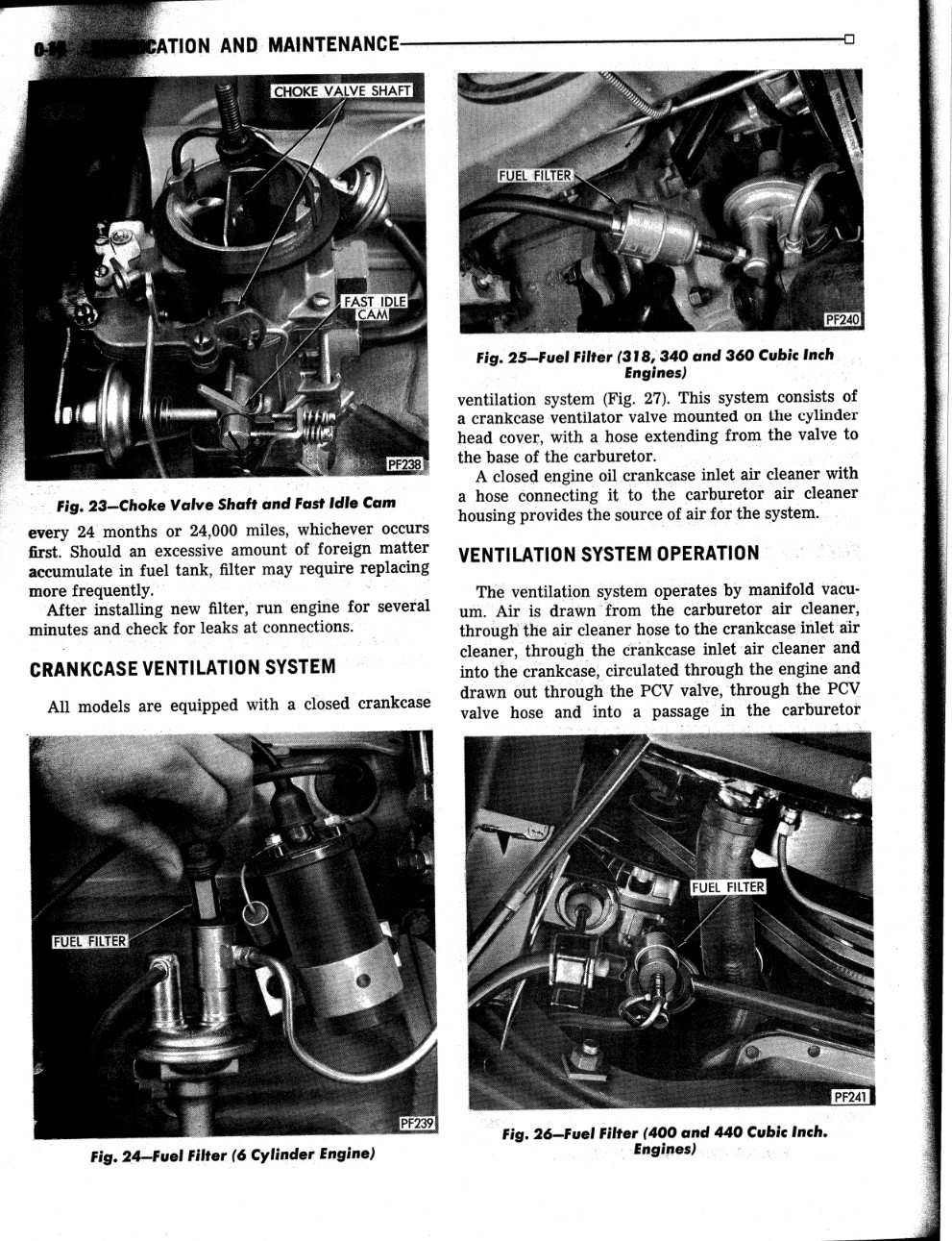

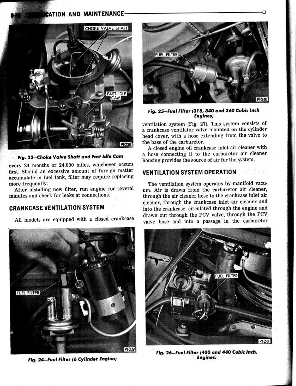

You are correct. Just looked at my 73 Dodge Service Manual and it states " Fuel filter is on the suction side of fuel pump" and even shows a picture (see Fig. 25).
Back to searching my receipts. Fuel Filter.jpg.
