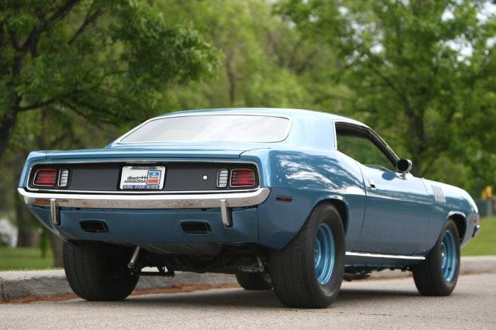

I used a stock e-body width Dana from Dr. Diff. Springs offset. Custom backspace steel wheels. 295/65 tires. Everything fits snug with no rubbing.
8.75 will work until you get traction, then you may have problems. The Dana was marginally more expensive than a reinforced 8.75, so I went that way.

71Plym- Your car looks Great with that stance!
I personally want the body to sit a little lower with a 295 tire or wider and do not want to worried about hitting the 1/4 panel lip, so do you think a B body rear is what I'm needing?
What was your backspace?

John, I have found that every car is different. I did lots of measuring and test fitting before anything was finalized. I used hemi style springs with 1" over from ESPO, and they are offset inboard 1". I ran string lines and plumb bobs to make sure things would not hit the quarter panel. I have steel cop rims widened to 8" with custom offset to fit my combination. Offset is in the order of 4.5". A B body rear is about 2" narrower, so you gain about 1" per side. I made that up with my wheel offset. The advantage of a B body rear is that the spring pads will match up with 1" inboard springs on a E body. If you don't weld, then a B body rear may bolt in. My rear was entirely new and made for my car so I was not worried about spring pad location.
IMO, you probably don't really need a B body rear. However, do lots of measuring of your car before final install. Also given the cost of an original dana, I would suggest using aftermarket like a Strange 60, or modify a truck dana to fit your car.
