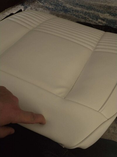

Might be going about this backward but I have all the hardware for my bucket seats and not really sure where the holes are to mount the latch. I can feel one hole in the frame but the latch takes two bolts. Any ideas how to tackle this without taking the cover off?

Thank you for the clarification. I have a passenger side seat currently, the latch is on the right. I didn't realize the latches were different so thank you. I'm having trouble finding the holes for the bolts. I'm guessing there are two. I can only feel one hole. I'll see if i can get a picture

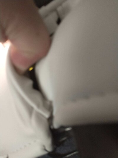

Where my finger is there is only one hole in the frame. i'm guessing this is where the bolt goes for the latch but there is only one hole. I held a flashlight against the vinyl and tried to show a picture but there is only one hole. Shouldn't there be 2 for the latch in the frame?

Yup, there should be 2 threaded holes. I know it's dark in my picture but if you enlarge it you'll see both bolt heads. Try clicking on the picture a couple times, if that does work just download it.

Thank you for the pictures. I think the problem I'm having is that I must be findign the wrong hole. I found this picture and the arrow is the hole that I can feel. Are you able to tell if this is correct? I'm thinking it must be somehwere else because it appears that there is only one hold on each side.

I think you’re right, in your reply #5 it looks like your finger is way to far in towards the middle. I put mine back together after those pictures. I should say that mine Is a Barracuda, whether that makes a difference I can’t say.

The holes are way over in the corner. I tried to take pictures with a measuring tape. Also I pressed down on the seat in the one photo to show the piece of metal the holes are in.
