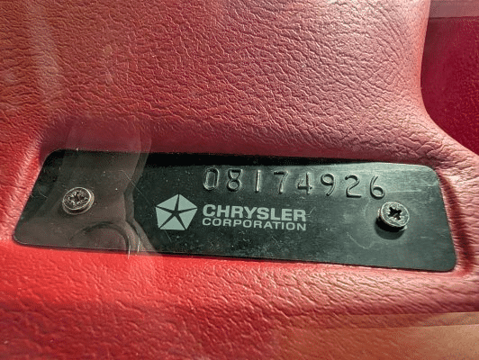

What does the dash vin tag say compared to the plate?
Same as plate 8 in place of B

It has a H so would it be a 340 car? If so why BH not BS? Were the VIN tags screwed into the dash pad when new or was the dash pad replaced at some point?

Are there no records of any broadcast sheet or any buildsheet being supplied with these 08 exports?
Assuming because they were built from ordered parts that the importing country purchased and installed themselves. Therefore no need for a buildsheet.
