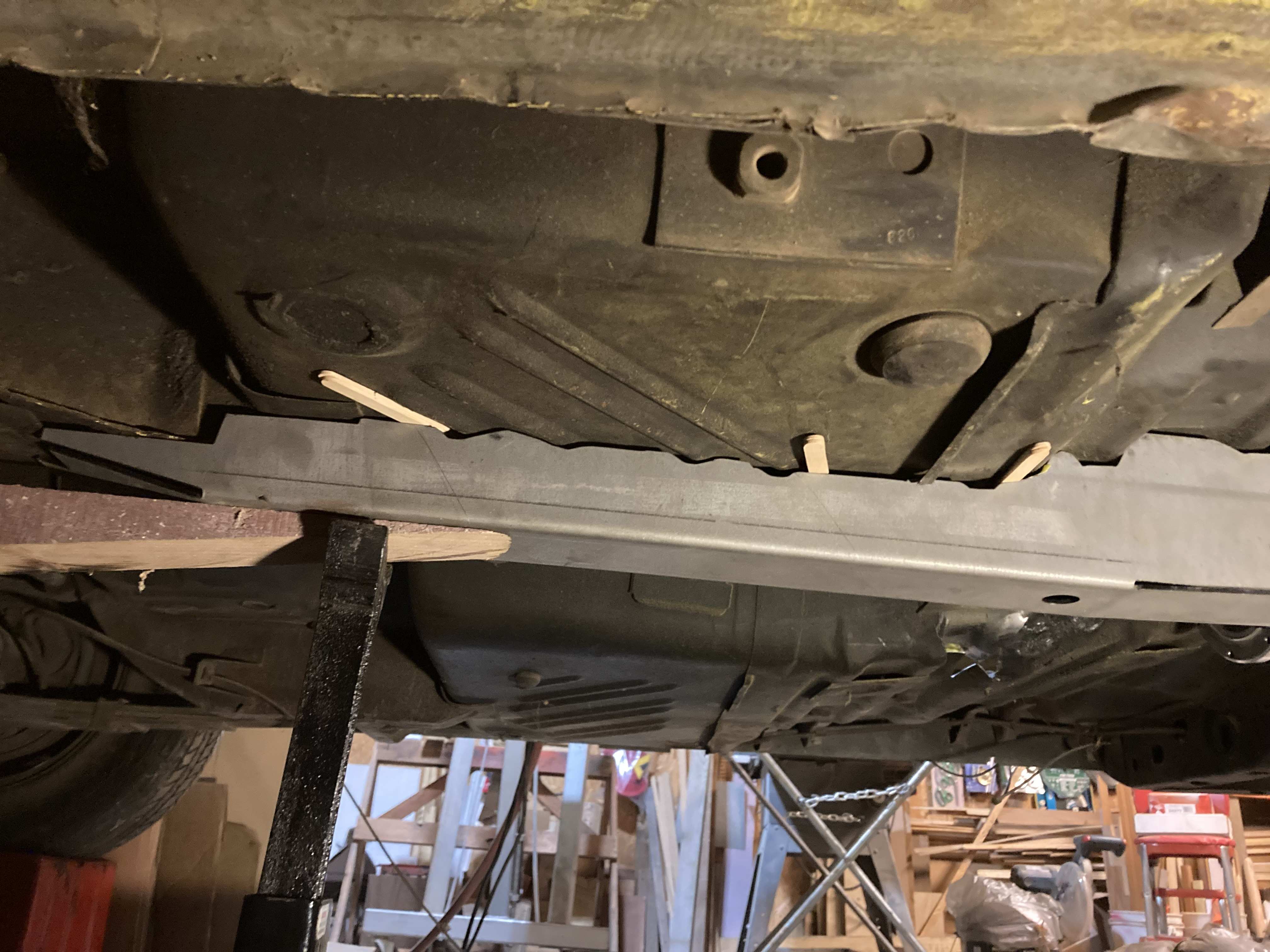

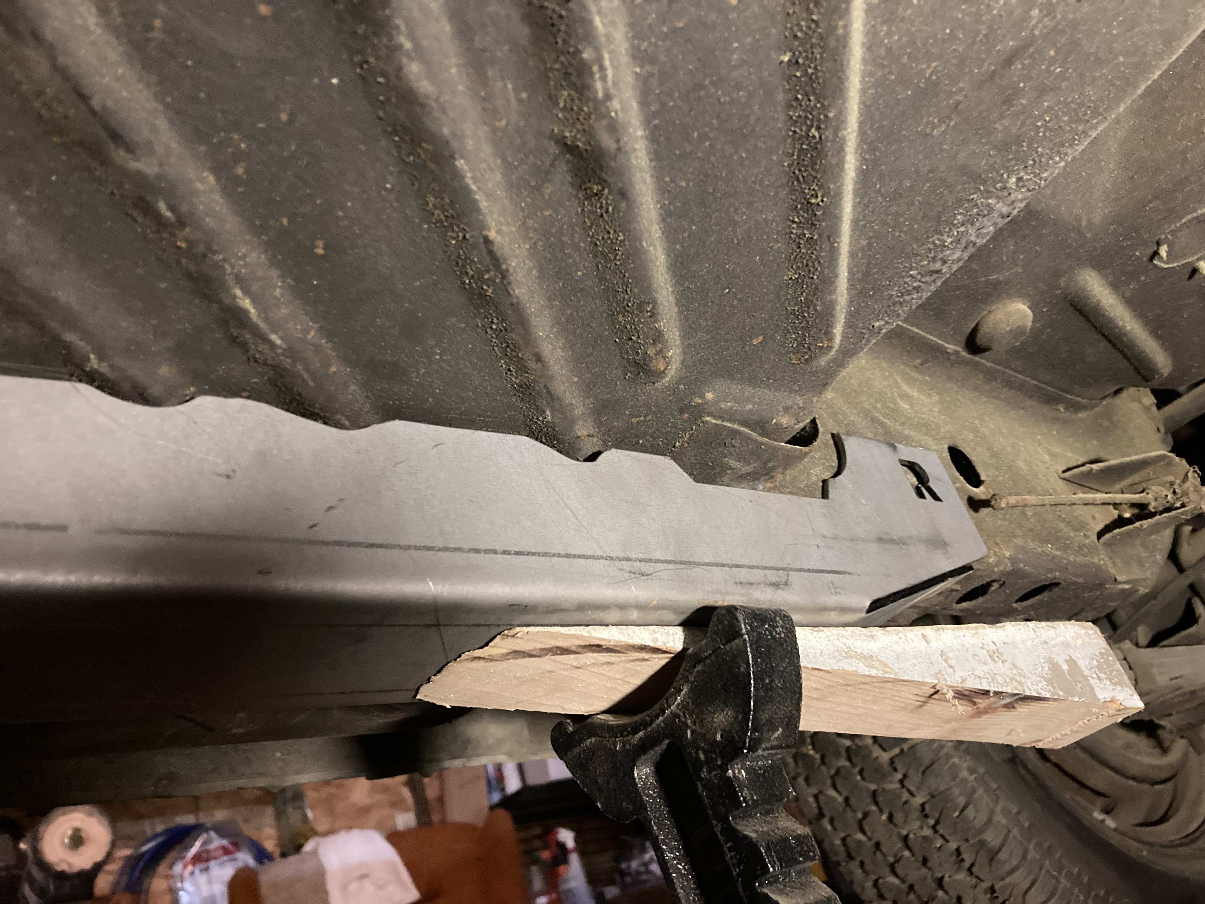

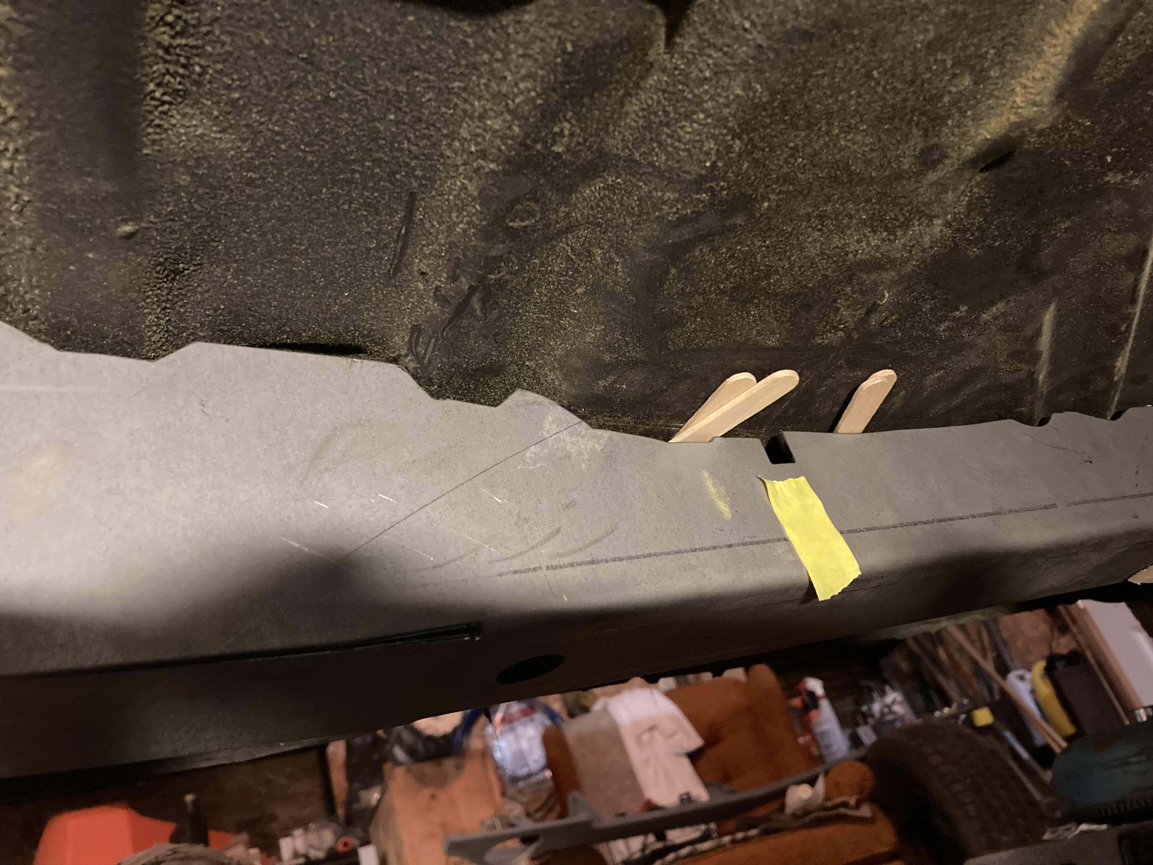

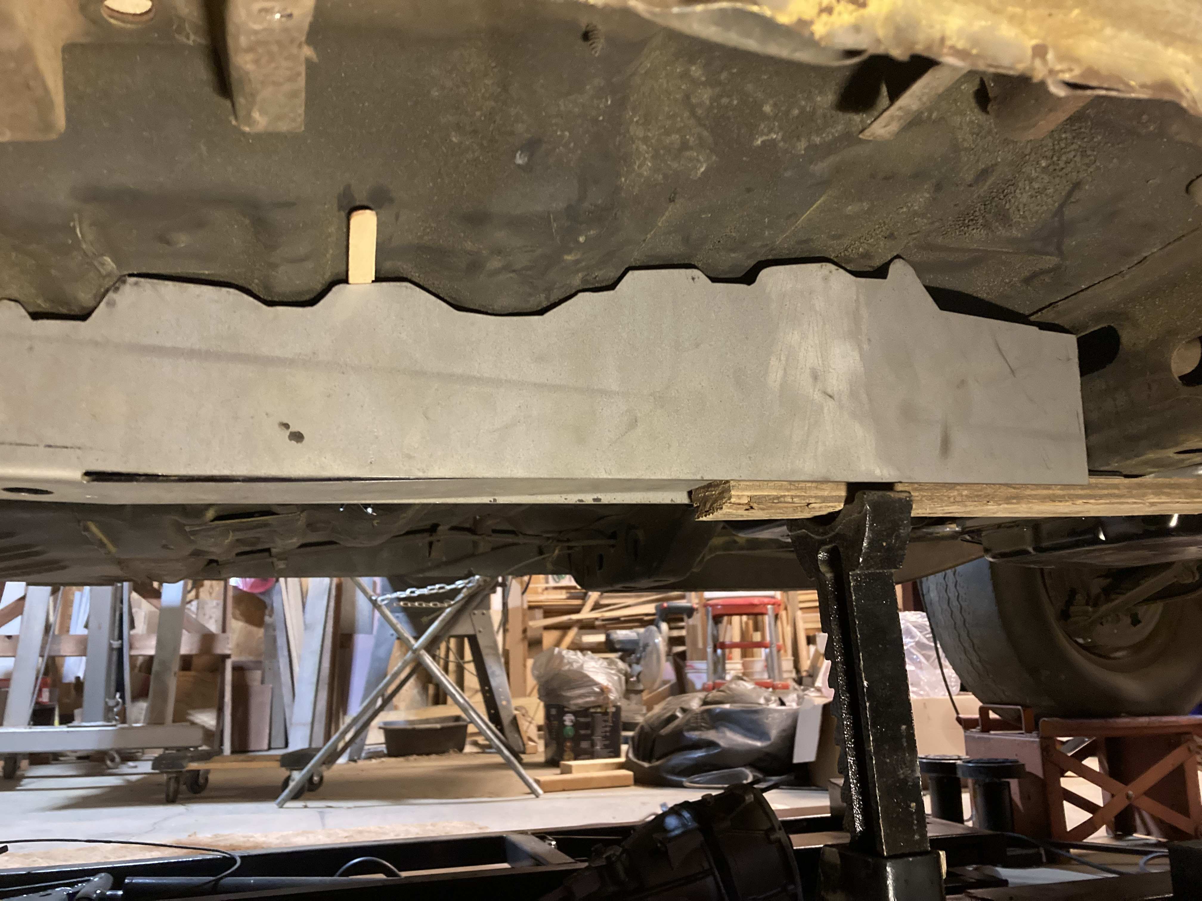

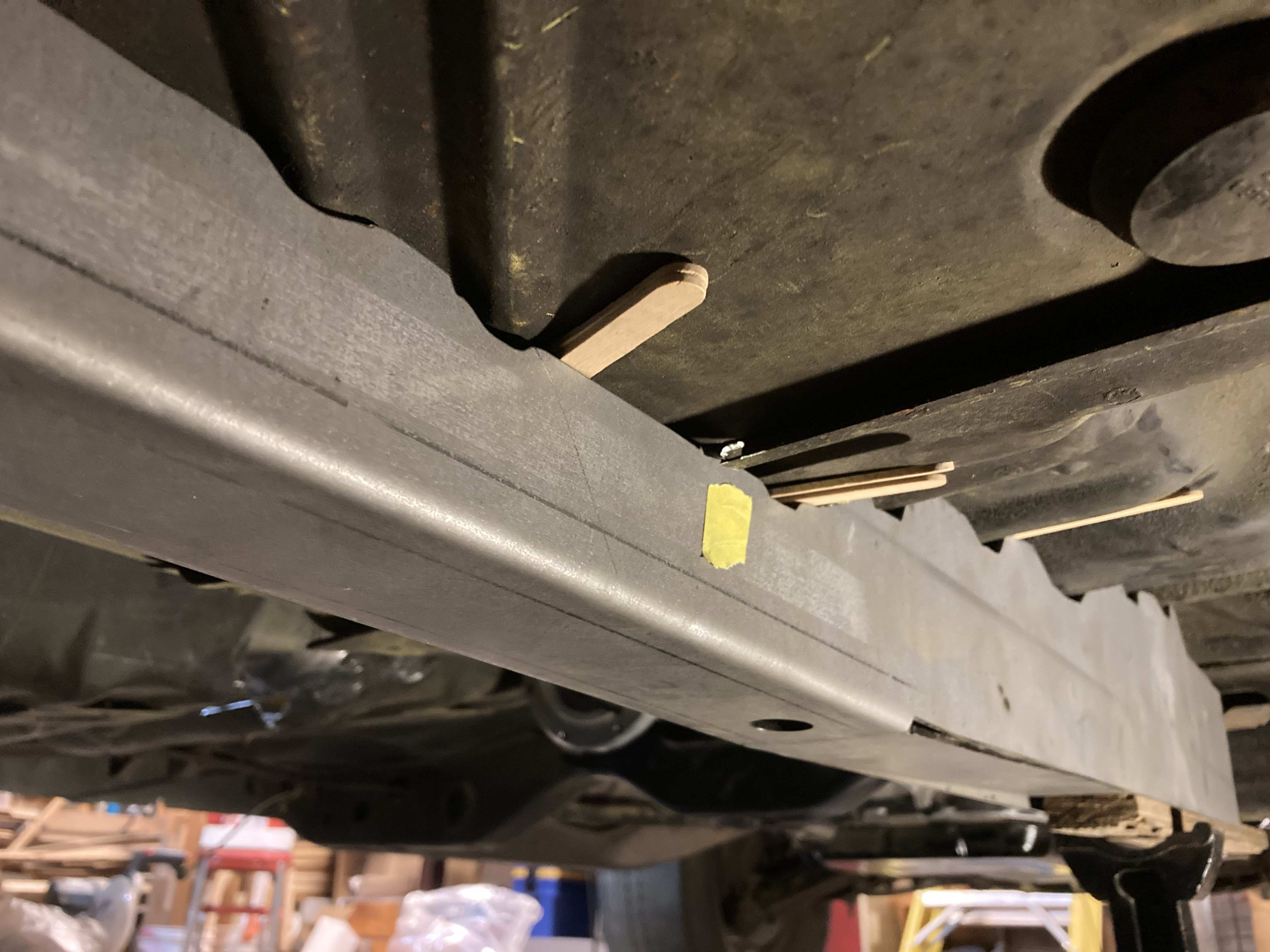

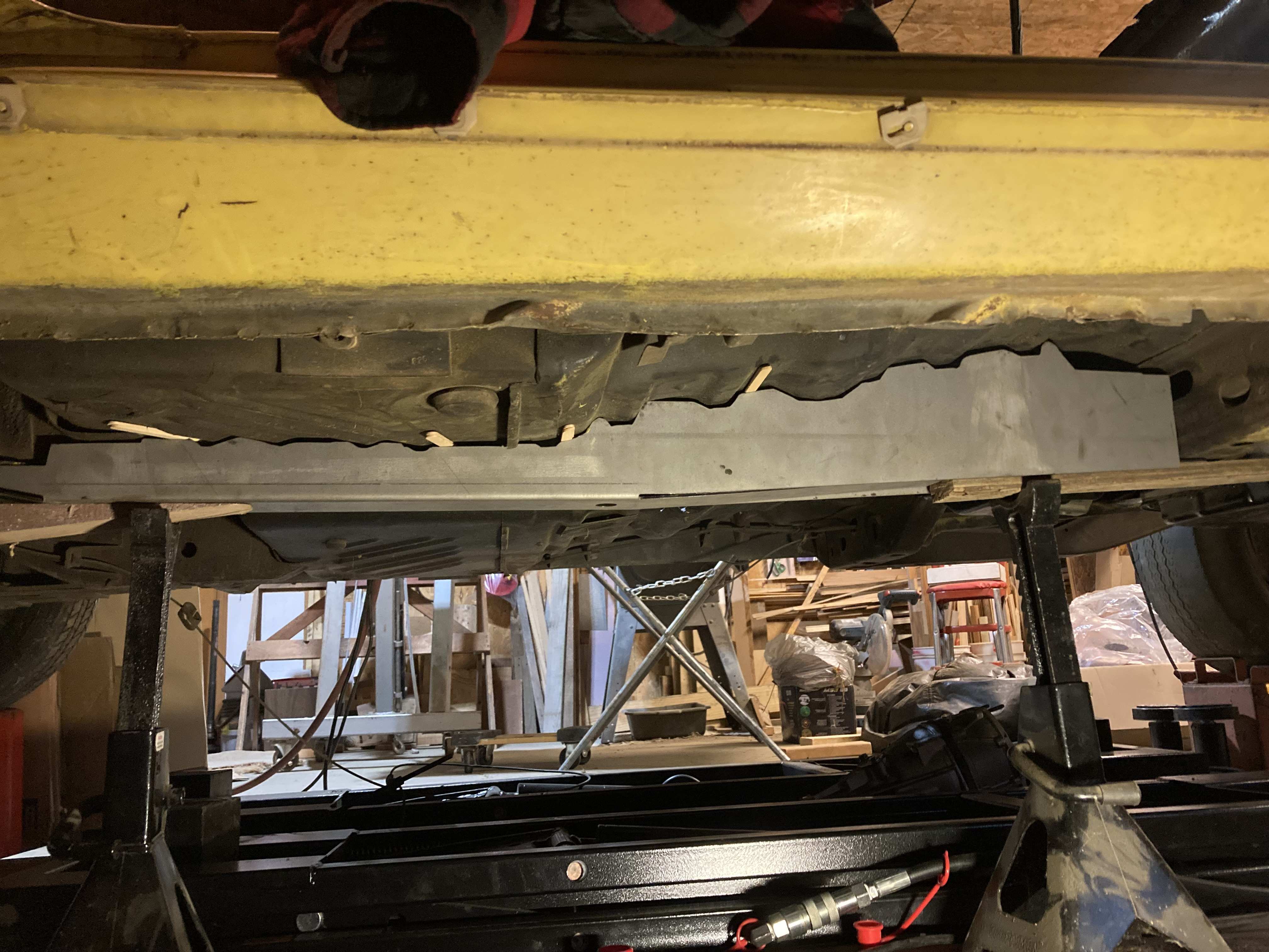

I put these connectors in place, as tight as I could get them. Here are some pictures. Where I have the popsicle sticks there is a 0.180" gap, those are some of the worst areas. The front end is horrible .75" along the area near the torsion bar. The rear inside has a nice radius that supposed to fit the rear sub-frame. The raduis matches, it's only off by an inch, haha. I notched the floor pan where the front pan meets the back pan, where I put yellow tape on the outside. That was the first major interference. The tape on the inside is where they have a nice notch that would fit right around the area I notched, were it on the correct side of the connector.
So Xcudame was right, extensive grinding would be required on these connectors to make them fit so you could weld the 10ga connector to the 20 ga floor pan.
gzig5 carve out some extra time, I'm sure you will see the same thing.

That's not what I would expect! I would scribe where they go. Make up a floor templet and start grinding to fit. Then weld angle tabs inside of the scribed area to weld to. Just my thoughts.

Yeah, it's not what I expected at all. At this point I have decided to return them and make my own. If I have to re-engineer and fabricate, I might as well do the whole thing myself. I know materials will cost me less than $300.
Anyone made their own? Pictures?

I considered doing my own from scratch. It's not rocket science. Mark the placement path on the floorpan. Establish a start and stop point for each side so the two profiled panels stay in sync to each other. Then use a couple of plastic profile gauges off amazon to map the floor onto a template. Cut the plates out with a plasma and weld them together. Worth buying a cheap plasma for the project if you don't already have. I think I would make each one out of two parts and have the one bent to make an L for the C-channel. Then you only have to weld the other side on and it should be more accurate than trying to cut both profiles into one piece and then bend the c-channel. Otherwise, three pieces welded together on each one to make the C. Hope that makes as much sense in writing as it did in my head.
