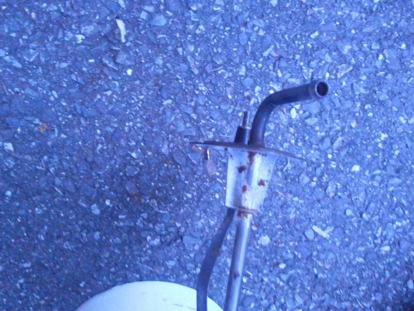

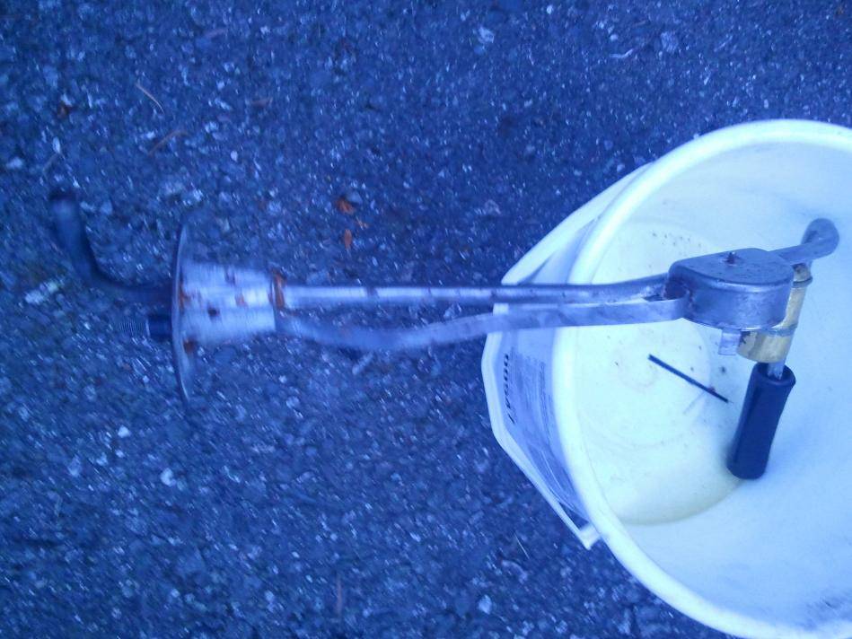

I pulled this out of the gas tank and need a new fuel tank sending unit for my 1970 challenger. This car was a small block car and now has a 383. Previous owner put in a new tank but used the old sending unit.
Pics
Here are the pictures

My fuel guage needle moves a little when i plug this in and dosent show proper readings. Do you know how to fix it?
The most important reading is Empty. I would go ahead and power up the sending unit and adjust the float to give a correct empty reading. Make sure that the float does not leak first. All the sender is, is a variable rheostat. The unit must be grounded properly to get a correct reading.
The sending unit is a mess not worth fixing up I want to order a new one what size should I get?

Floats got a hole and the wire broke off because its rusted. Also the cover for where the fuel goes through was brittle and really dirty.

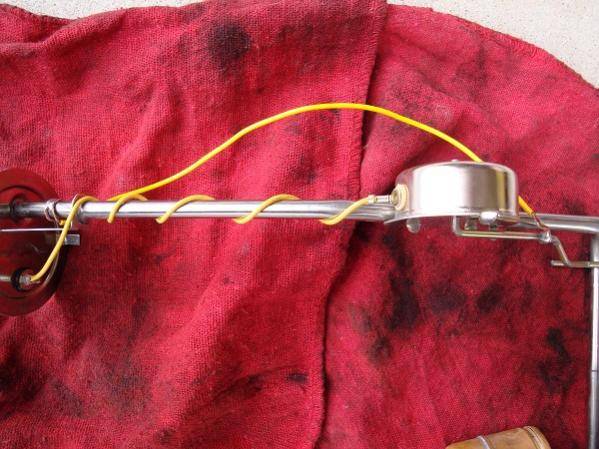

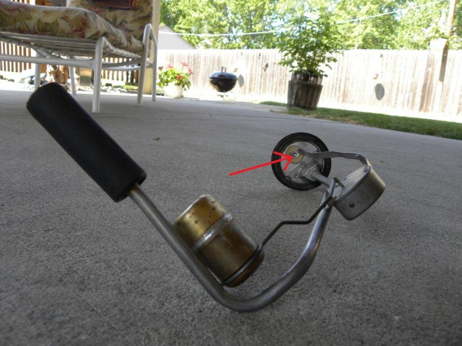

I sanded off the rust/crud on mine at red arrow in pic (btw not my sending unit just a pic I found) and re-soldered this improved continuity down to the part of unit that houses swing arm. If you can`t save that strip of metal the pic of the sending unit with the yellow wires will do the same as that strip of metal. The wire from the swing arm to the body of sending unit keeps continuity better than at the swing arm pivot point.

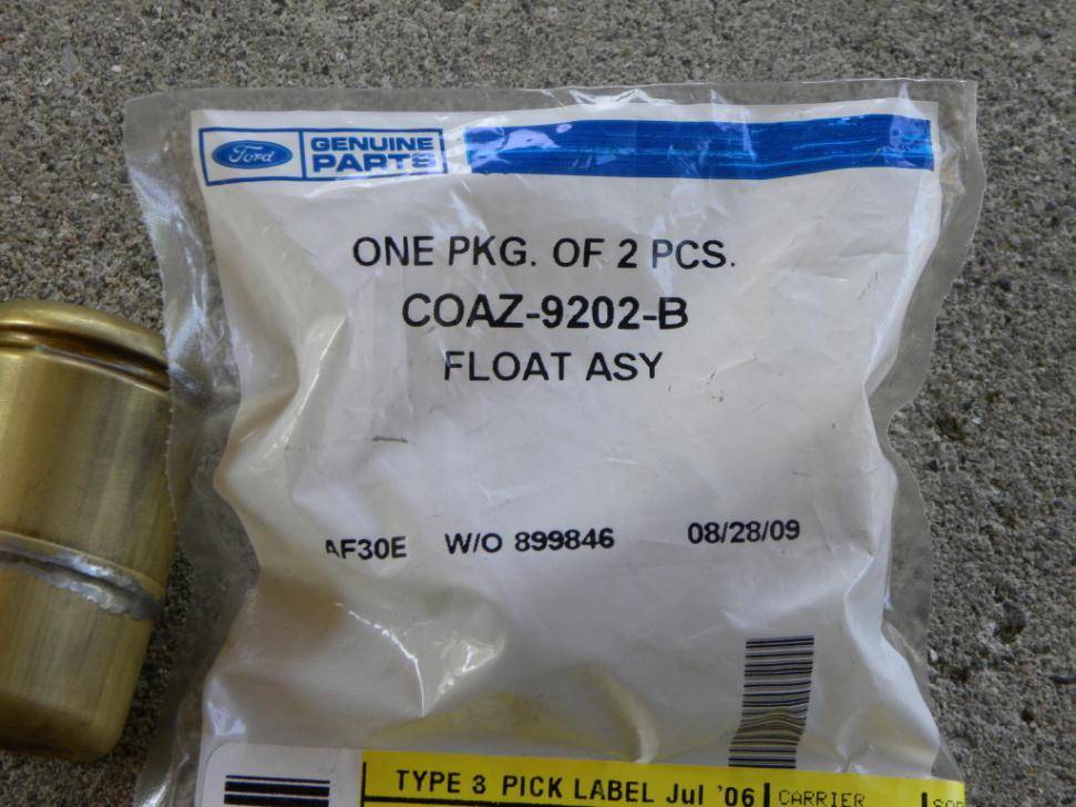

Ford sells an exact replacement float ball too! Around $10-$15 bucks I think.

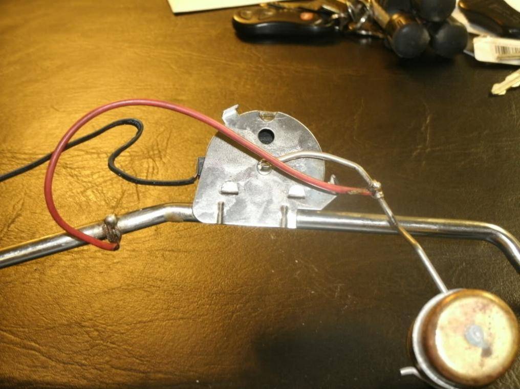

Another pic of the wire to the swing arm. Just use a thin wire and make sure it doesn`t interfere with the travel of swing arm. It`s really an easy fix!

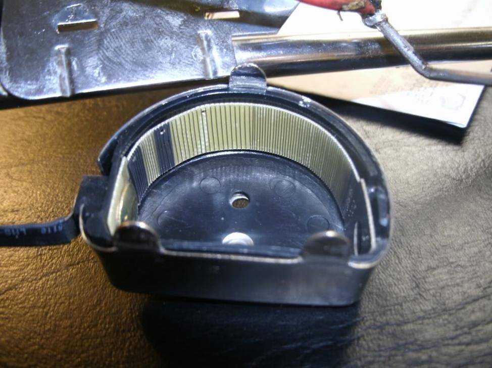

Good posts Dan! What isn't shown in pics and wouldn't be easy to see anyway is the minute wire that makes up the windings for the reostat, at the beginning is attached to the ribbon wire through the housing. Be very careful to make sure it stays in tact.
