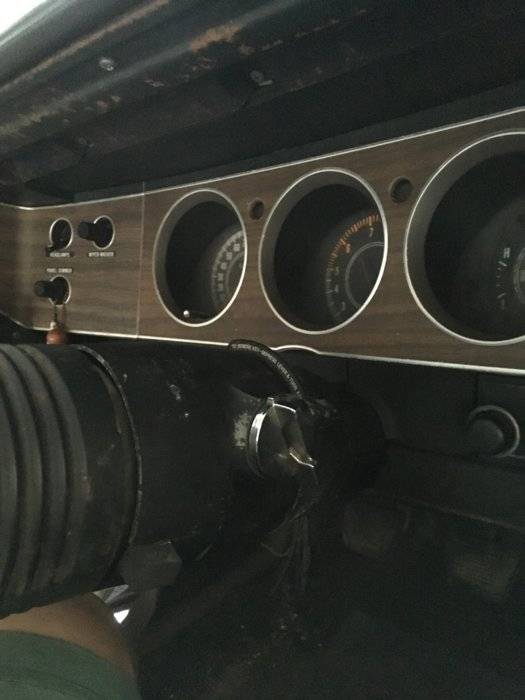

Well, I went and lost my keys. I believe they were stolen, but thats not the issue right now. I need to get a new key made for the ignition ASAP. How do I go about taking the ignition out? I gave it a quick look over this morning and have no idea where to begin! Thanks everyone!

The steering wheel and "crush" can need to be pulled off. Then the ignition cylinder can be pulled out, and taken to a lock smith to get a key cut or replace the whole cylinder and keys with a new one.
Any chance you have a service manual?
Search this site for Cody's video of rebuilding a steering column, it's excellent!
Or call a lock smith who can possibly make a key on site.
