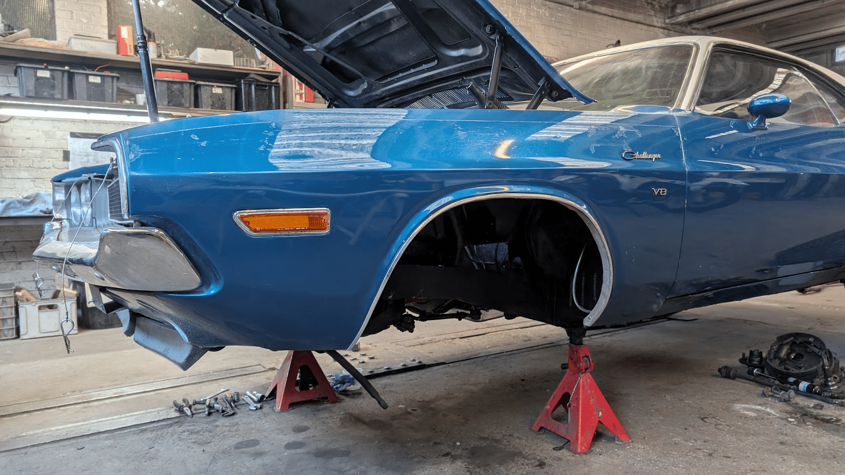

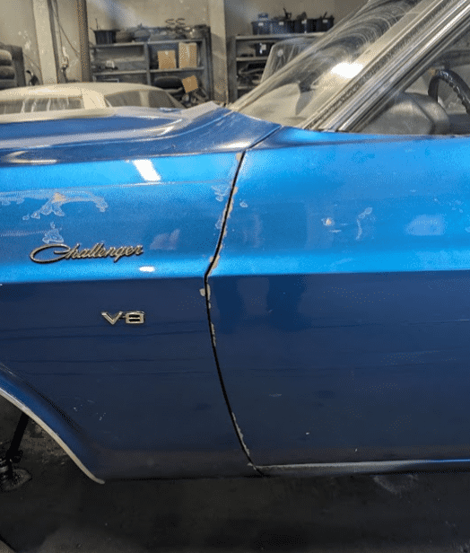

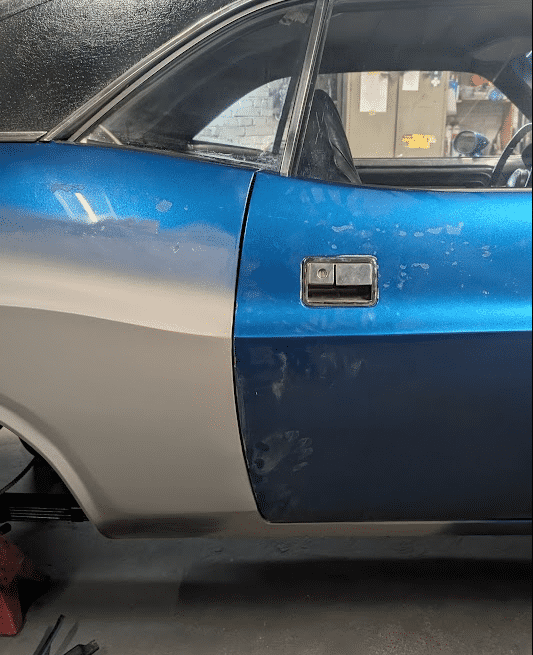

Before painting the rear of the car, decied to re adjust the doors, the front fenders and the hood.
Paint cracked everywhere, but .... Yeah I'm sure you'll know what I'll say now : "I don't care. I'll touch these up and see what happens after a few winters."
The thing is just to not let things go too far corrosion wise. I keep my eyes open.
I just love good looking gaps and doors that close easily and silently.
I also "massaged" the tail light pannel so the lights fit better. It was terrible before.

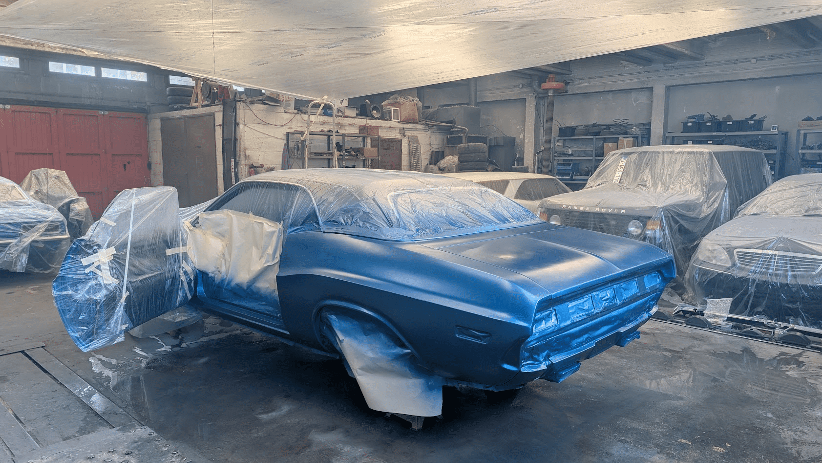

And then paint :
Color coat (solvant version - dries better than water based one in a dusty shed!)
And clear :
Put back together :

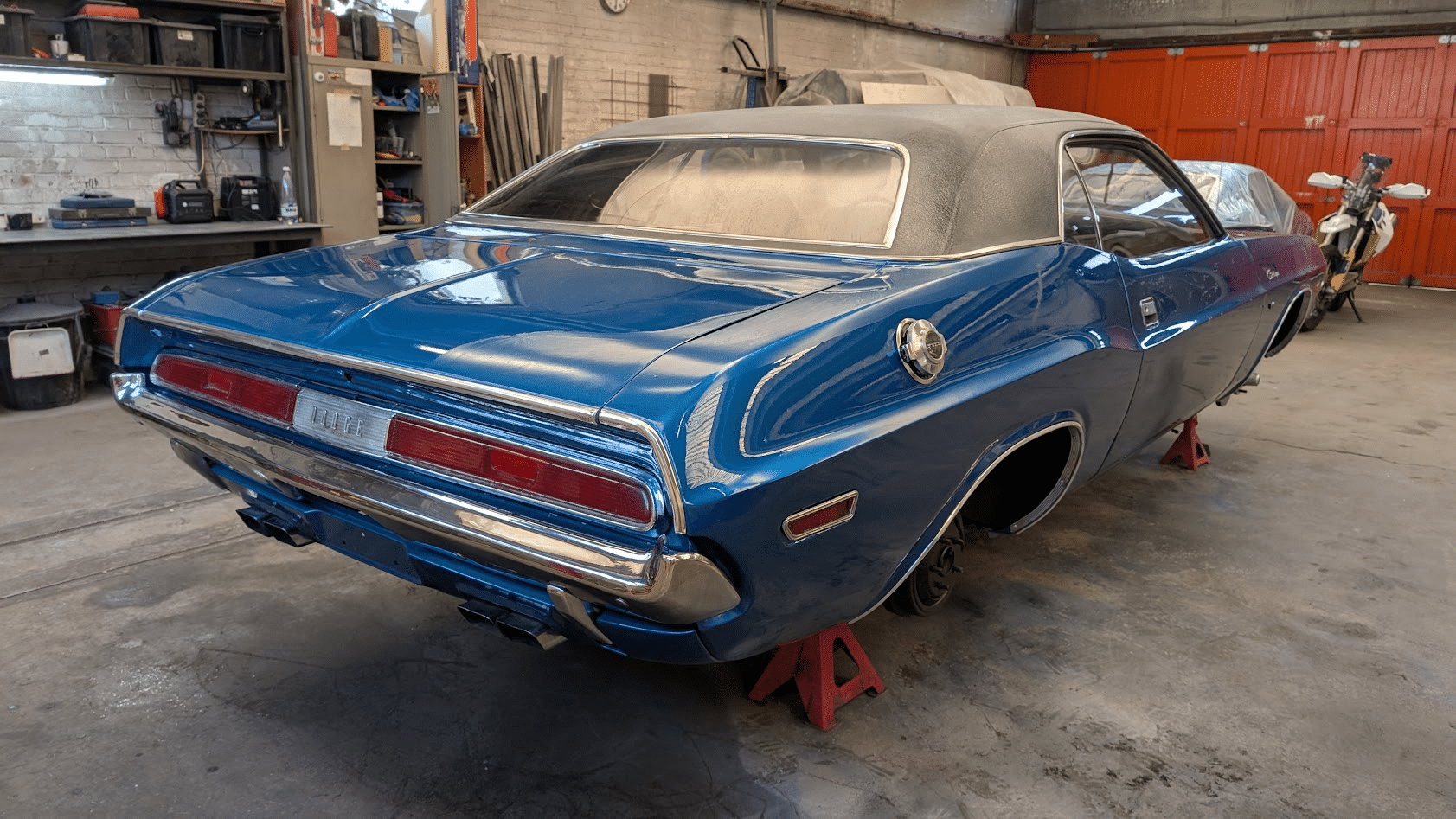

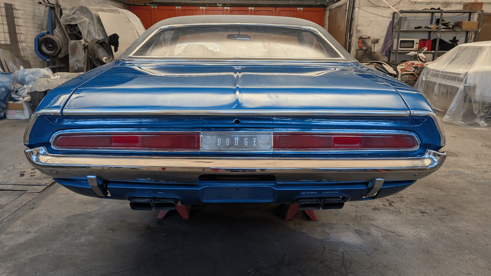

Fortunalty the guys that scanned my deck lid did a great work with the color shade. It matches very well.
That pretty much it for the visual side of the car so far.
I'm now waiting on my steel wheels that are currently beeing widenned (had those late 70's 15X5.5 - Front will be widened 1 inch to make it 6.5 and rear 2.5 to make it 8 inch wide)
Then I'll paint them same color as the car.
Did I do a perfect job for the paint of the car ? nope. A good job ? Nope. It's an OK job. The idea was to repaint the rear so it matches the front. And to that extent, I may have made a too good of job haha. I wanted it all the same color. It's now done.

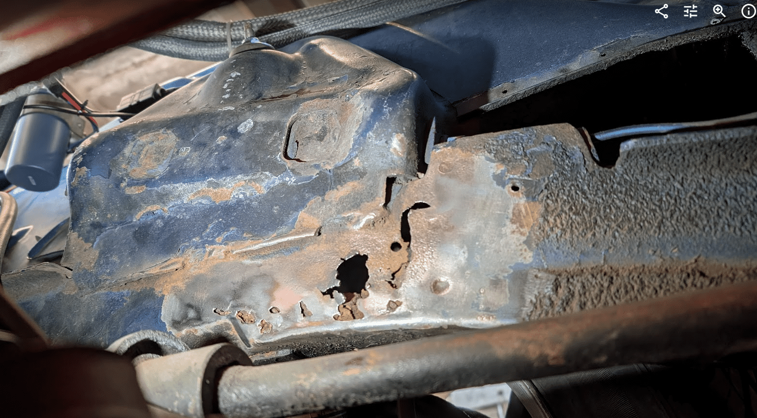

Discovered this and fixed it :
Not a fun job for a guy with no lift. It's not an insible job, but the frame is now safe.
A bit of rust primer, and rubber over it. Good for another 20 years !

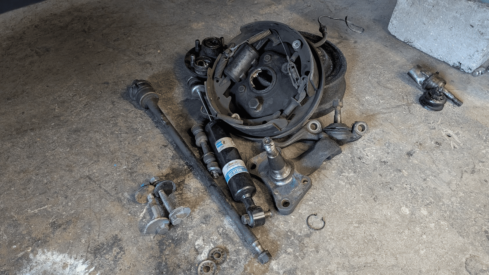

As I had put the steering box back on the car (and took the opportunity to swap the exhaust gaskets) I decided, since I had all the parts with the car, to change all the ball bearings and buschings on the front end.
I don't have the proper socket for the upper's. So a guy did what he had to do...
That pivot bushing on the lower control arm needed a little "detour" to a friend's house with a good press. But with that, it was done in a breeze.
Decided to put it back together with red loctite on the thread of the shaft, and with the bolt in contact plus 1/4 turn. Stacked as much grease as I could there... And I can now see that the whole shaft is rotating in the K member. It's not the bushing itself that swivels like crazy and self destruct in 12 minutes. Mopar did NOT do a great job with that pivot arm thing. Will see if my technique destructs the K member but I really beleie I'm ok.

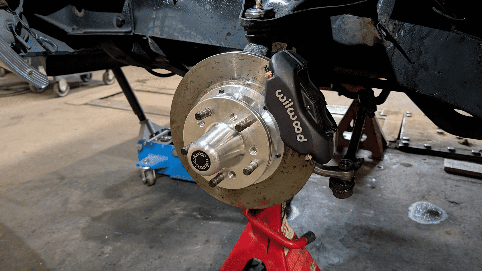

Out with the old (that is just one side):
In with the new. Well, 2009-never-mounted-on-a-car new. This exact model isn't even available from wilwood anymore haha

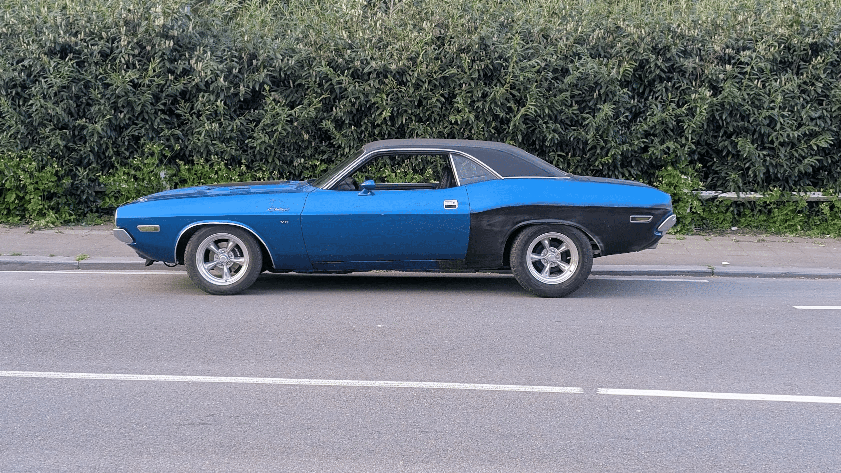

Now she's really how I like it.
Was about to order dog dishes, but I don't know. I think I like it like that, just simple. Has a bit of race car feeling to it.
