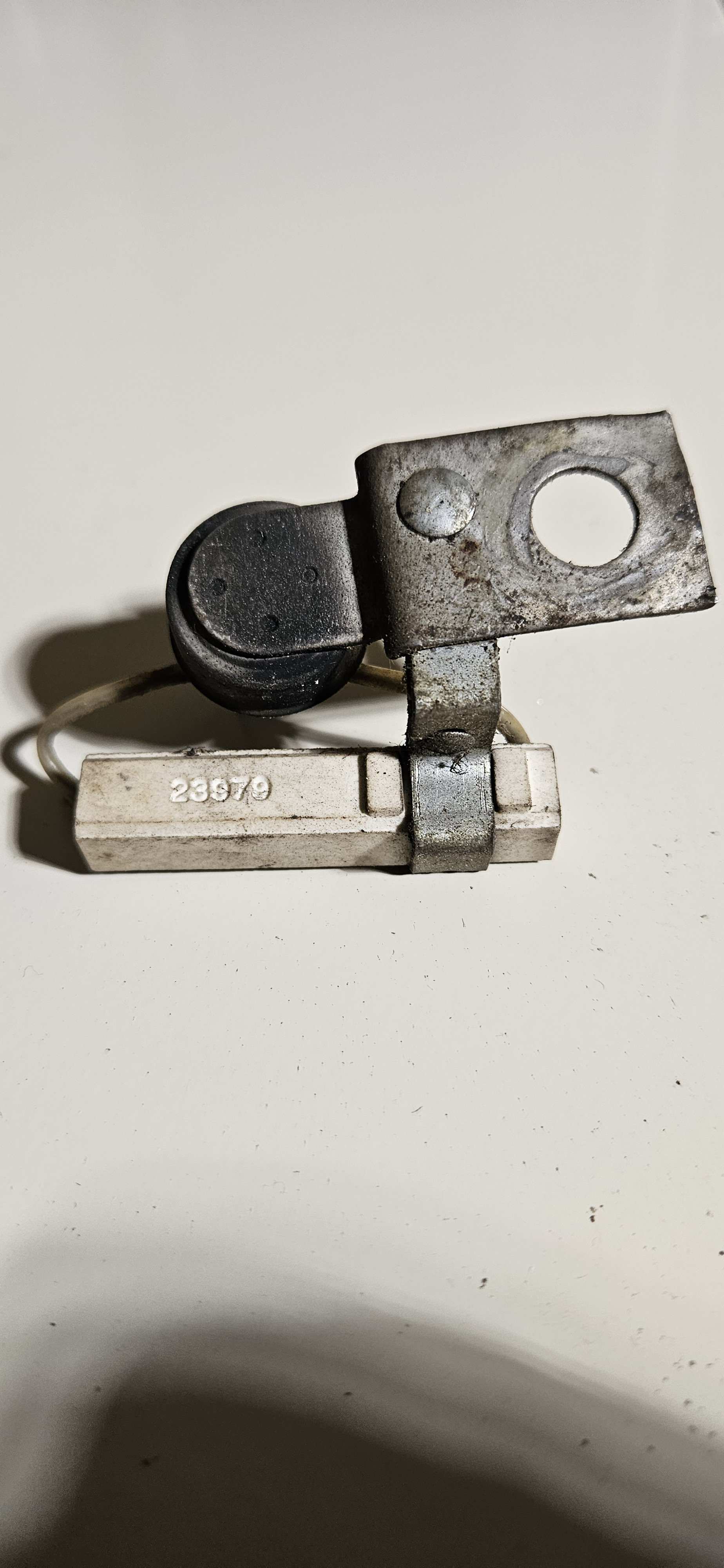

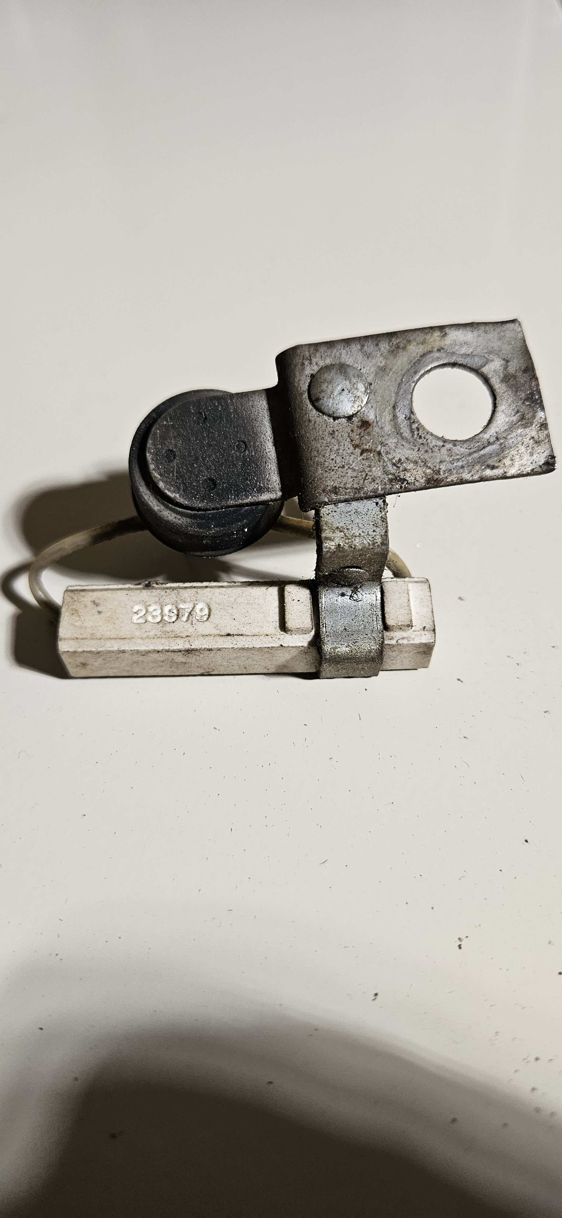

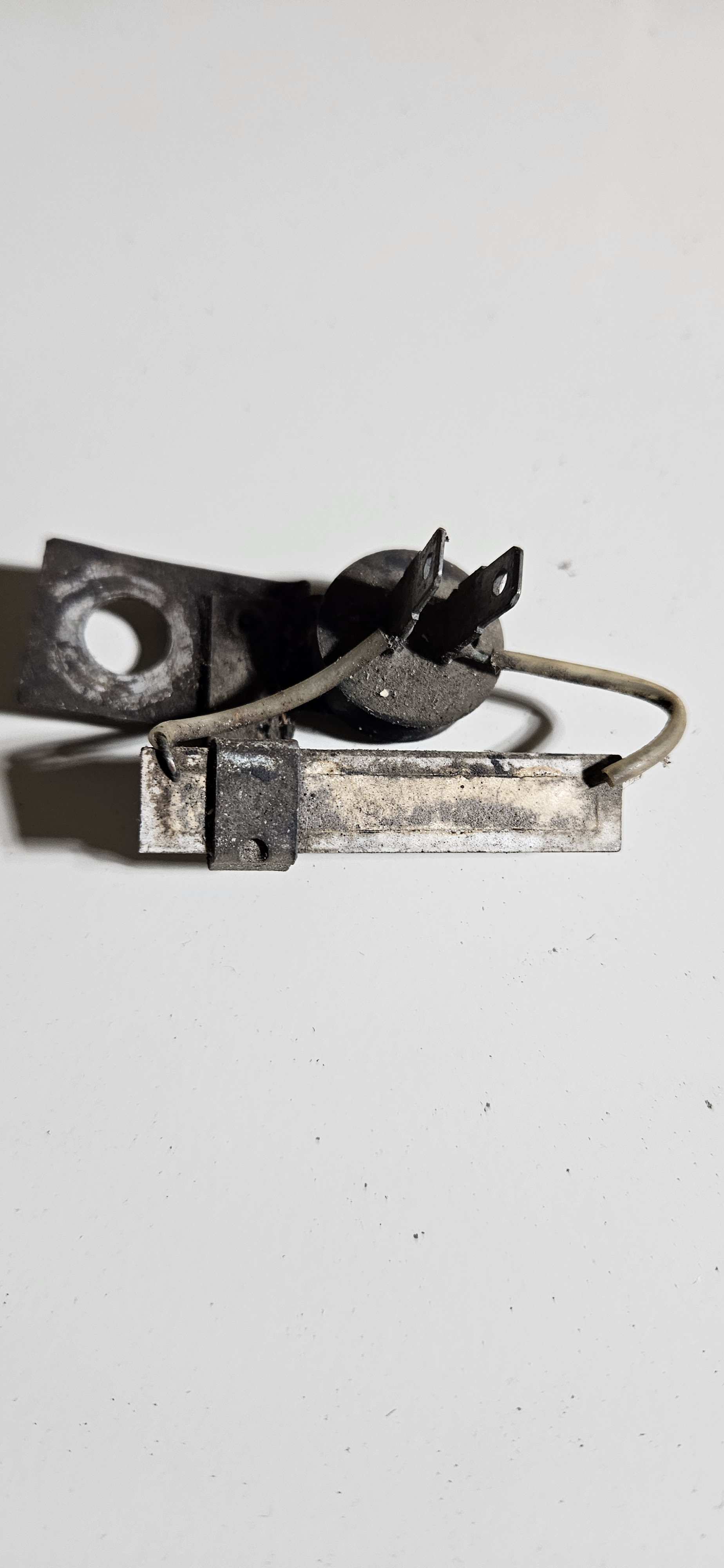

Today at 7:39 PM #1 P Plumcrazy4me New Member Joined Aug 10, 2025 Messages 1 Reaction score 0 Location Ohio Need help identifying a part found while going through boxes of a long ago disassembled 70 Challenger R/T. May not even be E-body. Thanks group!
27 minutes ago #2 pschlosser Well-Known Member Joined Dec 8, 2022 Messages 1,069 Reaction score 512 Location Santa Rosa, California That looks like a ballast resister. Maybe for a slant-6, I have the least experience with those.
21 minutes ago #3 72RoadRunnerGTX Well-Known Member Joined Jan 8, 2013 Messages 252 Reaction score 183 Location Shoreline. Washington Later seventies solid state electrically assisted choke control. Didn't see them until about '76 and later. Would not belong to a '70. Replaced the earlier electro mechanical bi-metal choke control that started around ’73. Described a bit here; Last edited: 15 minutes ago
