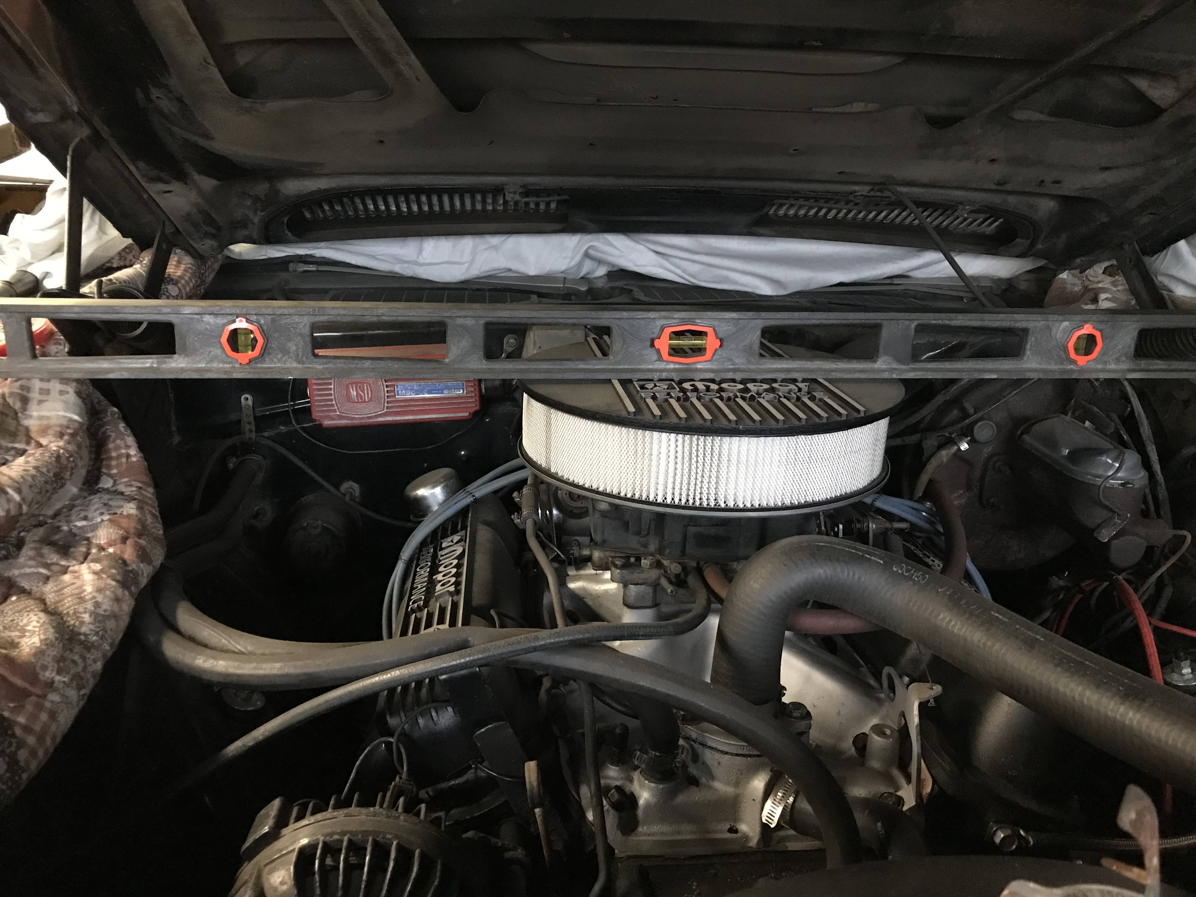

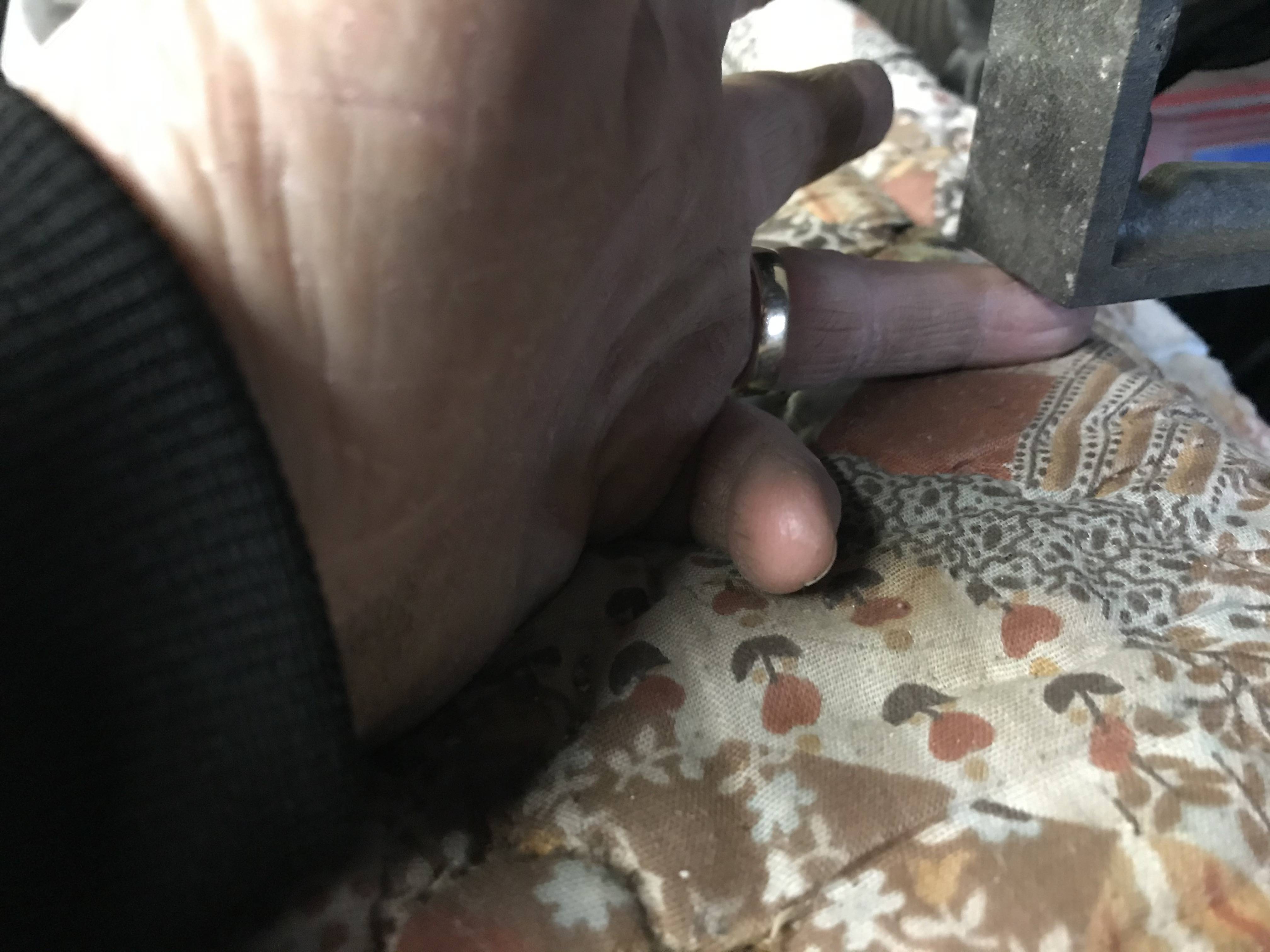

So... I laid a four foot level on the air cleaner.
I have just enough room between the level and the fender for a finger.
I plan on getting some duct seal, which is like play doh for electrical use, and wadding up a big ball to put on the air cleaner. Then close the hood to get an exact measurement.

From the photos that you sent it looks like I should have plenty of room without the 1" spacer at least. My situation with hood clearance is very similar to yours. I have a hood insulation pad that is taking up a little space but it wouldn't be a problem to remove that.
I sure do appreciate your taking the time to to check that out for me.
