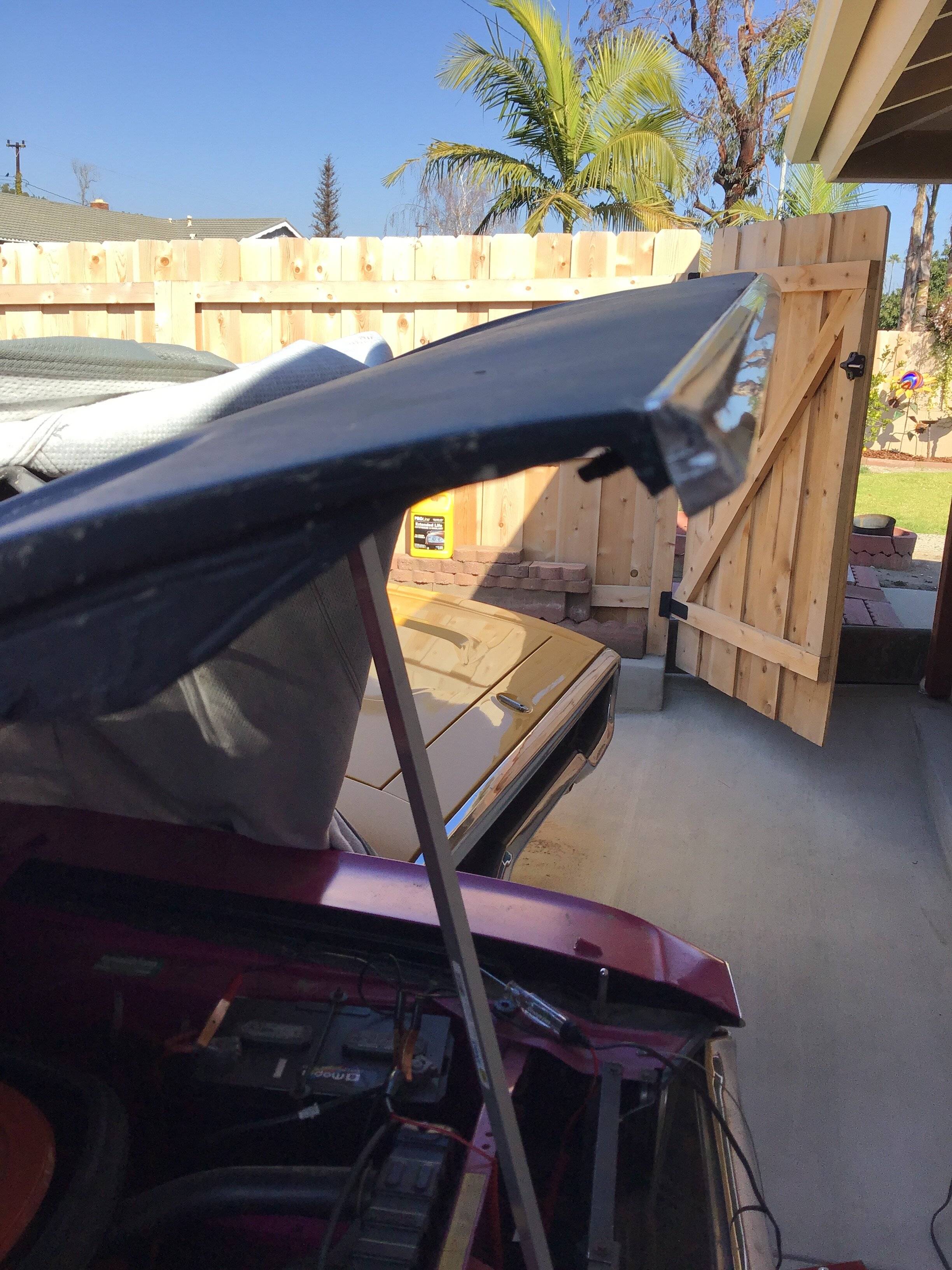

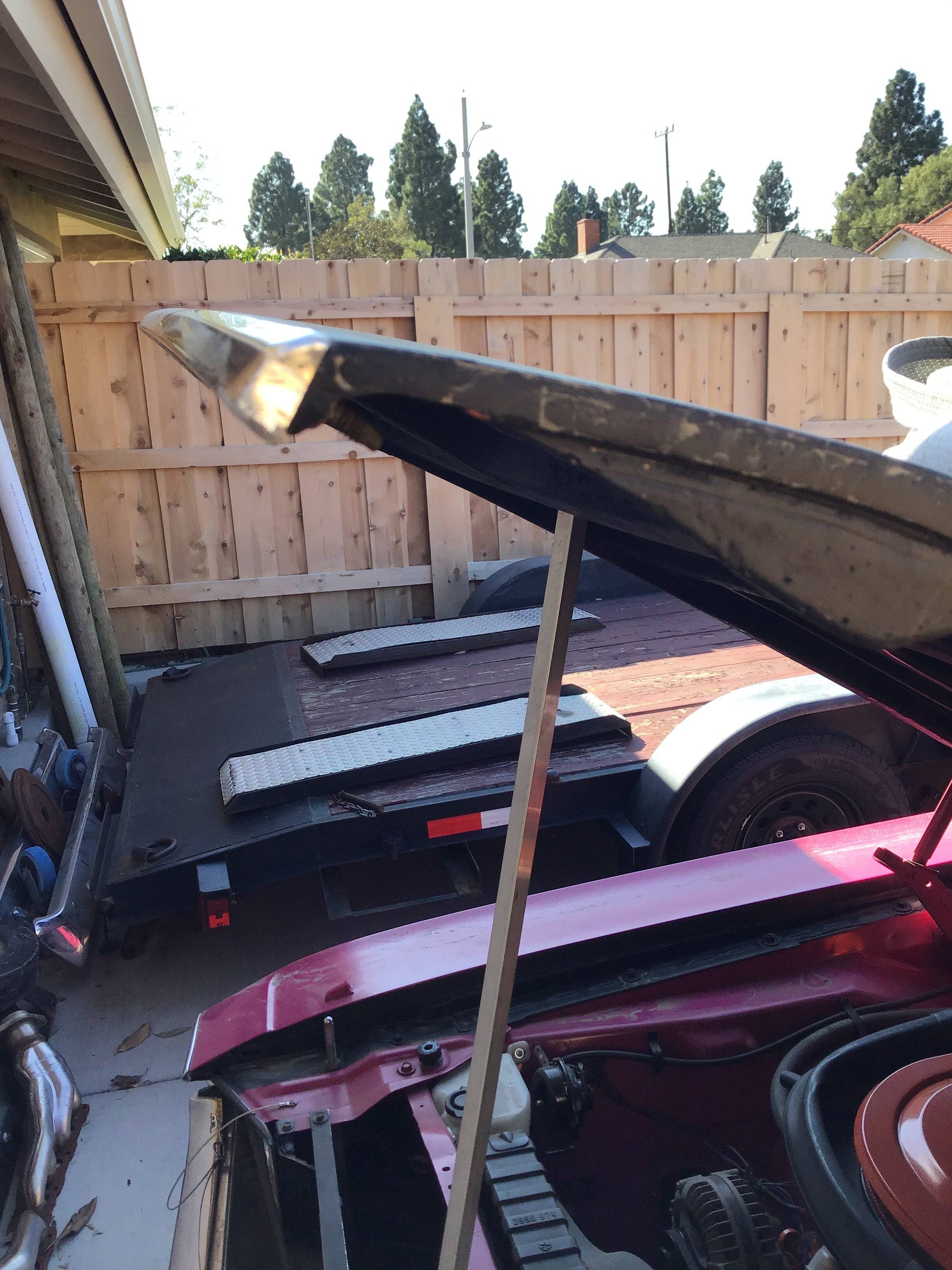

Hope this helps you

Thanks, Mark!
I don't mean to be a pain, but is there any way you could get an end shot of it, from the edge of the hood view? That would give me a good comparison to my header panel.
Thank you, Mark. That's what I need to see! Now I can go see what my header panel looks like and figure out which moulding to use.
