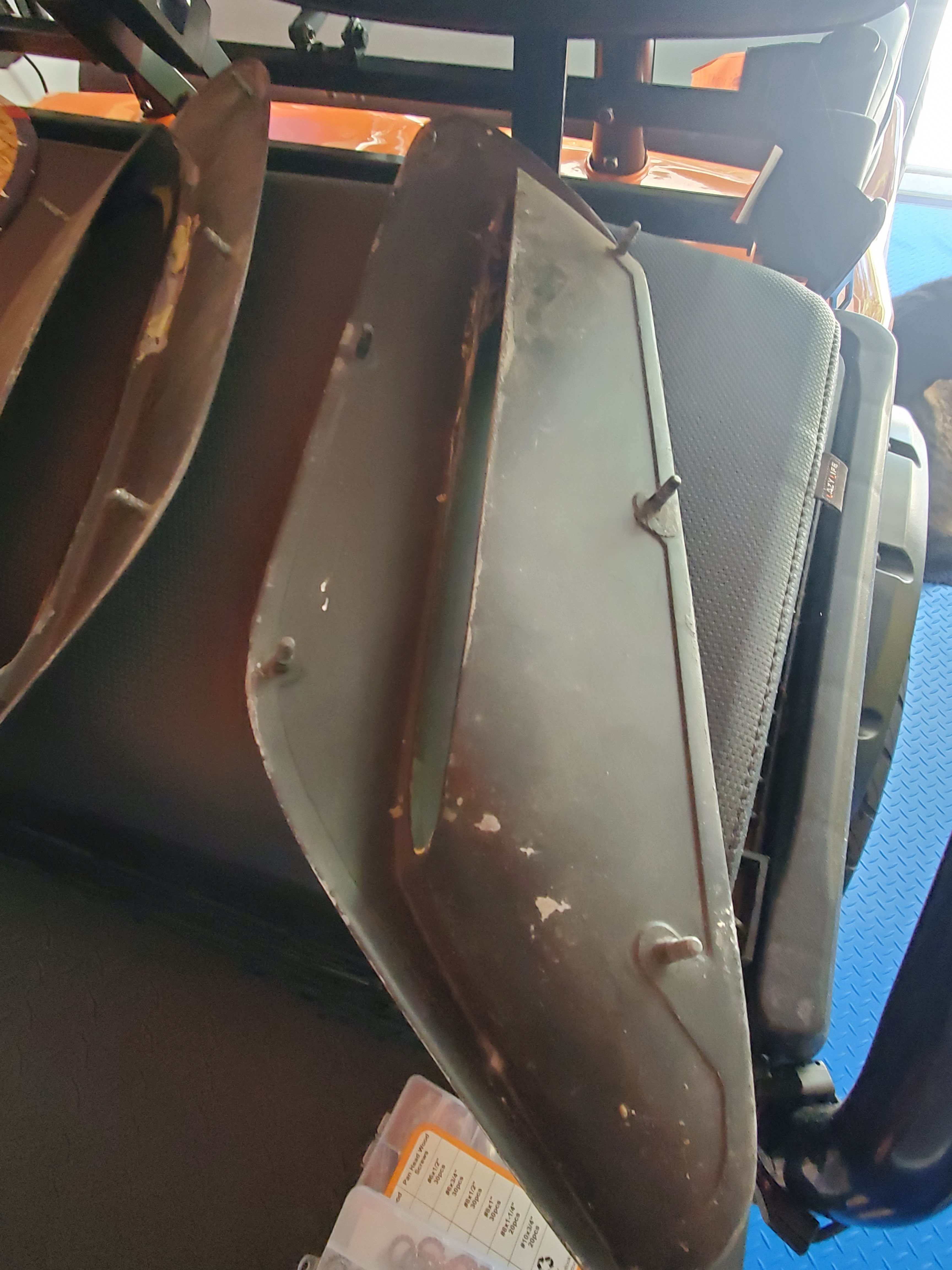

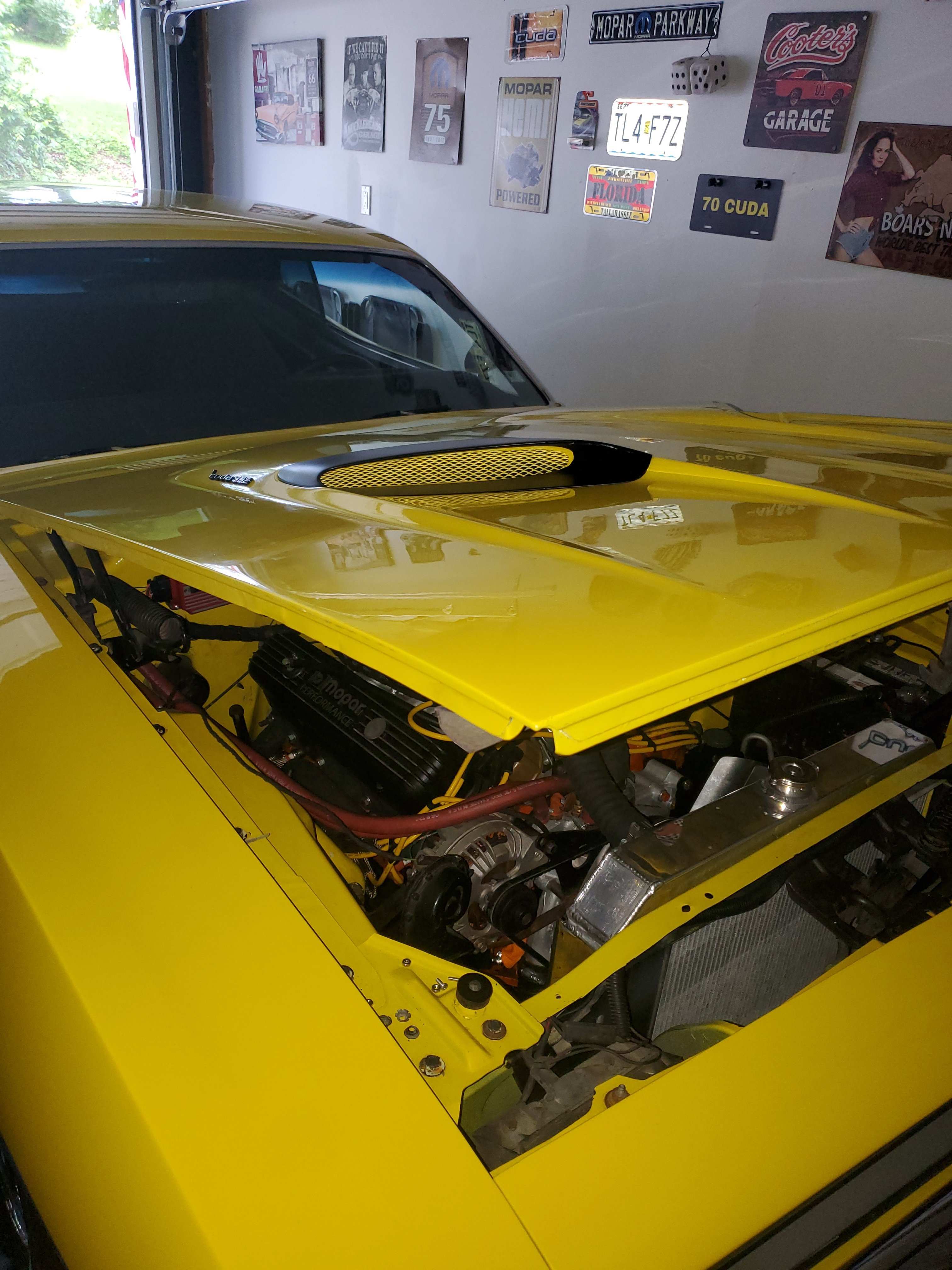

I'm putting some black wire mesh behind the scoops and was wondering do these scoops have any weather stripping or some kind of protective tape so it's not metal on metal .
Agreed.Originally, they had a sheet thickness moulded plastic cup, the size of the stepdown.
That won't work for you as your scoop and hood have been opened uo.
So anything you want to add will be fine.
Even just vinyl tape across the holes.

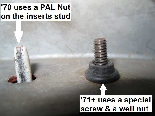

The only contact should be around the studs
These aren't vented are they .Agreed.
Hood Scoop Gasket set 70-74 Cuda Rallye | Roseville Moparts
Hood Scoop Gasket set 70-74 Cuda Rallye – These gaskets may need to be trimmed or holes adjusted to fit your scoops.www.rosevillemoparts.com
Correct.These aren't vented are they .
I'm thinking some thin weather stripping or something like that .You could use black non hardening windscreen goo around it and clean it off around the edges. Also put it anywhere you think the paint will chip when you tighten the fasteners. This will also allow you to fill up any imperfections in the external fit. Don't use silicone adhesive. You want to stop the tightening/vibrations from fretting through the paint.
Another trick I use is to use little plastic washers on the studs to give the component a little "stand off" to stop it tearing in to the paint.

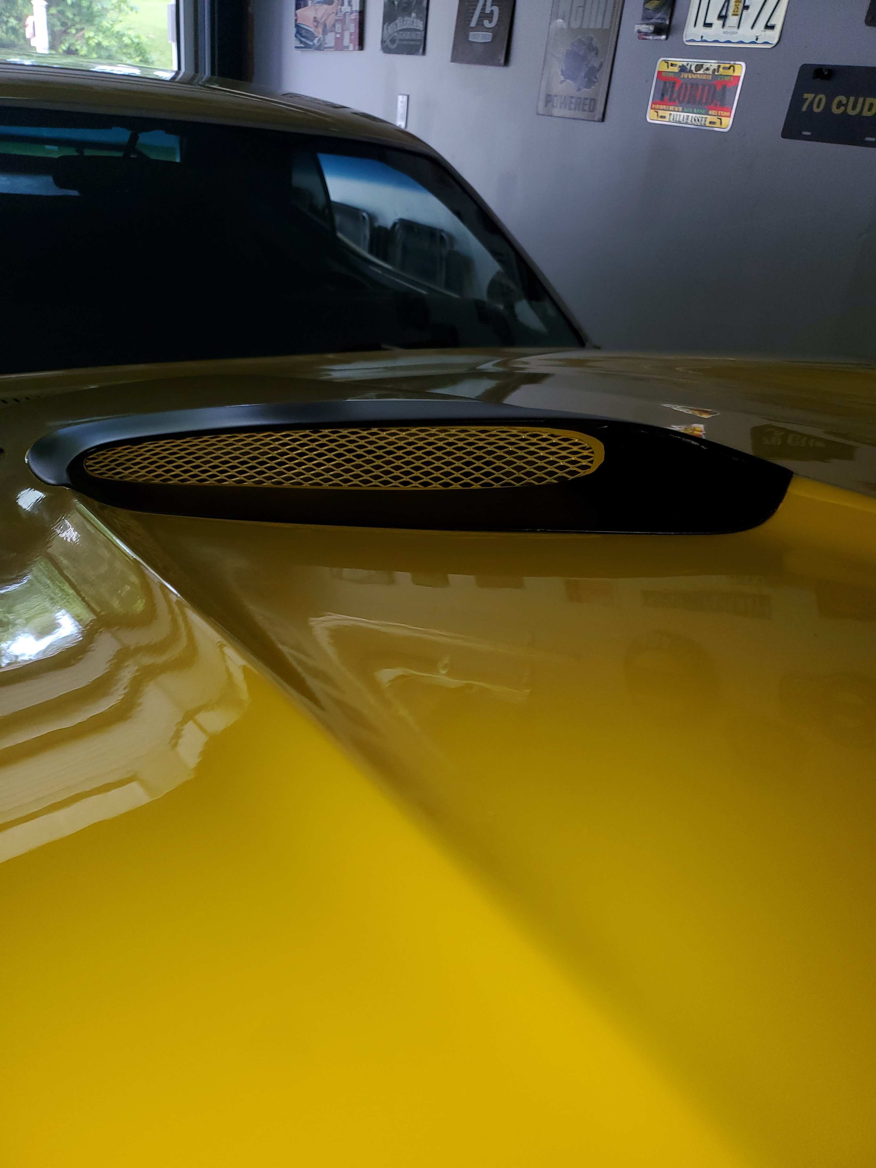

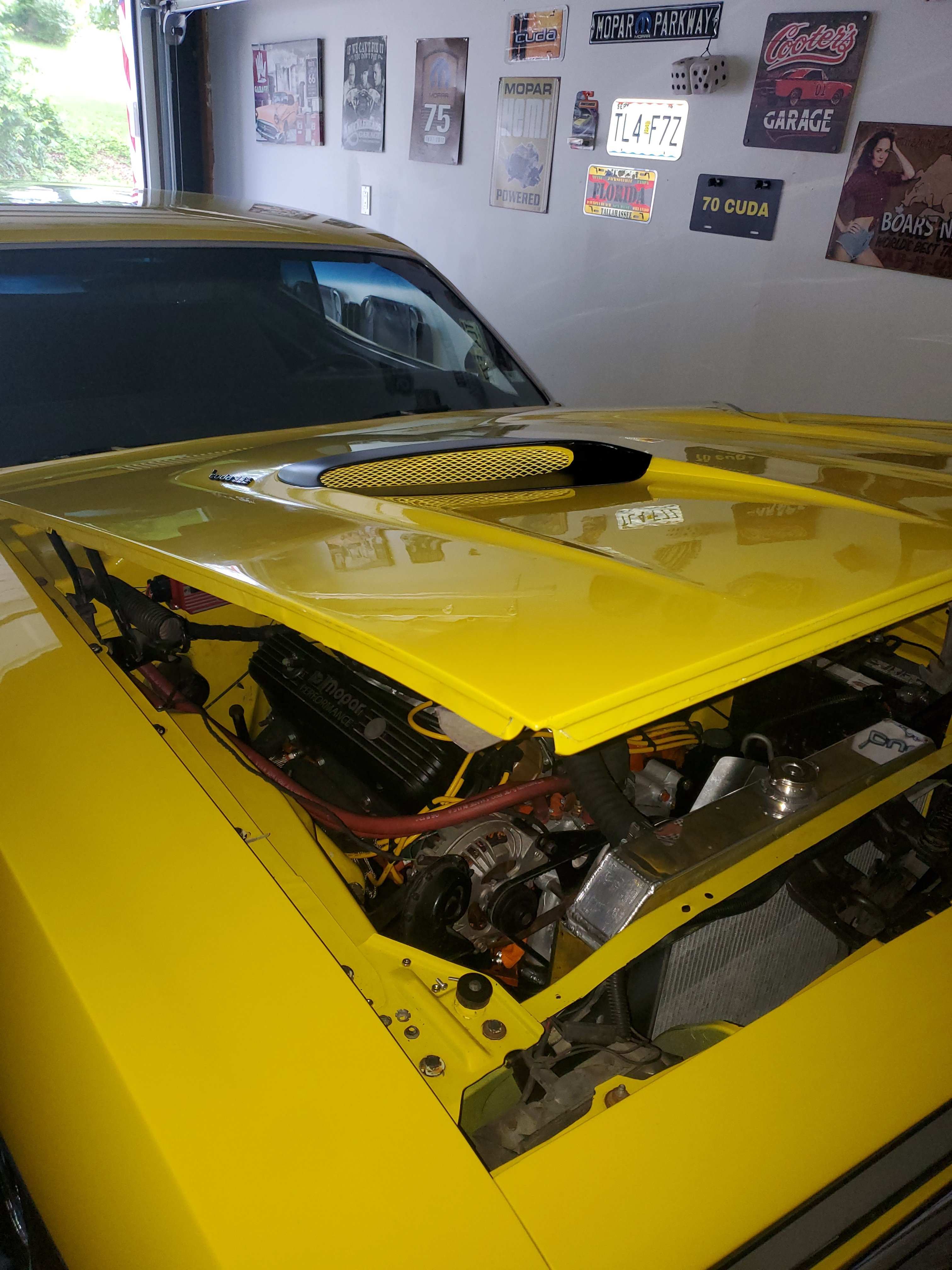

Yes, flat black is a better option IMO.This is what I might be doing , painted some black mesh yellow but it might be to cheesy , flat black is probably better.View attachment 139864View attachment 139863

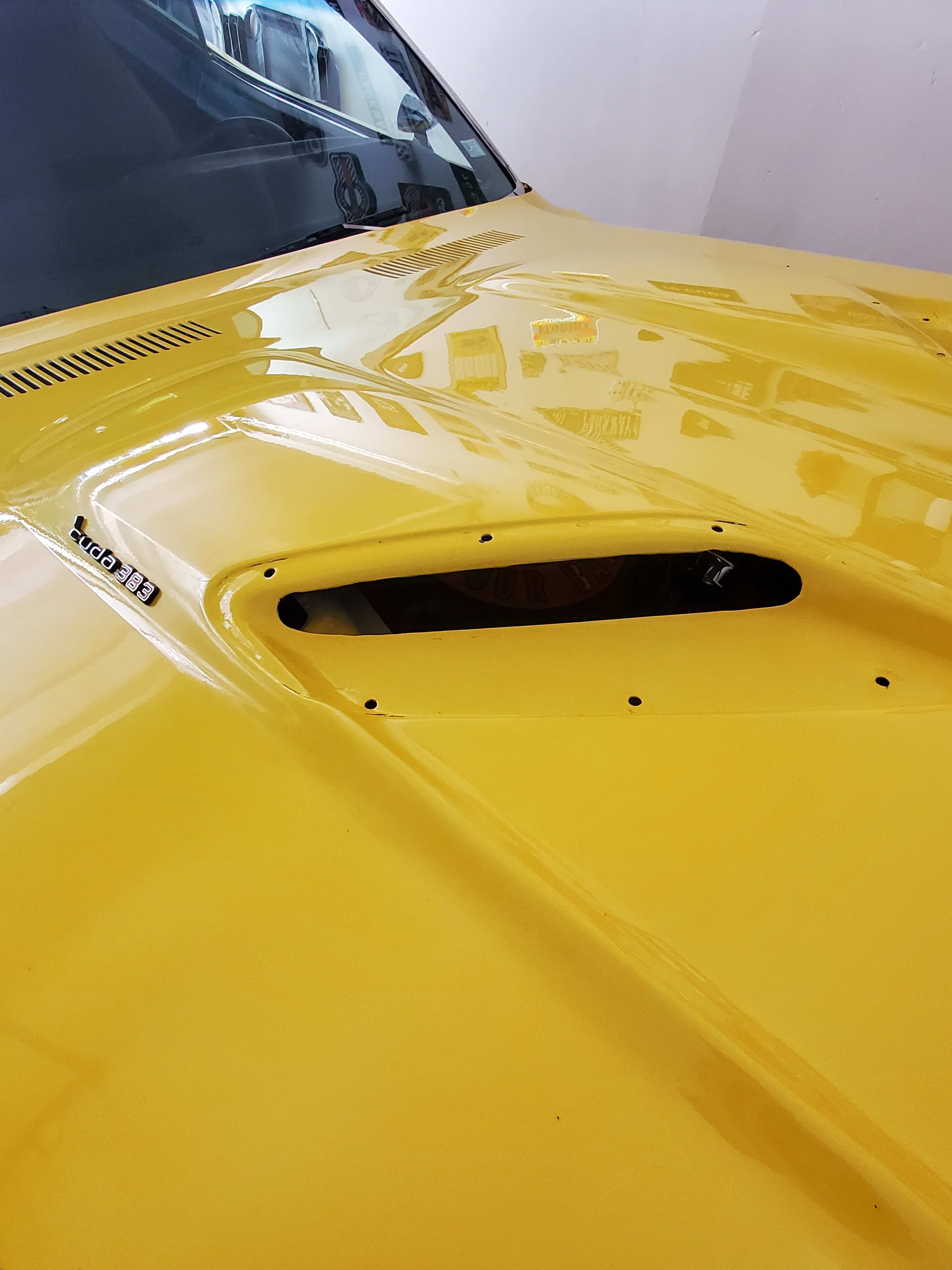

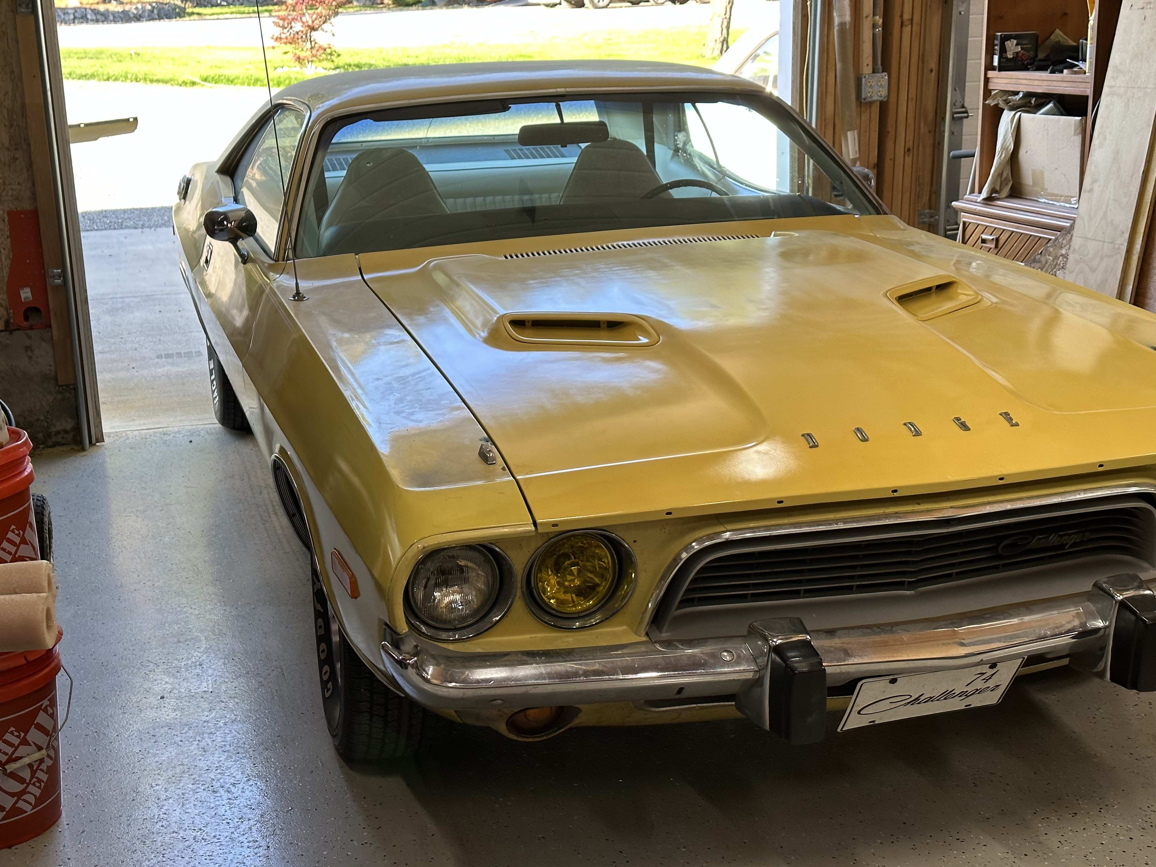

The Challenger inserts (opening) are a little smaller. I am still debating what to do with my opening - I am toying with making my own screen inserts:This is what I might be doing , painted some black mesh yellow but it might be to cheesy , flat black is probably better.View attachment 139864View attachment 139863
I love the Challenger hood , I've had a couple modern day Challenger Scat Packs and just looks awesome , I'm in the process of sanding and painting the scoops , they had some blemishes , and will be painting satin black with the mesh also to match the hockey stripe , and also going to do the go-wing .The Challenger inserts (opening) are a little smaller. I am still debating what to do with my opening - I am toying with making my own screen inserts:
The rest of the car still needs work, I am slowly making headway. I need the bulge to allow for air cleaner clearance when I added the 360;

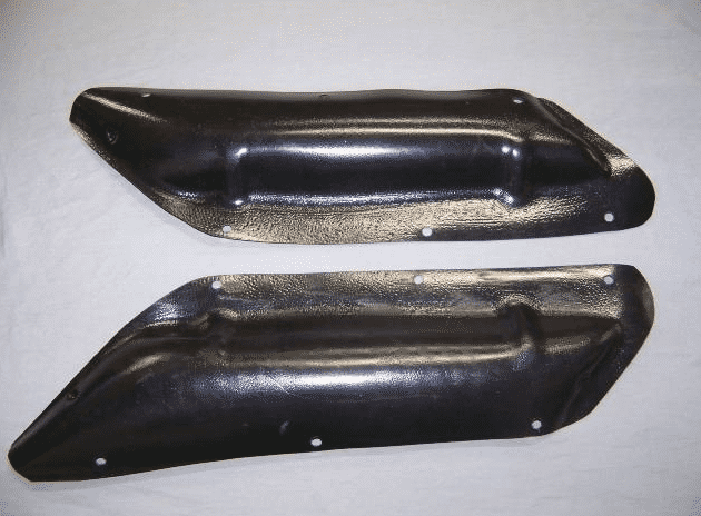

The factory black inserts are re-produced. The scoop to hood gasket is also available.The Challenger inserts (opening) are a little smaller. I am still debating what to do with my opening - I am toying with making my own screen inserts:
Who makes or where can you get the inserts?The factory black inserts are re-produced. The scoop to hood gasket is also available.
Where can you get the gasket , I like the fact the scoops are open and air can get in .The factory black inserts are re-produced. The scoop to hood gasket is also available.
My bad, I thought you were asking about a Challenger. Roseville has those gaskets and plates.Where can you get the gasket , I like the fact the scoops are open and air can get in .
My bad, I thought you were talking about a Challenger. Roseville has those gaskets and plates.Who makes or where can you get the inserts?
