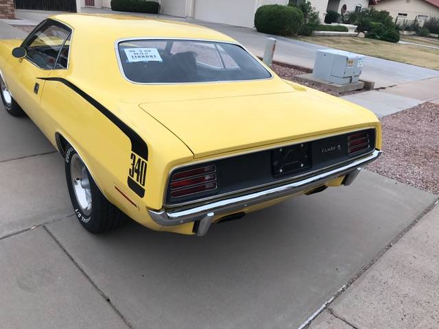

Its a 340 stroked to 416 with a tremec 5 speed 391's fresh paint, I just recently put an AAR spoiler and rear window louver..

Welcome to the site from Panama
Beautiful Cuda !
