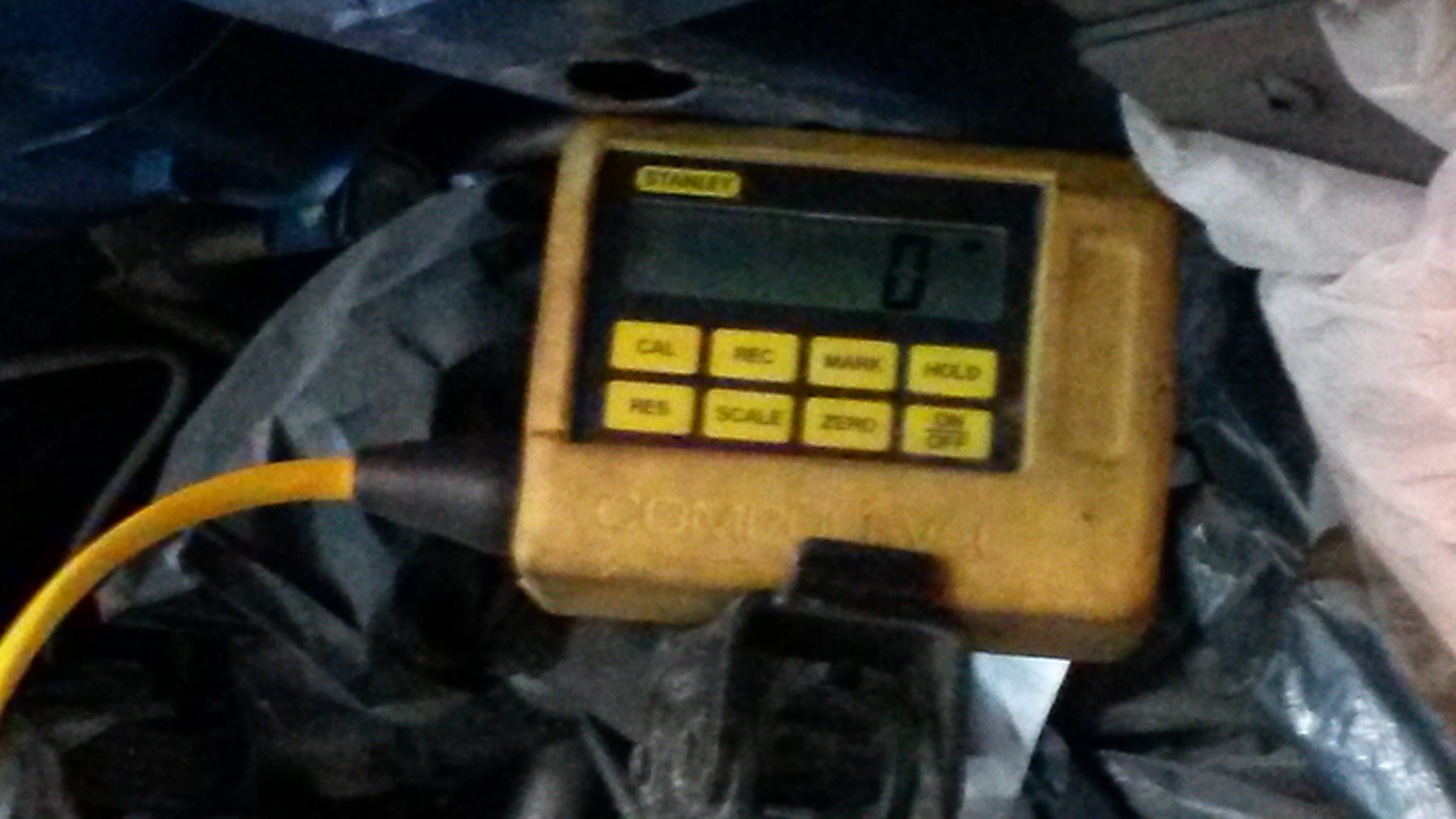

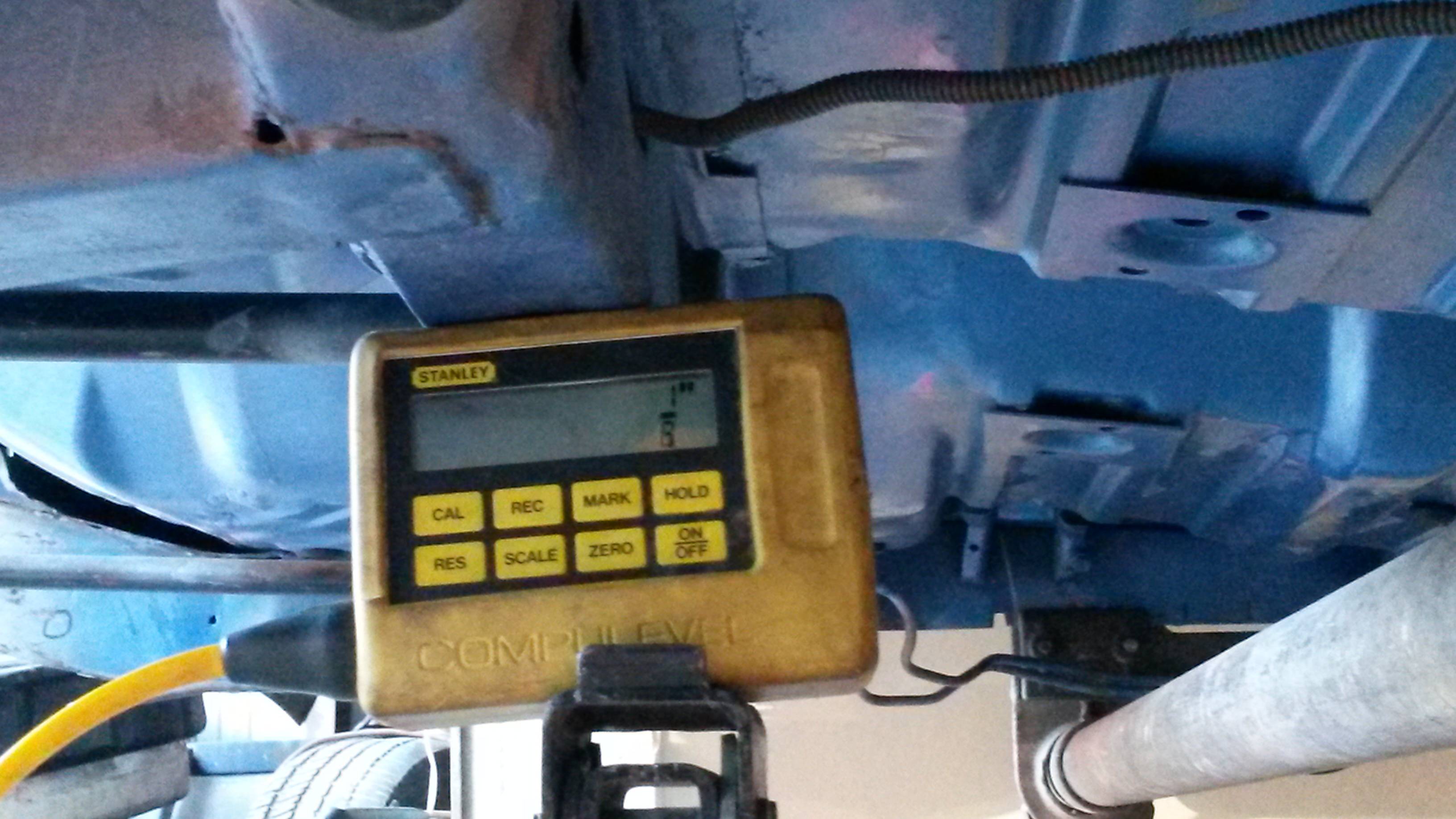

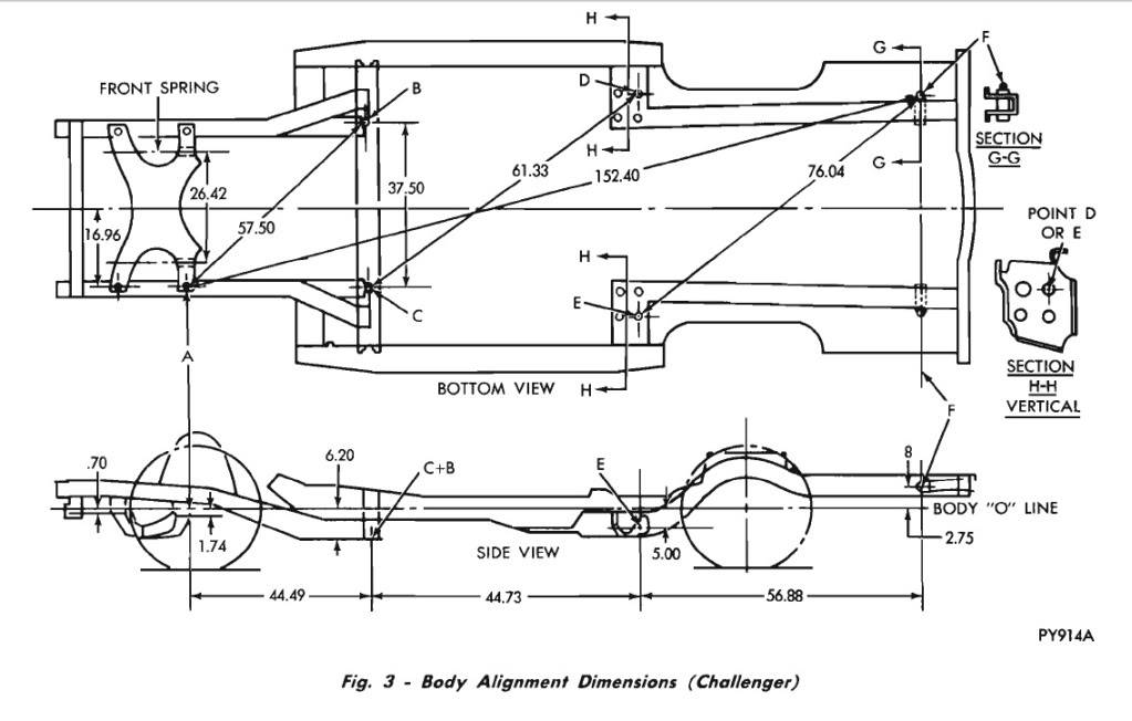

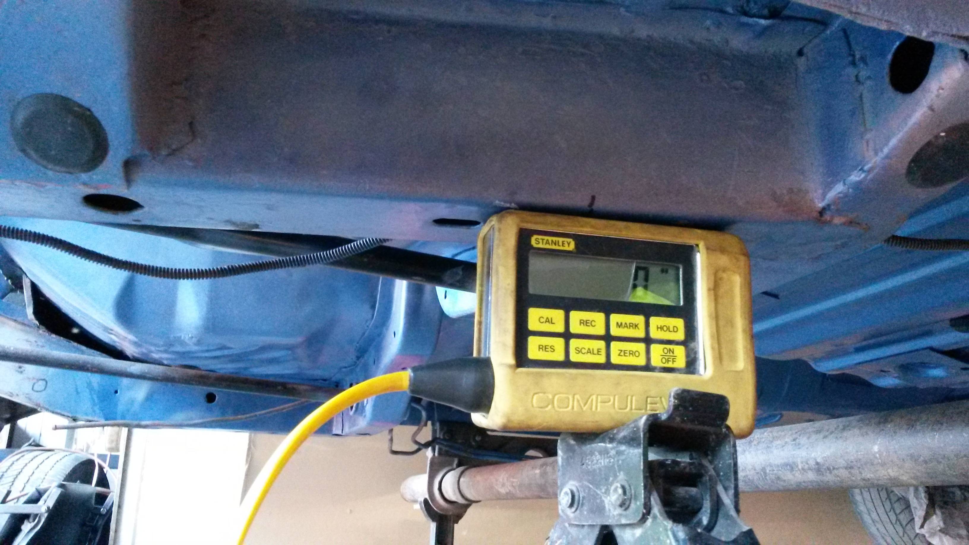

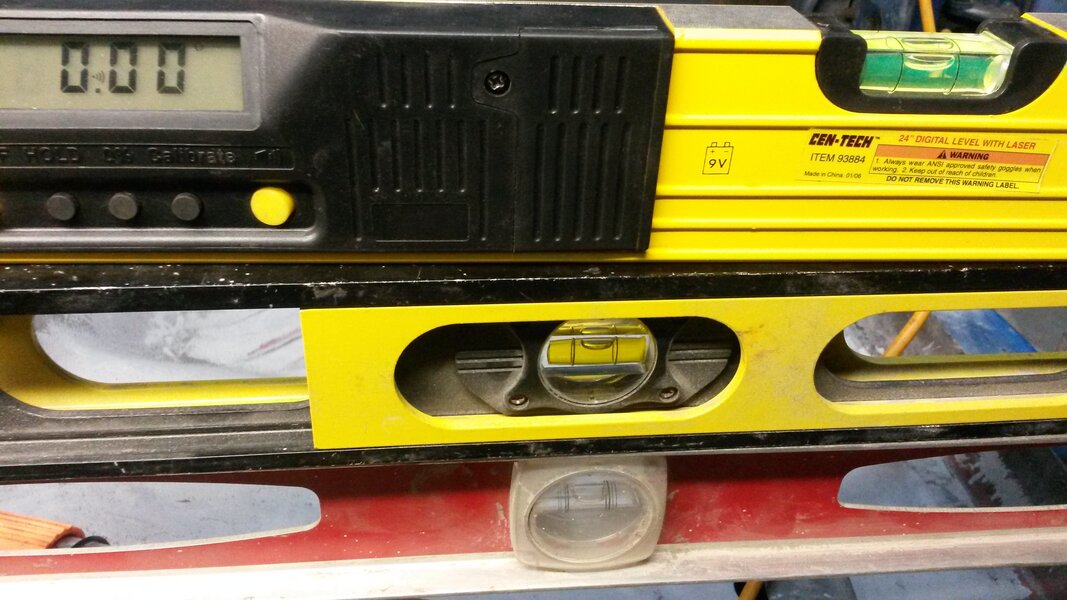

You can use a level to level the center section. 3 4' levels would help.1st across the front laterals at the control hole to be consistent. 2nd rear laterals at the control hole to be consistent. level left to right then use 3rd to level front to rear on the other levels.then recheck and support front and rear,if need be. Also check you level by turning 180. picture show a digital level I bought to use had a audio tone when level. took it back to harbor freight and got one that worked.Gravity doesn't lie. other pictures show an 1/8'' difference in torsion bar member. Or you can go off the rocker panels on top.
