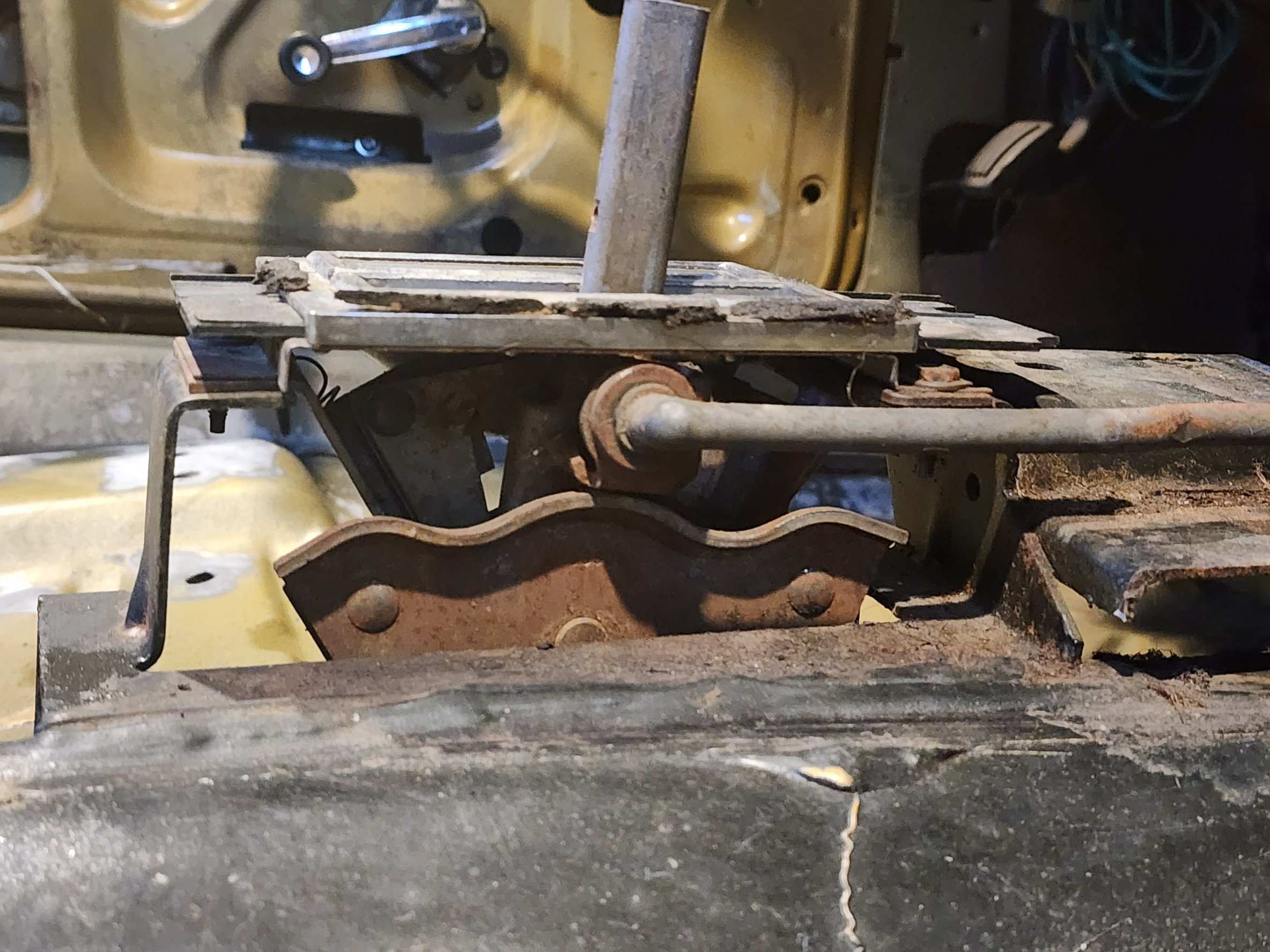

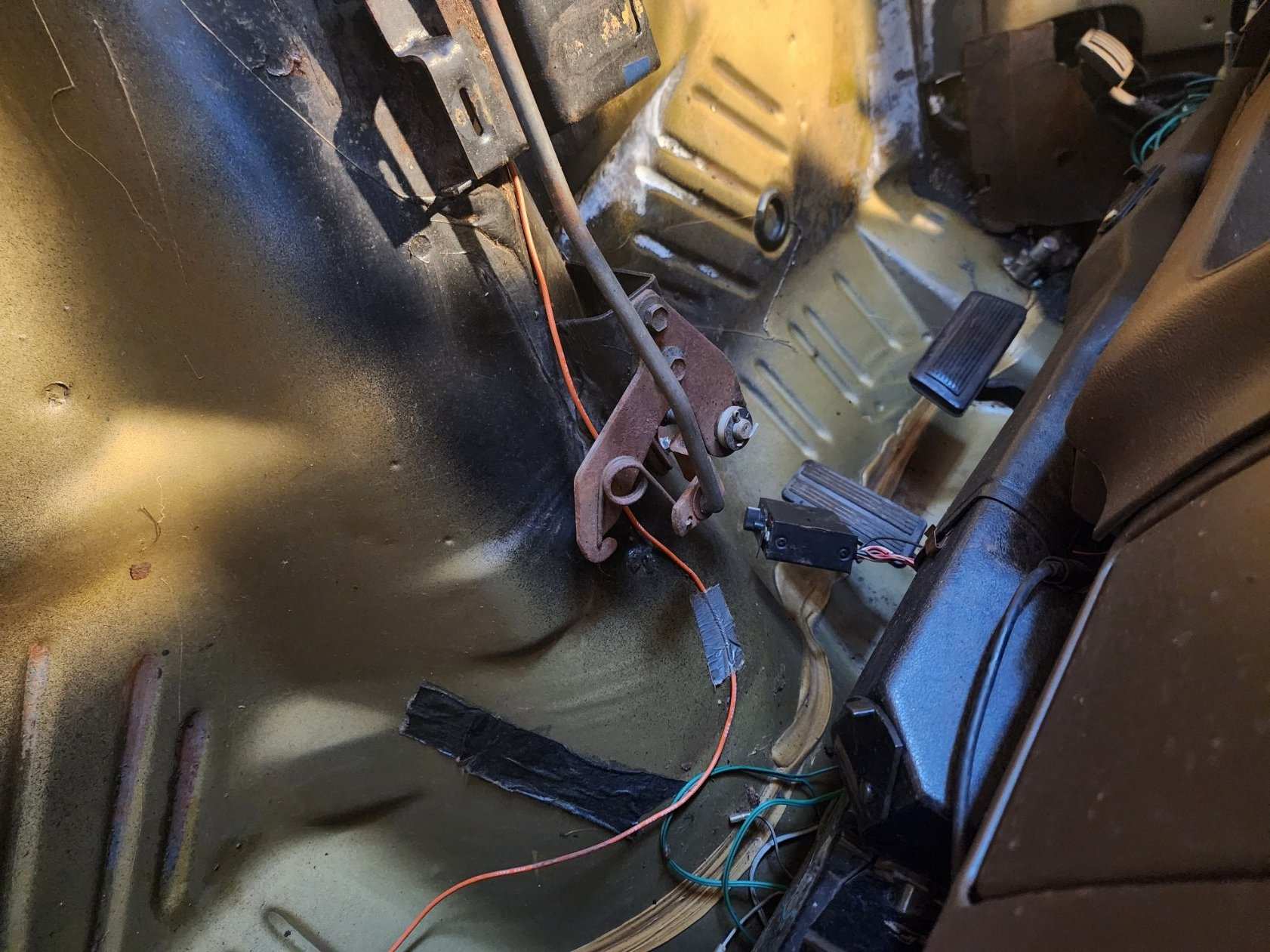

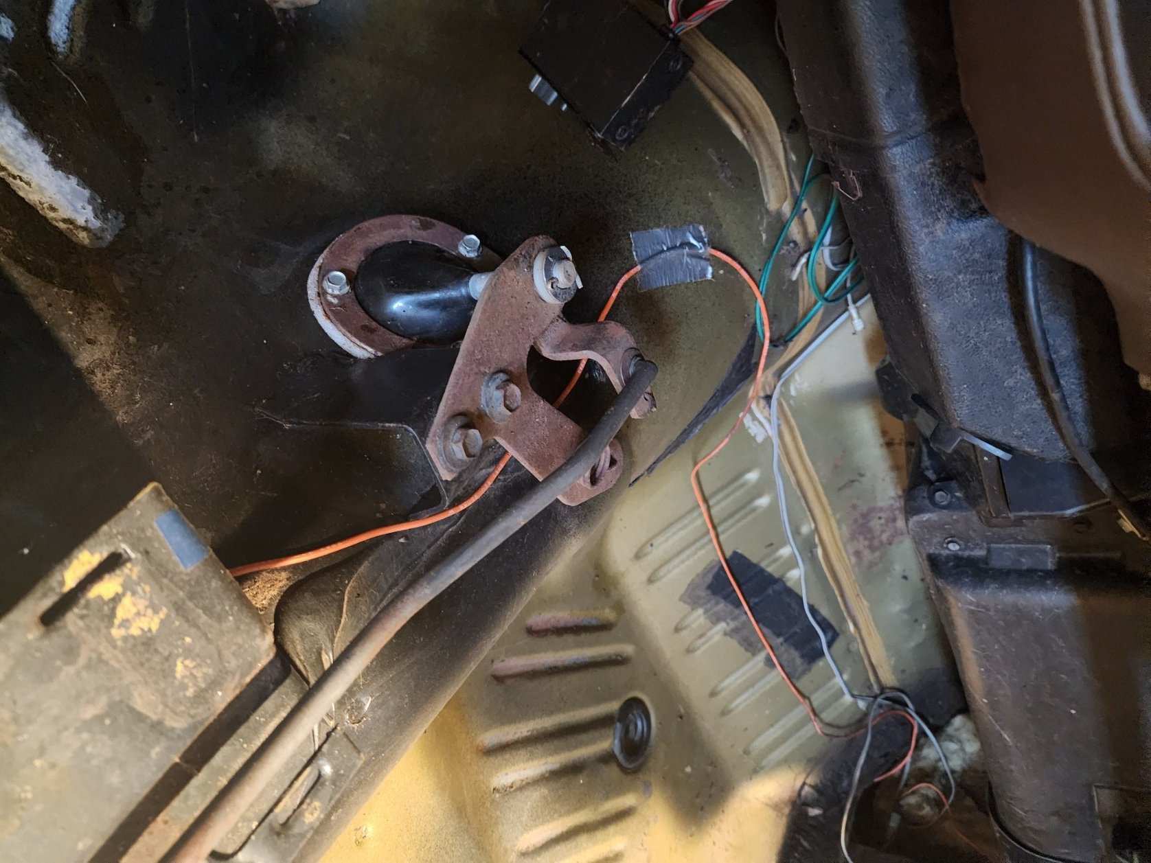

Hey guys I need some advise. I've been cleaning up rust on the floorpans of my 71 barracuda convertible using POR 15 then prime and painting it but now I have also found rust all over slapstick gear shifter mechanism. I think I can use the same POR-15 to clean up the parts but how do I seal the metal without having to paint it. I'd like to keep it looking like bare metal. Here are some pics to understand what I am talking about (not sure why the pics are sideways but you get the gist). What's the best move?

Your not going to see it. Clean rust off mechanism and paint. That's what I would. Clear coat it with a rattle can. Mechanism work better when free of debris.

if you bothers you (and it might bother me) that the rust is there, you can treat it with any of the many phosphoric acid rust removal products out there, get it clean, wash it off, and give it another 50 years to rust again. even soaking it in straight vinegar for a few days will take most of the rust off of there. if you want to got he extra mile, wipe them down afterwards with some diesel fuel or other light oil, and it may take 75 years for the rust to return. By then, your grandson will be driving it. ;)
